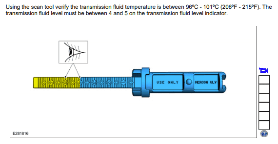

I believe you are correct @landiscarrier on the 4-5 range documentation as it is from a ranger specific procedure document. The one I pulled(attached) from fordtechmakuloco on his YouTube channel is not model specific and is not correct for all models. Thank you for uploading the ranger specific guide!
Now to buy a quart of trans fluid and add a bit. Hoping bringing mine from 5 hot to between 4-5 will help with initial cold start engagement of gears. It's just a few seconds if you crank it and immediately shift into gear on a cold start, but it feels like forever, lol.
