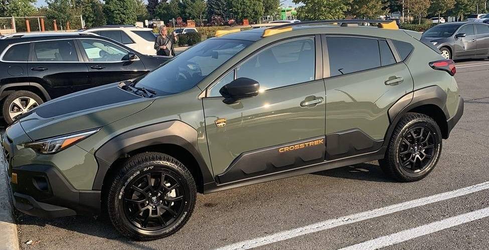

i'm not going to wait for my tranny to crash, trading it in on a Subaru Crosstrek, wish me luck and thanks for all the great help over the years, i'll miss you guys....

Hey Tom,
What colour? @HAMMERTIME , from Hamilton (I know, duh!) traded his Ranger for this Crosstrek…
Enjoy - maybe you two can start your own forum. :wink:
