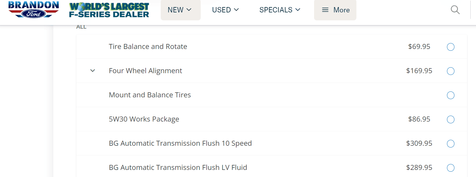

$460-600+. Make sure it's a drop and fill with filter change. Some only do fluid exchange only.
Pretty sure mine price was fluid only. And only what was in the pan.
