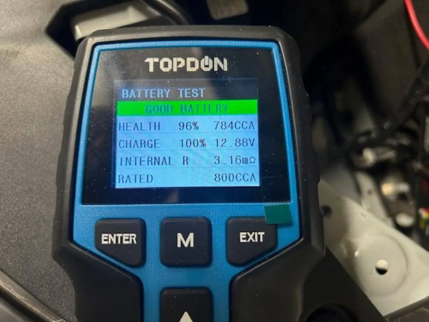

The true way to do it - disconnect battery and test
Due to (the tester is resistance) based
It is difficult to get an accurate reading due to not being able to get directly on the (pos) battery post.
So if not disconnecting, pick a hook up spot (I use the stud) right beside the post and then the (Neg) directly to the Post
You should see results close to this with the TopDon using these connections
I was so surprised by the need to be on the post with this tester.
Thanks to all of you, I removed the clamp from the positive post and was able to see that the battery was in great shape as compared to my first reading taken near the post.
