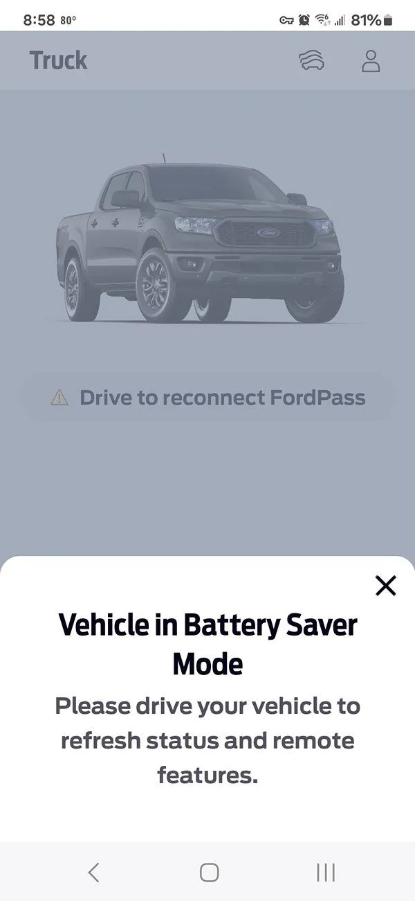

Am I in trouble? I drive about 25 miles a day, 5 days a week, but I've been getting this alert some this week:
137,217
Sounds like it's on its way out. Swing by an Autozone and have them test it, it's free there. With the record heat these last 2 years I'm sure it's taken a toll on your battery.

Figures! I would just buy that one because it's most likely on its way out. The heat there is a battery killer and my Tacoma battery only lasted 2 years and my 19 Ranger 18 months. Hopefully this one will last longer seeing as I only had it there for 1 year and it was always on a maintainer.

I usually get that message when my truck sits for 2 weeks even on the battery tender.

I second the battery tender recommendation. I use it 1-2/x month on my Ranger to top off the battery. I also used Forscan to up the charging percent from 75% to 80%. I should go back and increase that to 90%. (Lariats are set stock at 75% from Ford, instead of 70%).
I get the Fordpass warning every now and then (once a month, give or take). My truck is 3.5 years old, 44k miles, driven in central Oregon (no extreme heat or humidity). The warning message is usually my reminder to plug in the battery tender.
The dealer also tests my battery when I have oil changes. So far it has tested good.

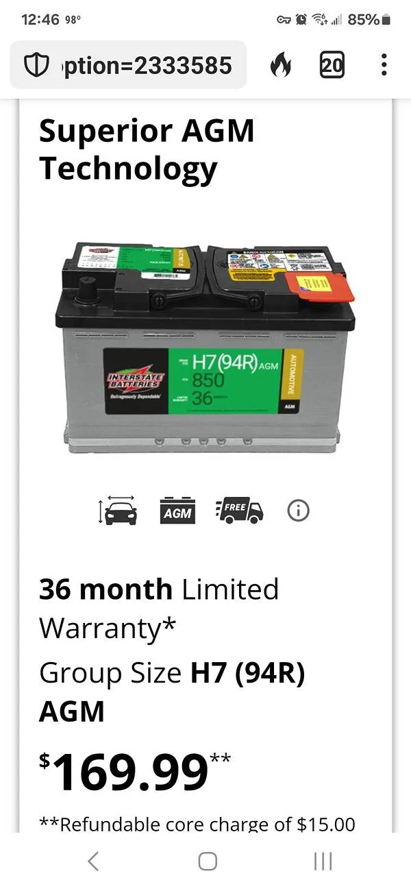

Does this look right?
Also, not that I've never changed a battery before, but I have not changed one in my Ranger before. Is there anything special I should or should not do when it come time to swap that will keep me from turning the truck into a brick?

Does your truck take the H7 size? Some use the H6 size that is somewhat smaller in size. Your battery cover may not fit if yours uses the H6 size and you put a H7 size in. Other than that, you can use the H7.
