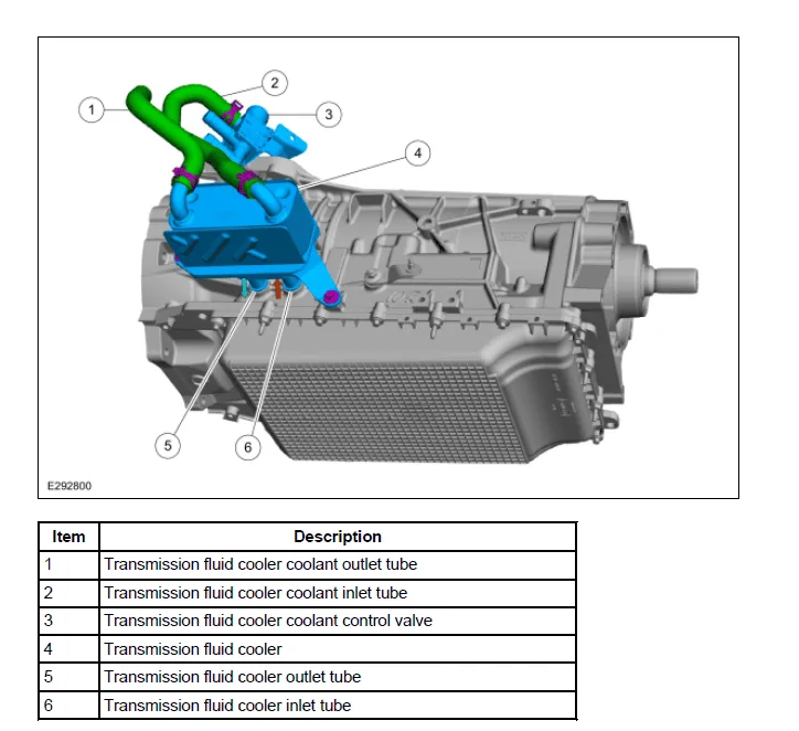

The radiator may help with Engine Coolant Temps, but unfortunately not with the Transmission and this is due to the design of the Ranger. Unlike most vehicles out there that have the Transmission Cooler Built-in to the Radiator, the Ranger has a Cooler/Warmer on the side of the Transmission that has Engine Coolant come to it. It also has a Electronic Controlled Valve that I believe is controlled by the PCM to regulate how much Coolant is or isn't flowing through.
Funny I was just reading a post you made about your Nissan, I understand this but my angle is to see if adding a better cooling radiator and if I can figure out how to get to the programing so it opens up more and cools the trans when towing. Does this make sense ?
Funny enough, I knew the Ranger had that side mounted heat exchanger but thought it plumbed out to the radiator too. I guess maybe that was only in the F150 extreme tow package?
I just accepted the trans temps the Ranger runs at. Our 2016 Honda Pilot 9spd towing the same trailer never exceeded 210F or so and often was around 180F without a load. Considering my 10r80 will break 200F around town without a load, Ford clearly wants them running at these temps.
