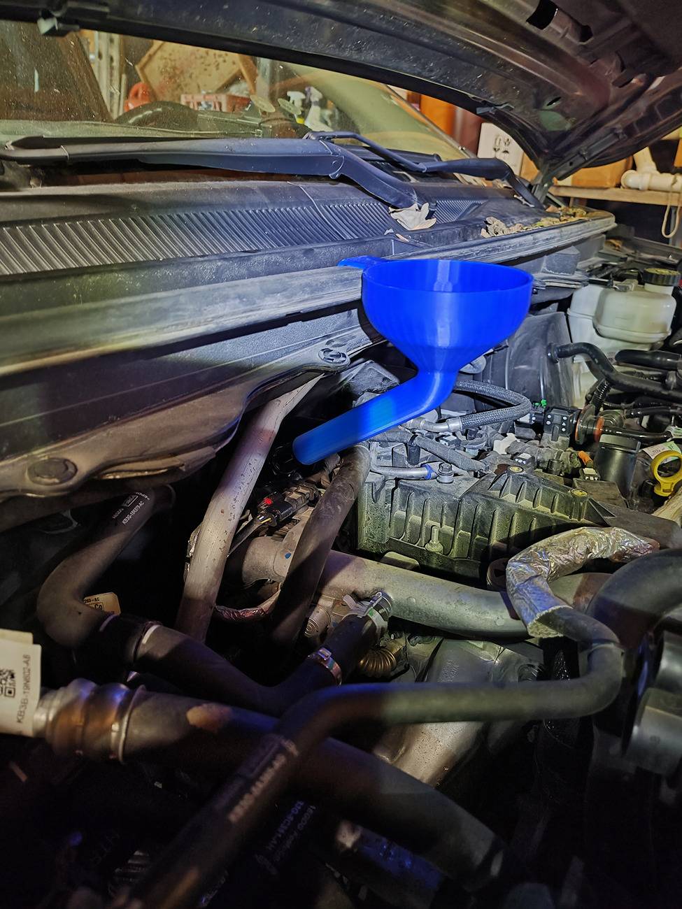

Mike, here's some input you may appreciate: Your stick and funnel are great. They make an essentially unserviceable transmission serviceable.
The fit up of the stick and funnel is perfect. I don't know if you did the modeling for the funnel, but it is exact. I'm a short guy and have to climb over the engine to fill the transmission. Much better than any other funnels I have.

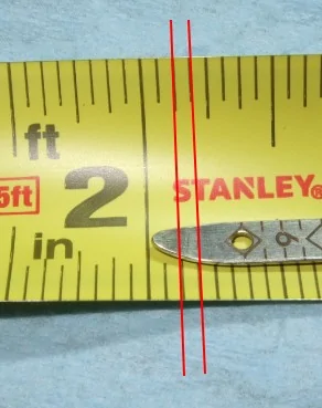

Start up your truck on level ground, run it through the gears from park to sport and back to park at 5 second intervals. Immediately check the fluid level. If it is showing on the Fitzstick dipstick no higher than 3/16" you are good. See picture below.
I set my level at the middle of the diamond between 4 and 5 at 215F. Then I let the truck sit overnight. Ran through the process above and checked the level. If your level is between the red lines in the image below the fluid level will be dead center between 4 and 5 at 215F.
It is easier to see the fluid when cold. It doesn't get any easier than this to check your fluid levels.
This works for me.
I'm looking for folks to please validate my process.
