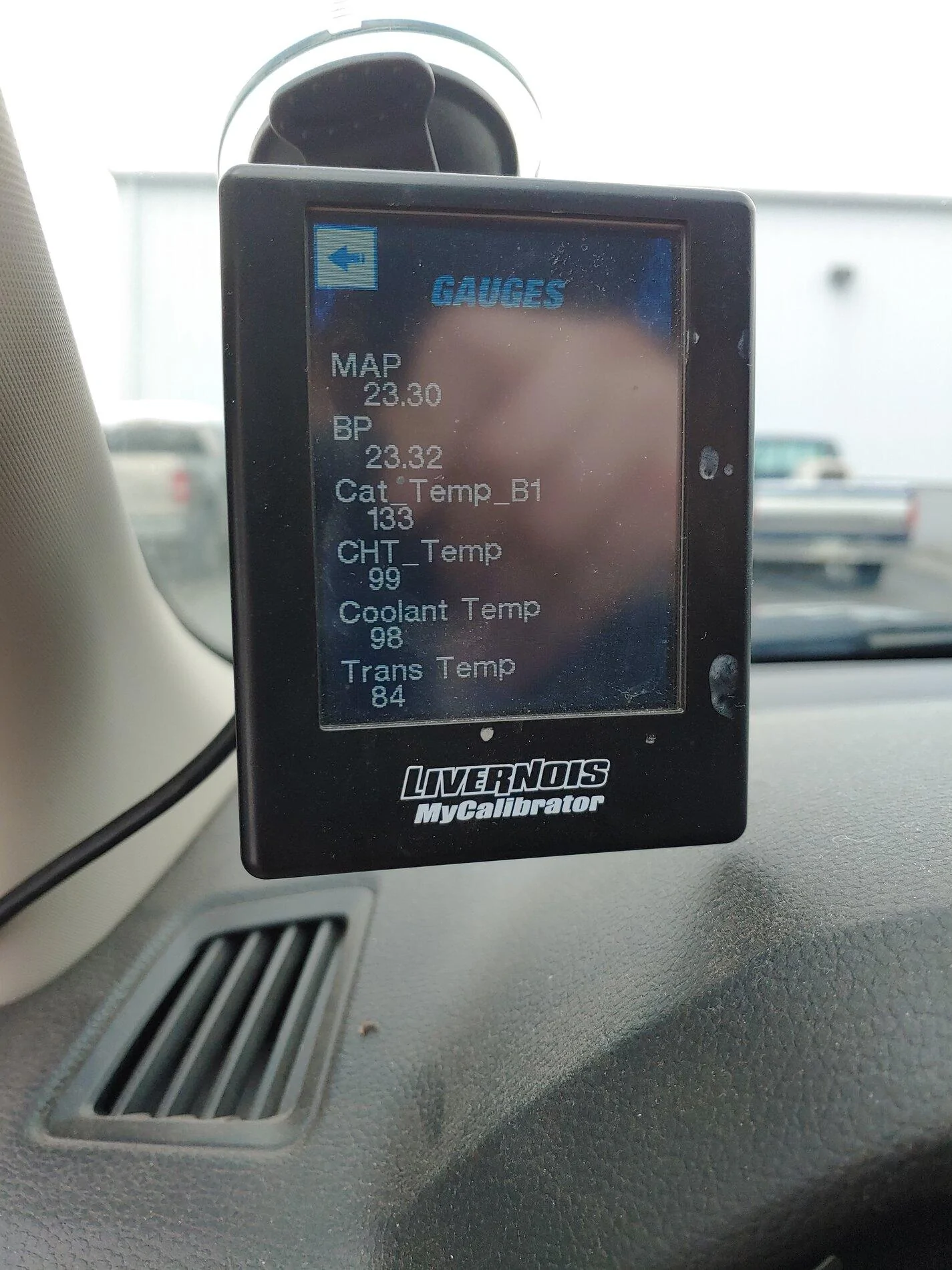

I use the my touch calibrator from Livernois to monitor transmission temps. I also monitor coolant temp, cylinder head temp, catalytic converter temp and MAP pressure with barometric pressure for boost calculations.
Specially, which PID is it. I would love to monitor the transmission temp as well with MyCal. I can’t find a PID on it that looks like it would be transmission temp.
Go to Trans then scroll down(touch and drag up) and you will find Trans Temp

Maybe this will help for what you are looking for exactly. They will be listed just like this.
137,222
On mine there's nothing that says Trans Temp or Coolant Temp there are only 3 letter abbreviations?
That is weird. Do you recently get a firmware update or something? I haven't had an update put on mine in a little while so I don't know if that might have something to do with it or not.

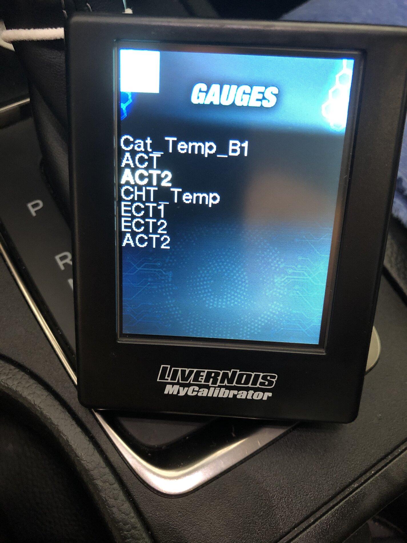

137,222
No updates. I just went back out and took a pic. I did find the coolant temp but here's what the temp looks like. Which one would be trans temp?

Okay I got you now. Check other sections for data. I can't remember exactly where I went to get the coolant temp reading. I already see the cylinder head temp and the bank 1 Catalyst temp. I think it was in a different section that I found the others I just can't remember where right off. For transmission it was in the transmission section and you have to scroll down. In order to scroll down and you have to touch and drag up. Be careful though it's a pain in the ass and it likes to automatically select a different. When you're trying to drag up.
137,222
That was it! It said tap down but it doesn't go down far enough and I didn't think the hold and drag it. Once I did the Trans Temp was at the bottom. Thx!
