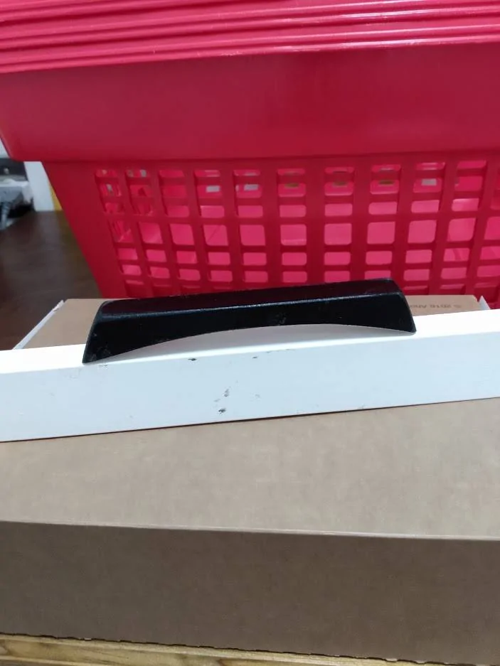

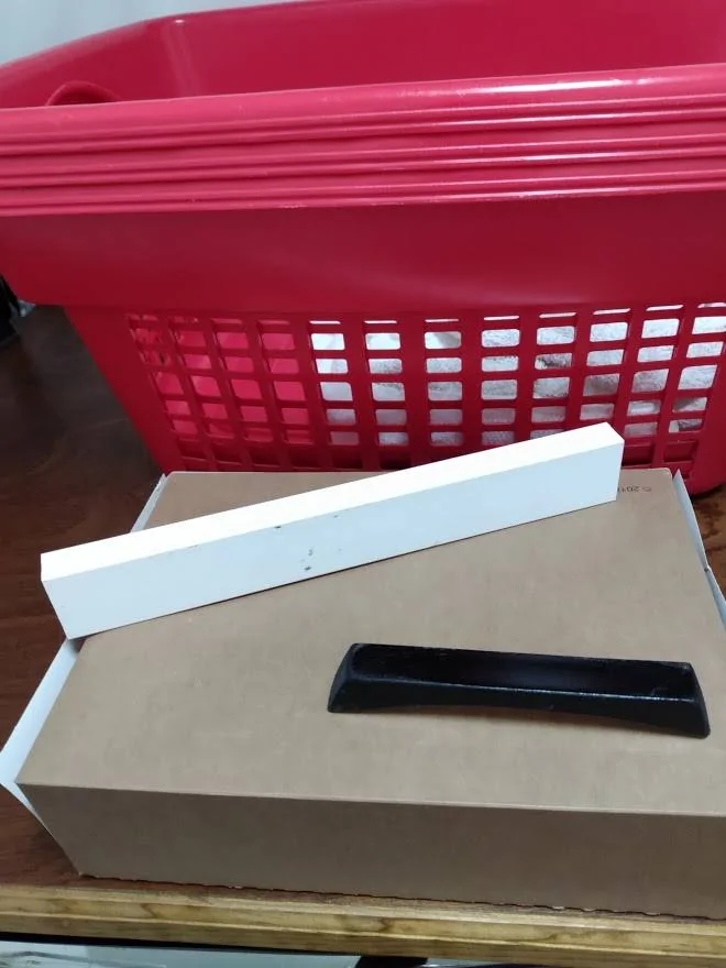

I'm just finishing up making a small mount that will let me mount it on the steering column just behind the steering wheel. Used a small piece of pvc trim that I had lying around, shaped it to fit the curve of the column with a flat on top to velcro the gauge to.
White piece is the pvc trim....black piece is what I trimmed it too...curve matches the top of steering column. Nother coat of paint and I'll mount it.
Sits low enough that it dosen't block dash gauges.

Nice! Yeah in the Vegas heat I have issues with it sticking how I have it mounted. What your doing looks solid though.
5,914
29,476
Heavy duty velcro to attach it to column, same to mount gauge to it.
Send you a pic when I'm done.
