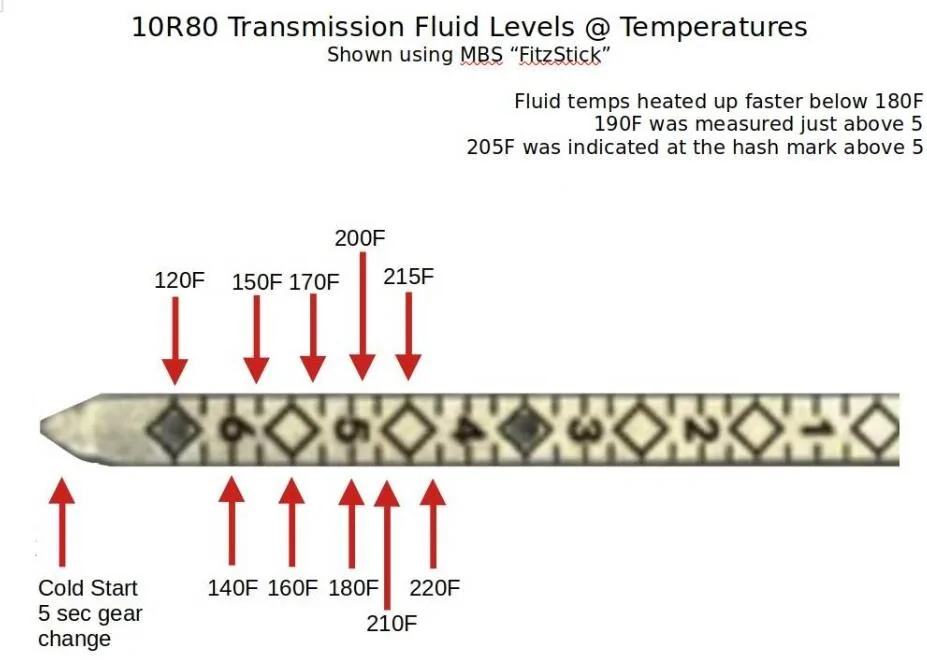

You are correct but I am not sure how much 10 degrees makes a difference
It makes a difference when reading the fluid level on the dipstick. Overfilling is just as bad as underfilling. Overfilling will result in foaming which increases wear and causes excessive heat.
The chart below is where the fluid level will be on the dipstick when filled at the diamond between 4&5 at 215F. Basically each reading at its respective temperature ( red arrow) is identical to the fluid level at 215F.

One last thought. At 230F you are at the top of the Ford recommended range with the fill level in the center of the range while at the top of Ford recommended temp window.
IOW, I filled to the middle of the fluid level range at the top of the temp range (intentionally filled a little on the low side (but well within the Ford Spec) to insure no foaming of the fluid at temps at or above 230F. If I had filled to the 4 level I have no doubt that when fluid temps exceeds 220F foaming would result.
I know this because I did just that and had foaming. The Mercon ULV expands considerably as temps rise. This is precisely why I want temps below 200F. I traveled up I-81 through the PA mountains doing 70 mph at night in 50F cool weather. Stopped for fuel and felt my transmission buck right as I stopped... transmission didn't disengage for a second or two.
Changed the fluid and lowered the level slightly, and added LubeGard Platinum. Drove the same 650 mile route a week later uneventful. The 10R80 are delicate, and care needs to be taken when servicing them. I change the fluid every 20K miles.
FWIW I began having Transmission troubles at 5K miles, By 18K the truck was parked until I figured out what was going on (with the aid of 2 folks on this forum). I am at 27K and truck is symptom free the last 9K miles.

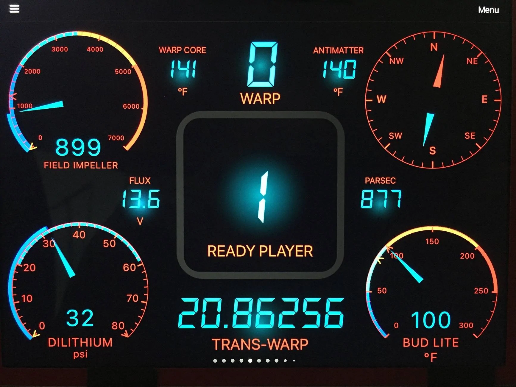

Yes, but who else has a "Butt Lite" temp gauge?
Ooww nooo, yer dilithium crystals are needin regeneratin!
And I wouldn't be drinking that beer yet either, beer RSDT (recommended safe drinking temperature) should be around 39F or 4.0C, then again I probably wouldn't be drinking Bud Lite anyway.
