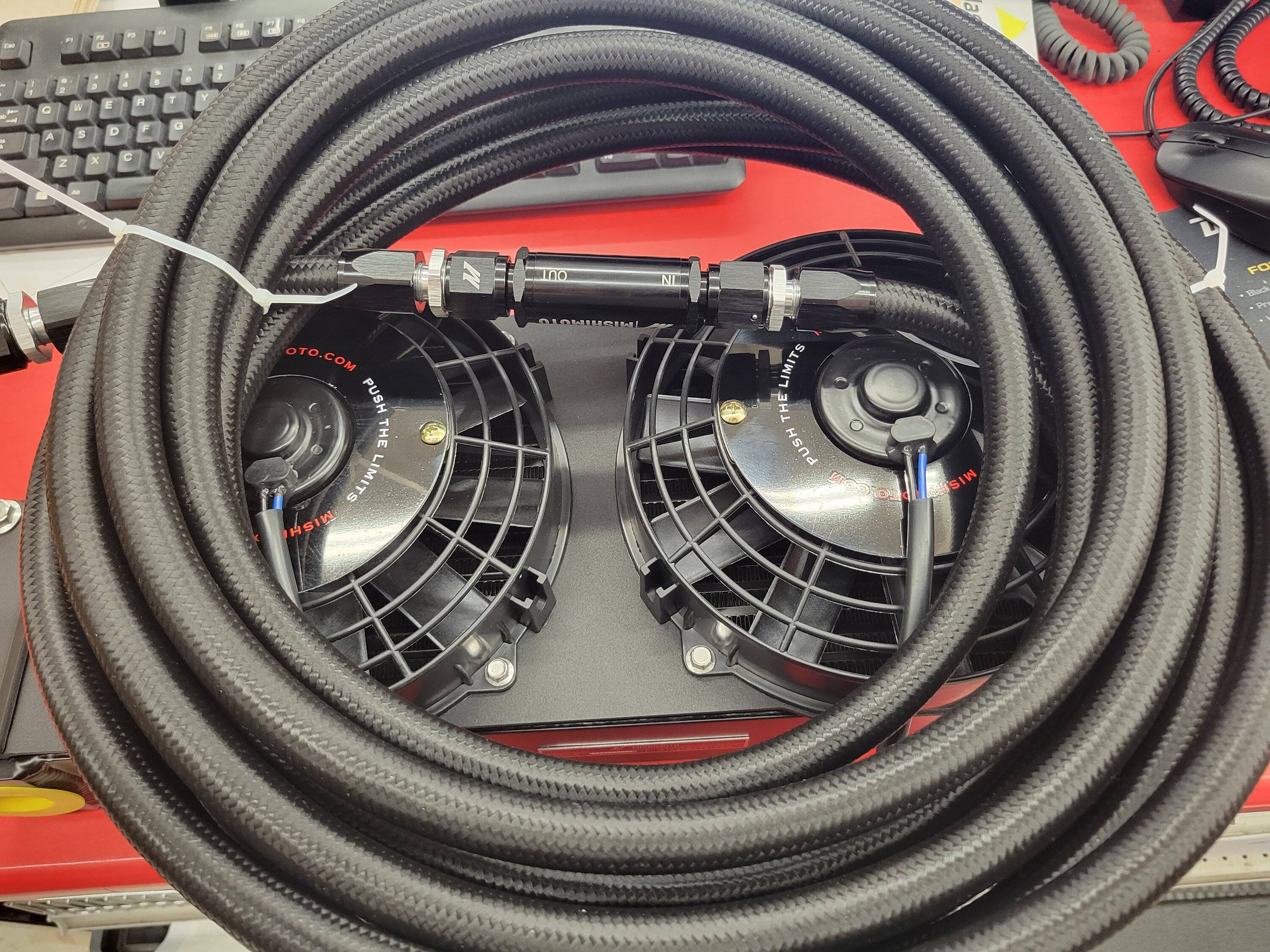

I'm starting time trials on a rally track in January so I think adding (not substituting) the mishi cooler would be the way to go for me so I can turn it on when continuously flooring it off-road.
I watched an install vid of the mishi cooler on a ram I'll look for it and post it.
As far as actually watching the trans temps I haven't yet I'm almost certain I'm going with a 5 star tune so that I can add the downpipe. Anyway I like having the stock cooler and the additional cooler are there any threads of the additional cooler on a ute?
One thing I like about the cooler for these 6 and 10 speed transmissions is that it isn't in the bottom radiator tank. Must be cheaper for Ford to only have to make one radiator instead of 2, and the in- radiator ones seem to be plagued with internal leaks as well.
However I have often wondered from an engineering point of view, putting an air cooler in front of the radiator, does that just simply dump a proportion of the heat straight back into the coolant anyway?

I would want to talk to a 10R80 expert before you go messing with the cooling of this transmission.
There's a reason they want it to come up to temperature quickly and it is probably not all related to fuel economy. With 6 shift solenoids and 6 clutches it has some pretty nifty gymnastics it has to go through for the 10 speeds. I would want to know that over-cooling it wasn't going to cause shift timing issues since the fluid would be slightly thicker than what the TCM is expecting.
I would also want to know what the additional pressure drop from going through an additional cooler is going to do
Might not be a problem at all, but I'd want to know the answers before I started sticking additional coolers inline with the factory one.

Any updates? I'm adding a remote cooler to my 2020 ranger and figured I would check for any updates

There really isn't a way to add a remote cooler for the transmission at this time. The best you can do is replace the transmission pan with one from PPE. It will have radiant fins that will help with cooling. Other than that there isn't anything available at this time

Na man I'm building an f150 race truck right now until next year my truck is just to go to work until then lol. I will need one eventually for prerunning but someone else is going to add it first. Definitely is a must need for running the truck hard in the heat.
Guess I will be letting you know how it goes. Only thing I haven't figured out is warming in colder temps.
