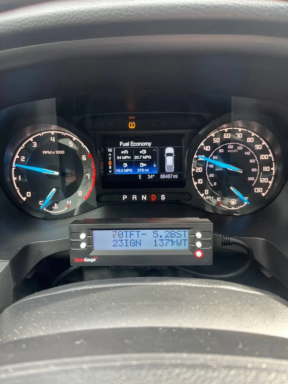

I have already ordered the Lubeguard I guess what freaked me out was seeing the temp spike to 230 since I installed the Scan Gauge 3 and googling what the trans should run at.

For what it's worth the PPE standard pan is still a good idea since it also gives you the drain plug to make servicing much easier. Will the fins help with cooling? To an extent they will. If anything it's going to help stabilize the temperatures a little bit more.
As for getting up to 230° F I wouldn't be too concerned. You did it while going up a hill and I'm sure it came right back down after you got to flat ground or started going downhill. This is normal transmission behavior especially when towing.
Once I seen the temps I was hitting I started driving much more conservative staying around 60 to 55 and just for reference I live near Houston so it is pretty well flat land. with a few overpasses. To e in my engineering brain temps should be controlled better as FMC should expect towing in warmer weather down south. And the trailer is no where near it max tow rate at its weight.
Also keep in mind that the owners manual states to keep the speed at or below 65 MPH when towing. If you were going much faster then it makes sense. Also doing stop and go type traffic will do the same.

Regardless what speed you are going, when going up a hill it is expected to have your transmission temps go up. This doesn't matter if you have a trailer on your vehicle or not. It is normal and you will be okay
