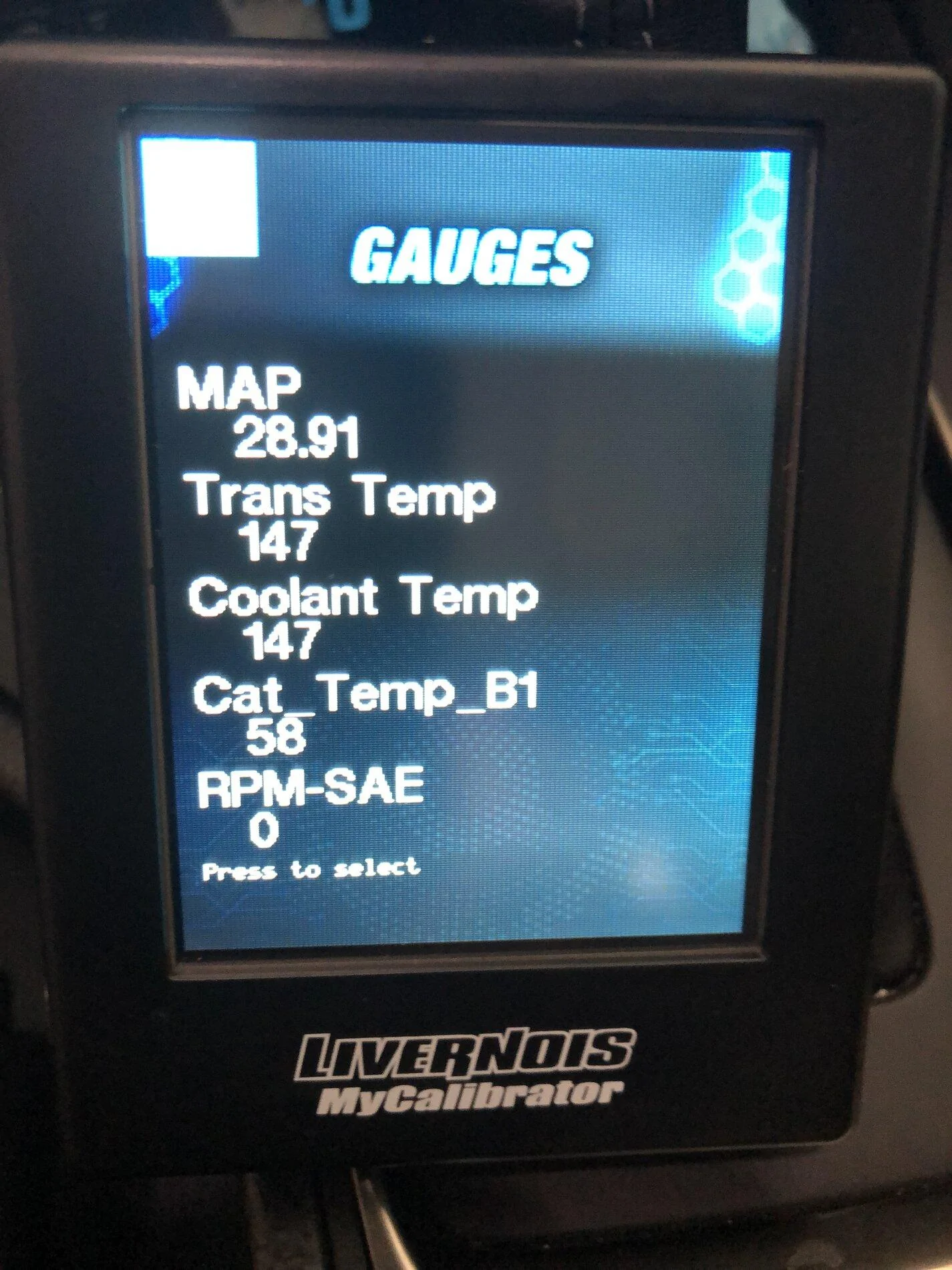

Keep in mind the trans is cooled by engine coolant, so it will be relatively close to engine temp depending on the situation obviously.
Also catalyst temp is a fake/calculated temperature. There is not a temp sensor in the exhaust. So there is no reason to monitor it, other than funsies.

That was it! It said tap down but it doesn't go down far enough and I didn't think the hold and drag it. Once I did the Trans Temp was at the bottom. Thx!
As a personal suggestion I would have coolant temp and cylinder head temp as well. The reason being is it helps you know if there's going to be a problem real quick or not when you're out on the trail or even anywhere in the United States. Simply put let's say you have a coolant leak and your coolant temperature doesn't want to go up as much but the cylinder head temp is still going up and therefore there's a huge difference. You can pick that up quickly and shut the truck down before it causes any major damage.

Off road and towing yes it will be relatively close. Granted this last weekend I did get the transmission just about to 240°F(crazy yes but it happened) and coolant temp was closer to 220°F. No load on the road it is usually close if not a little lower.
As for the EGT, it may be calculated but it is better than nothing.
137,189
Thanks again....I just changed it all around and added it. I love this tune but it would be nice if there were so sort of guide for the tuner. It seems like there's a lot you can do with it but no manual on how to do it or what everything means. Now I just need to figure out what number to change the tire size.
