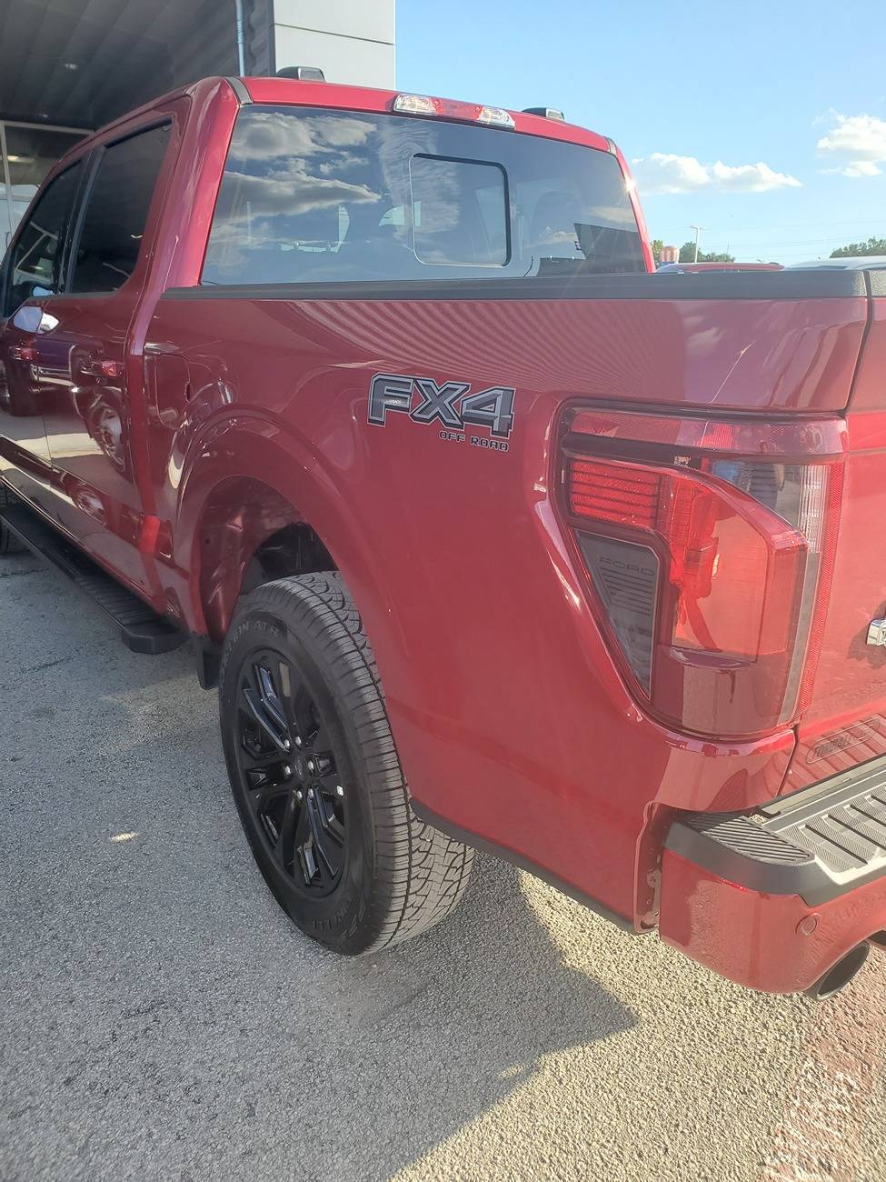

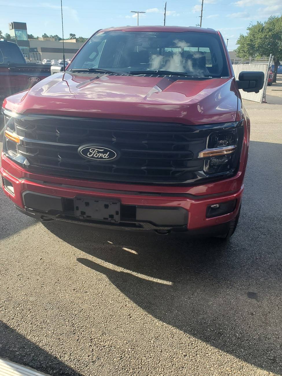

I have had a F150 to a 2013 I loved it but the wife hated it it was quite a bit taller than my ranger even with my 3.5 lift and 33 inch tires

Well I sold it but I still am a Ford guy.
