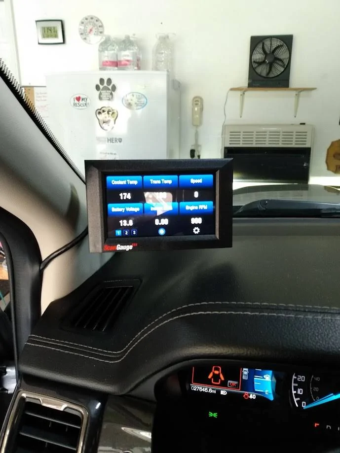

If I had a temp gauge I’m sure I would be panicking over the temps I’ve probably hit after towing in the middle of summer lol. I’m wanting to get one of the plug in gauges that has the app where you can see all the temps.
I’m at 91k. I would be lying if I said I wasn’t nervous about the transmission lol.
I am using the Scan Gauge 3 well worth the cost and simple to install basically plug and play.

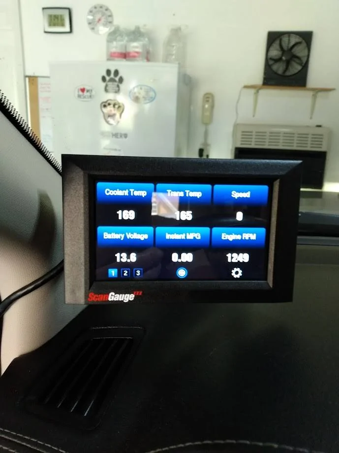

C’mon Tripod. You had to show that yours is bigger? Mine has a charming personality.
Yes, but who else has a "Butt Lite" temp gauge?

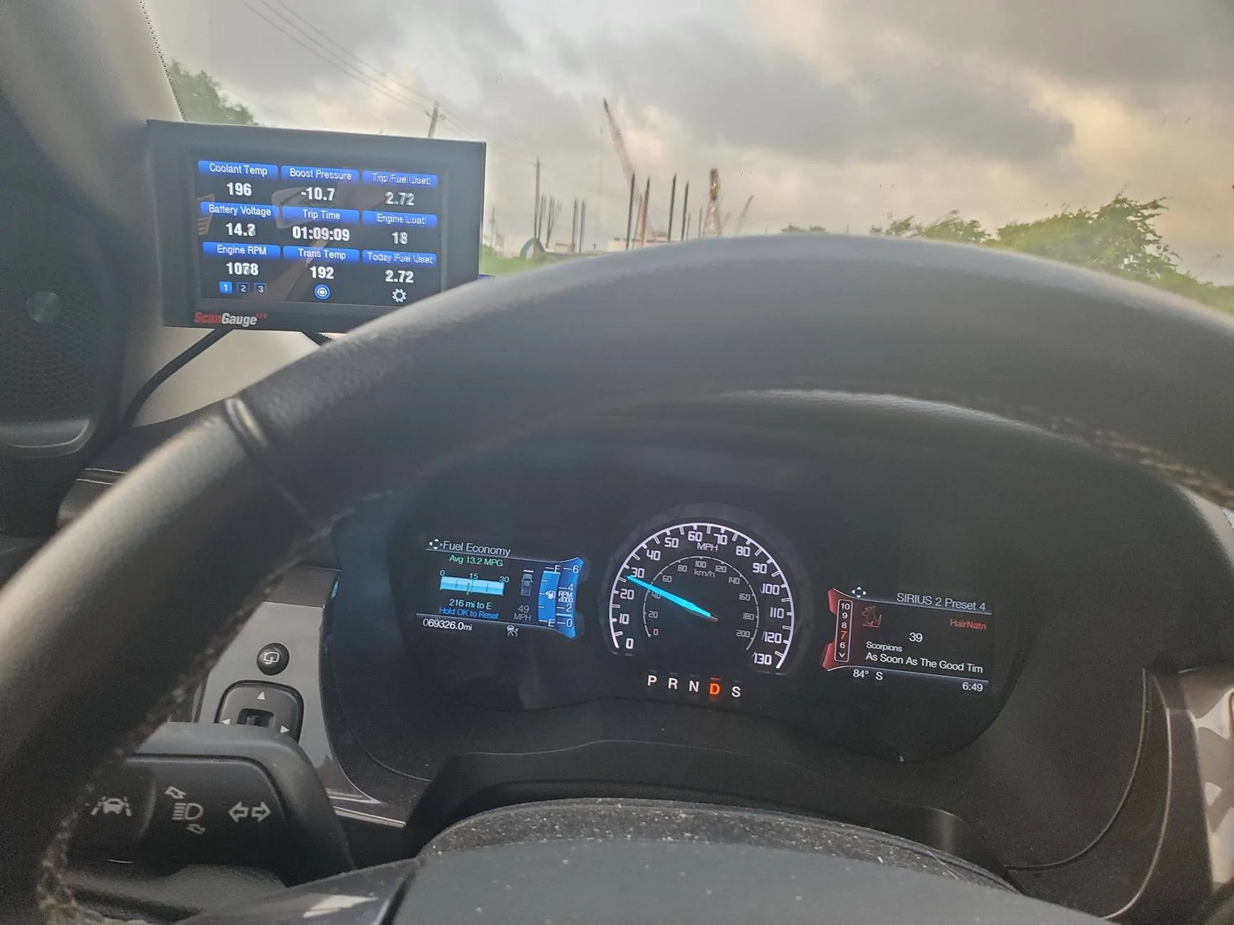

Well I did do a little bit of data logging so to speak. Now the ambient temp was a full 10 degrees less and I was not pulling but the speeds were the same in a 62 mile loop I never seen a temp over 192 and Coolant temps never made it above 201 and when they did they quickly dropped back down to around 198 to 196. I will be taking a trip to camp in the next couple of weeks and see how that goes.

Your temps seem normal. Shoot, I have even seen 215-220F in stop n go in the Vegas summer 110F outside with just me in the truck, not towing.
Towing I usually am between 220-235F with a Geo Pro 19BH travel trailer. Only once did I see 260F and that was climbing a VERY steep hill going up a mountain in Utah for about a mile, pulled over after the climb and let it idle, temps dropped quick enough. Also, no overheating light came on either, I was just concerned.
