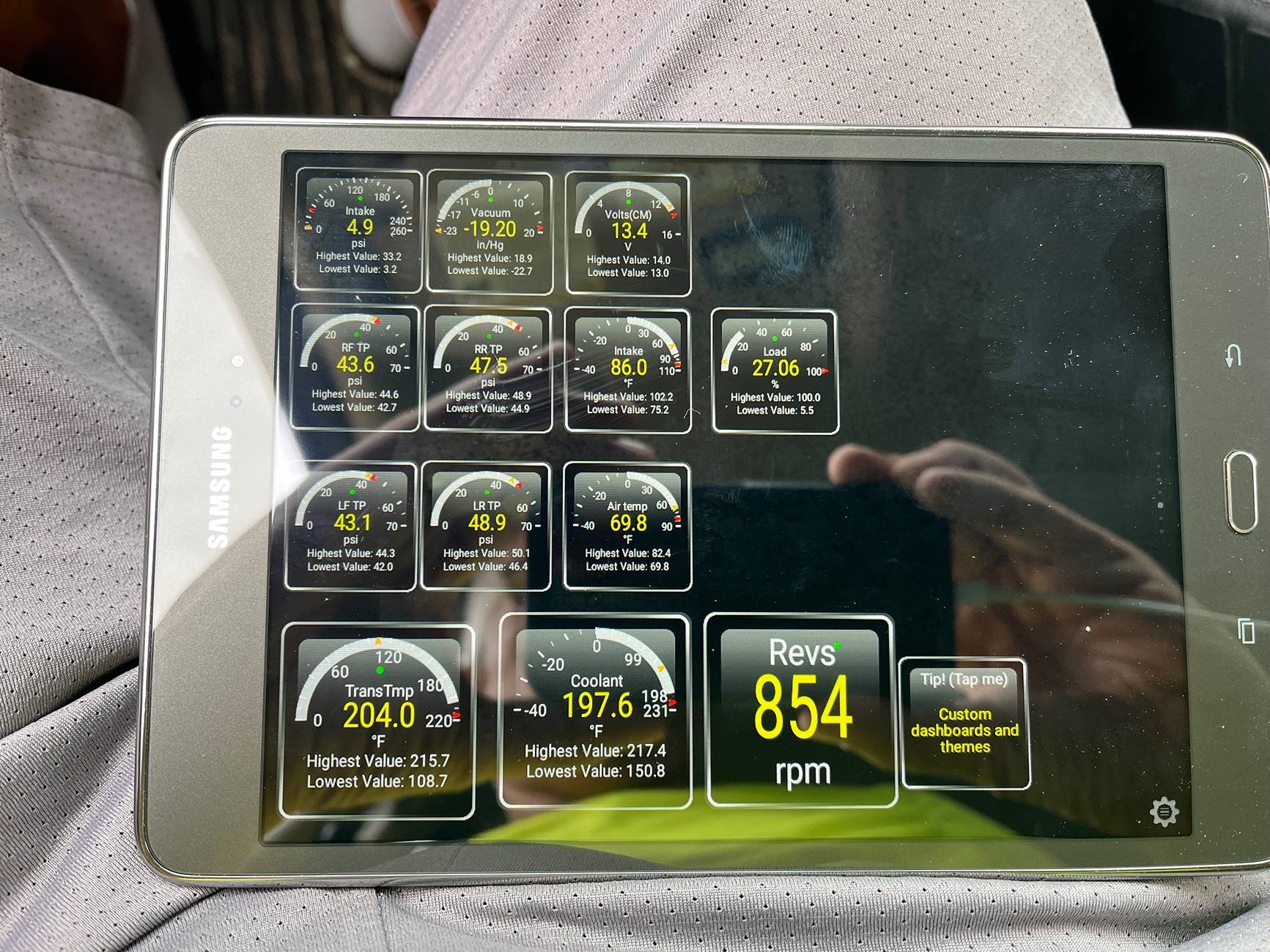

Here’s a torque pro app screenshot at the end of a recent 70 mile tow with our 6000 lb travel trailer. A few hills and around the low 80’s air temperature. Gives current info but also displays peaks during the trip.

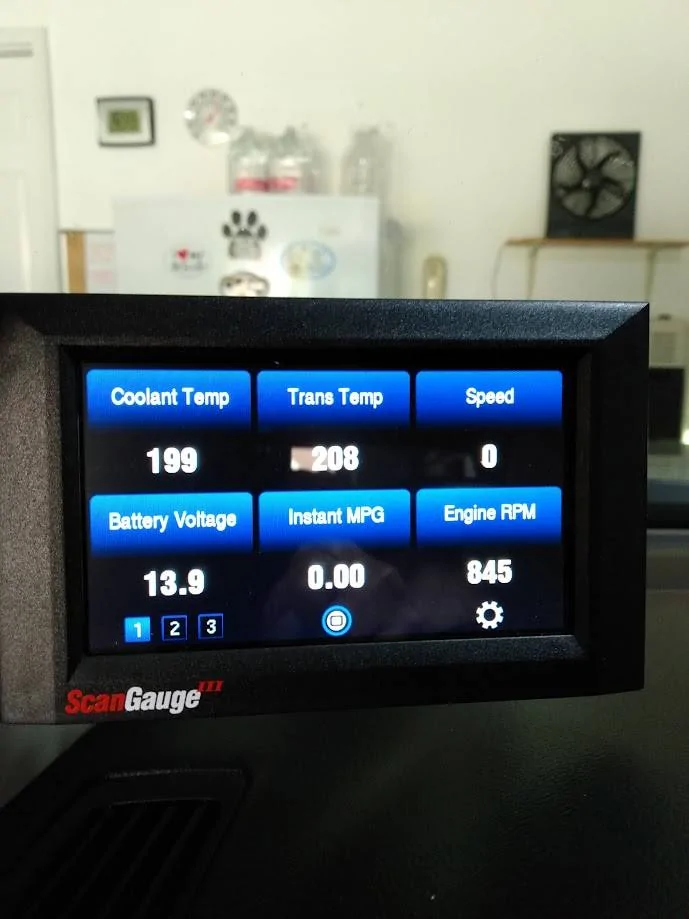

I just got back from a quick run into town and back...maybe 20 miles. Outside temps are around 92-95.
Temps are the norm for solo (not towing) in hot weather.....
When towing our travel trailer it's hit 210-220 for trans and 205-215 coolant on hot days running up grades...especially long ones, but cools down quickly when cresting.
Nothing to worry about....

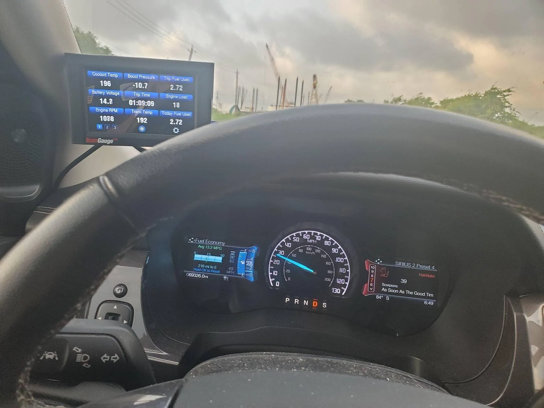

Here is a typical run of 50 plus miles at 84ish outside
