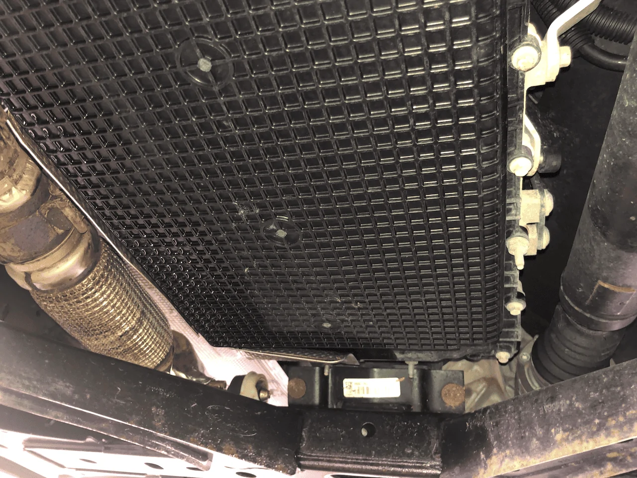

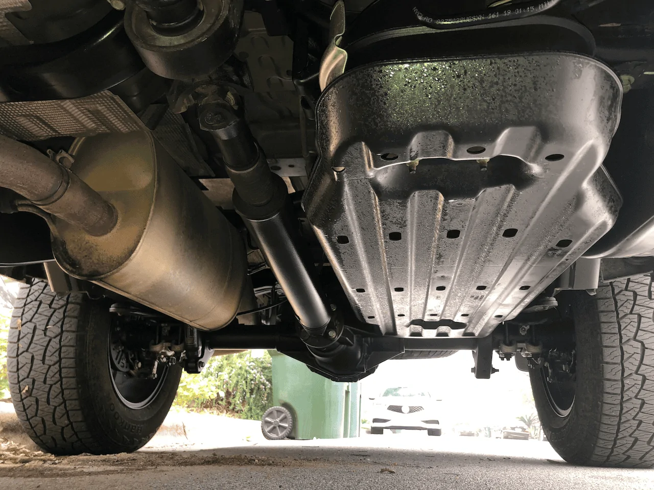

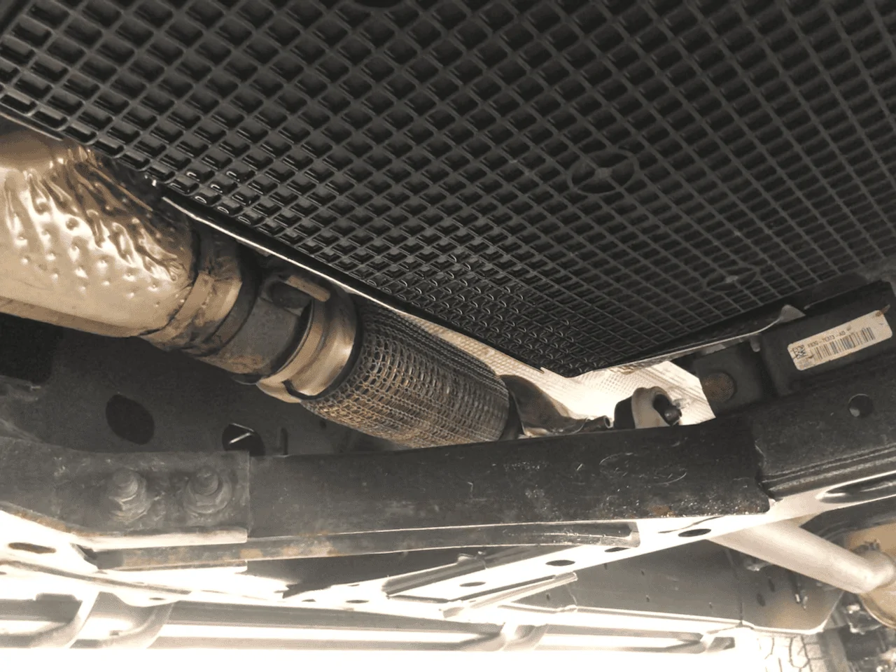

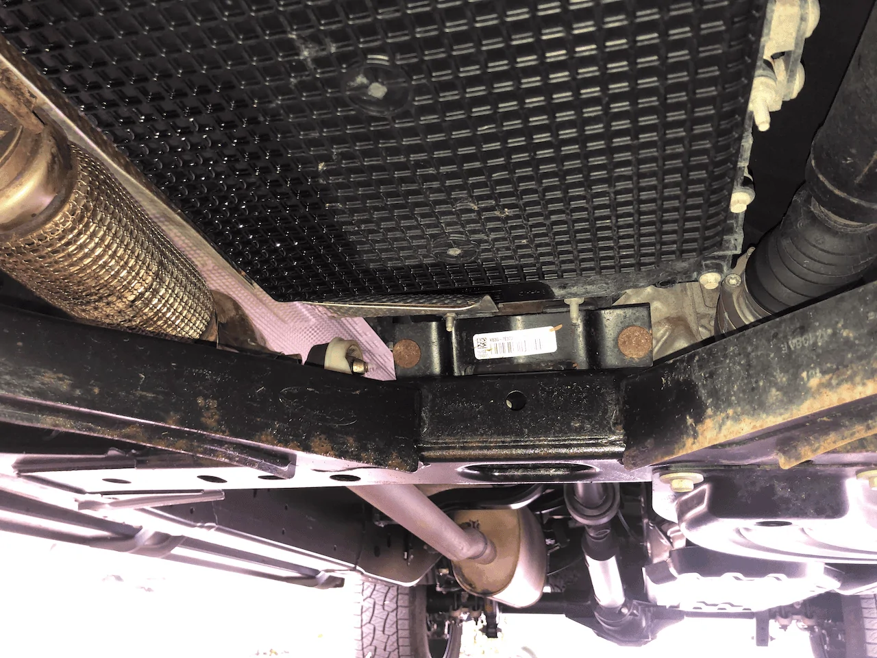

Honestly not sure how much vented. I was going between 40 and 60mph when I think it happened. Here’s what it looked like underneath the next day. You can see where it got on the passenger side and on the gas tank.

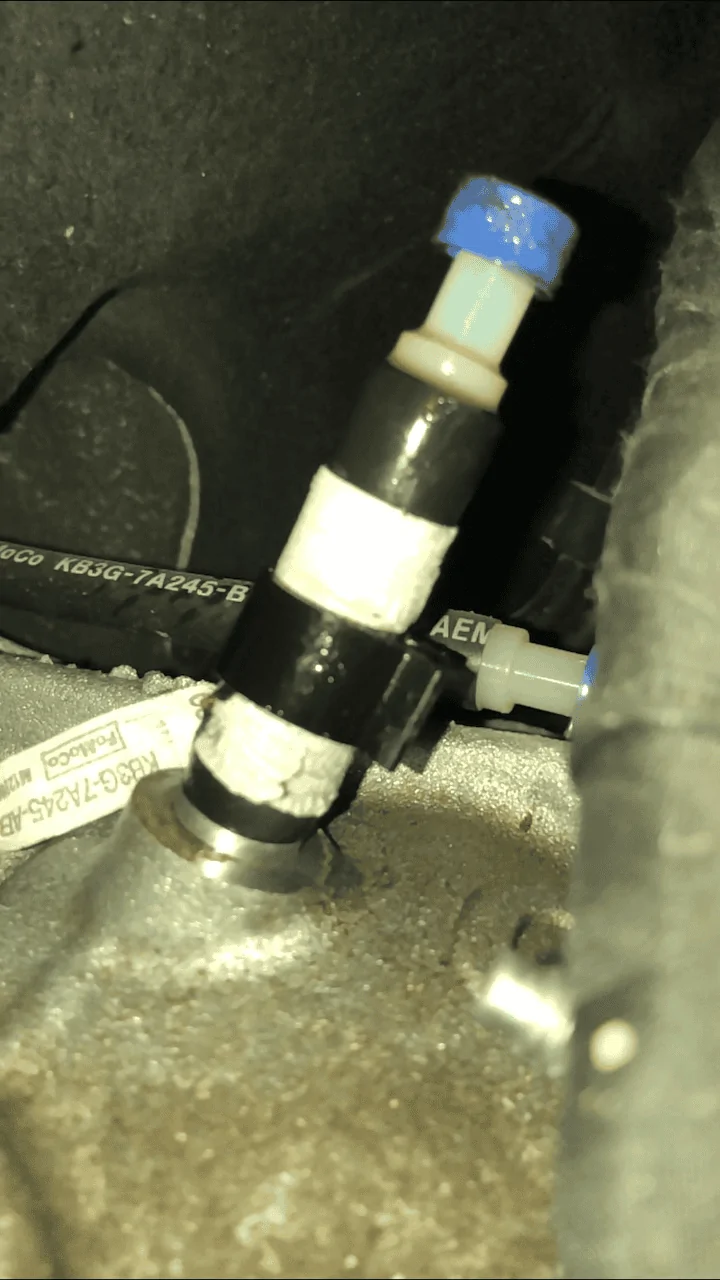

And here was the vent:

I'll be interested to see what the dealership says and see how much fluid they had to replace.

Trans was probably overfilled. Been there... caused it.
