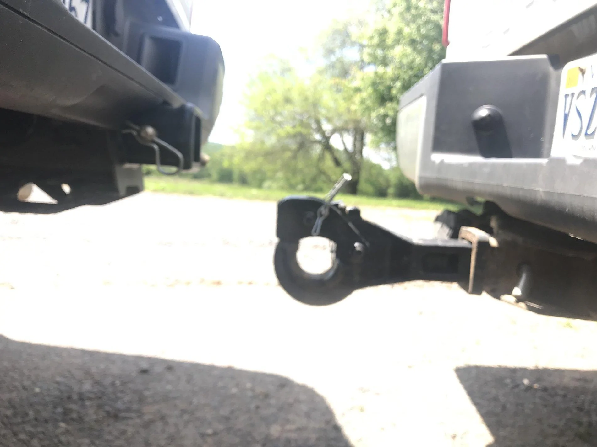

I did a short test drive with my 10 ton utility trailer and was very surprised how high the ranger receiver is. I backed it up to my F250 with plow package (higher then normal F250) and you can see that the Ranger is 3-5 inches higher than the F250.
I used a 4 inch drop with my utility trailer and the front of the trailer rode way too high.
The high hitch is great for offroad departure angle. But remember to get a 6-8 inch drop hitch when you get one for the Ranger.

Thanks. My trailer will require a 16-inch above surface ball height. I will measure the ranger to be sure the drop I need.

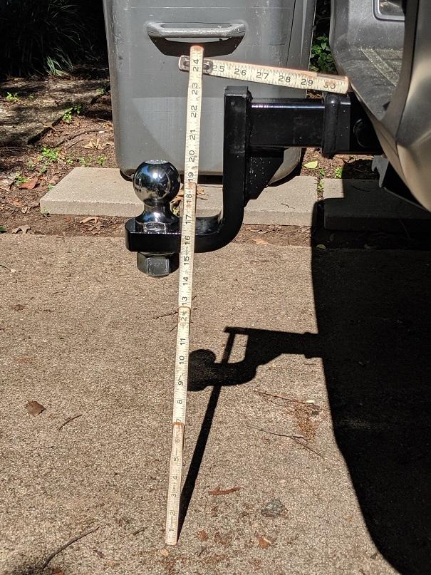

I got a 5-1/4" drop hitch and it was "reasonable" for my utility trailer, and nearly dead flat when loaded heavy. My camper is a 24" ball height, and it was pretty much at the first bolt hole of my weight distributing hitch when in "drop" mode.

I just checked mine out today and noticed it required an almost 6" drop. My F-150 is 20" with a Triple hitch. The Ranger is 25 1/2" with the triple hitch. I couldn't raise my 6x12 enclosed trailer up enough to hitch it to the Ranger. Should have taken a pic!
We normally tow with the F-150 anyway, but I will get an appropriate hitch in case we tow with the Ranger.

I got a 6-inch drop so it will be about 16 inches above the surface when trailer weight is applied.

I installed a drawbar with an 8" drop in my new Ranger with stock tow package.
With 240 pounds of tongue weight and an empty box, it was 17-1/2" to the top of the a standard 1-7/8" ball.
Adding another 350 pounds or so to the payload at the back of the box only dropped another 3/4" or so.
I could not find a 10" drop drawbar locally and my trailer really needs 16" max to the top of the ball.
