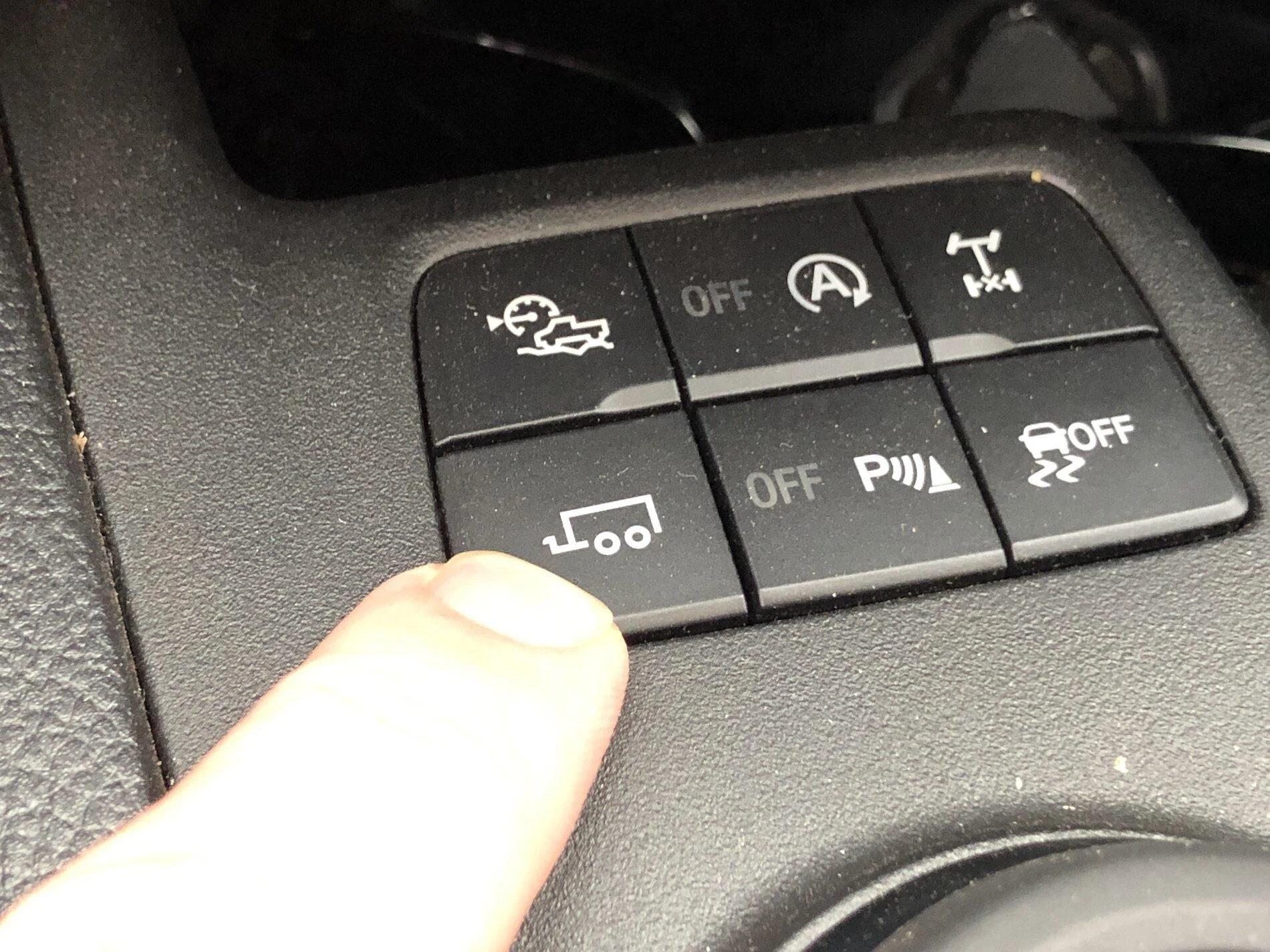

Do the 2020's not come with the tow/haul mode button near the bank of buttons by the shifter anyore? Regardless I think tow/haul mode just adjusts the shift points on the transmission so it stays in the torque ranges of the gears better. If you look under the rear bumper you should see a 4 pin harness already present. Once you plug the trailer in your truck will detect that and start to ask questions about the length and such.

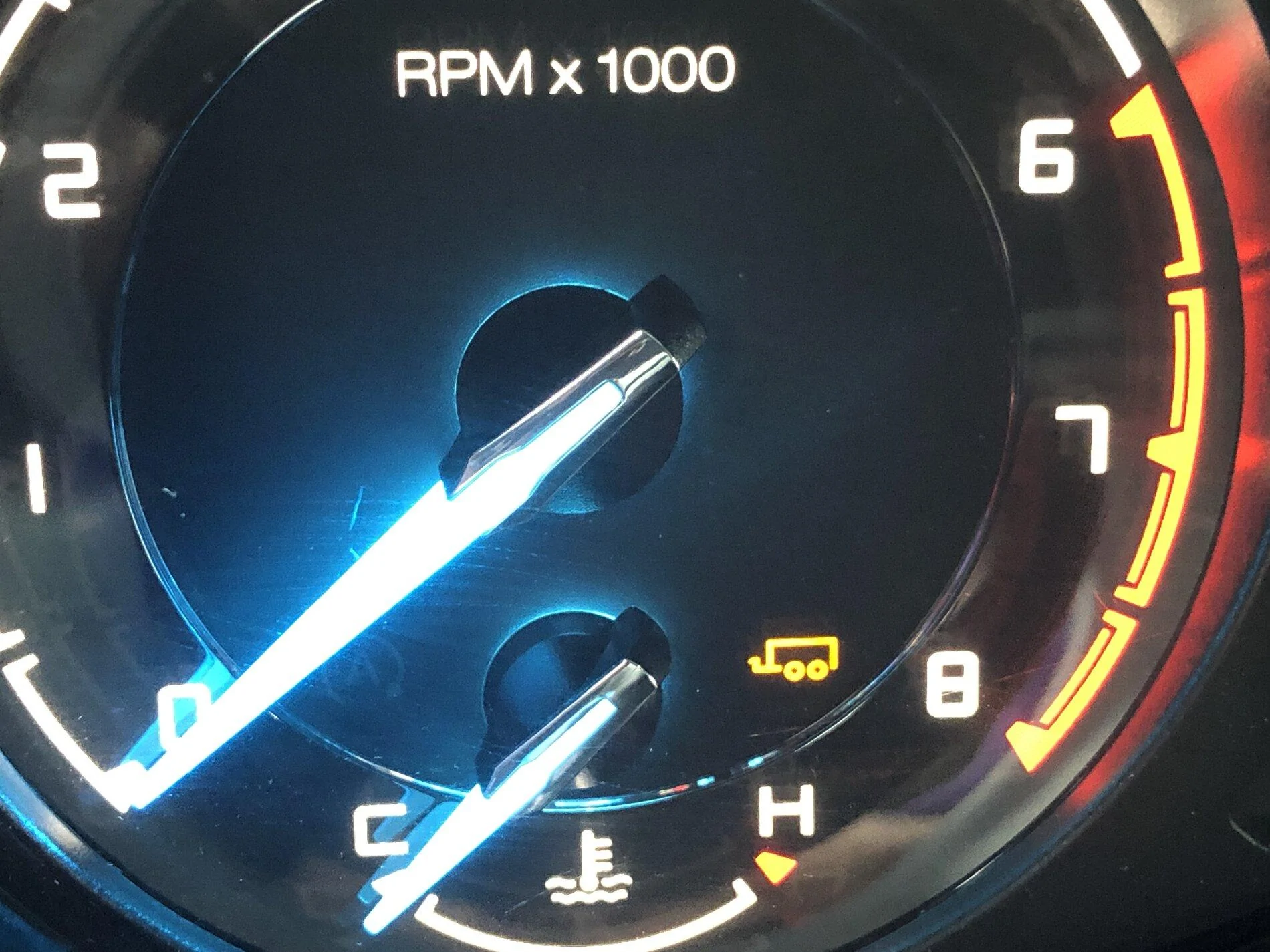

Tow/Haul mode is a button on the center console. It changes the engine tables and transmission behavior for better behavior under load. It looks like a smaller trailer icon on the button, and a similar light illuminates on the dash.

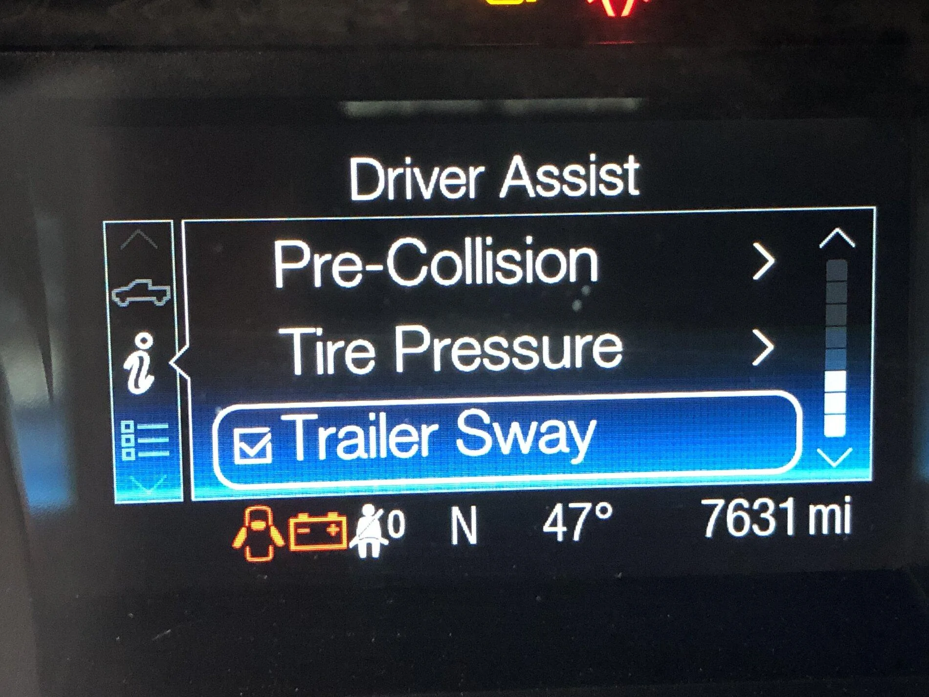

Yes. Tow/Haul button is by the shifter and trailer sway control is in the menus.
What exactly does trailer sway do? I leave it on, but maybe I don't need/want it on?

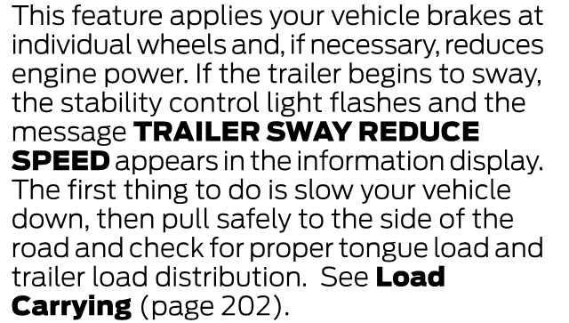

It uses to the antilock brake to independently control braking on each wheel to counter the effects of a swaying trailer. It is on by default. If you disable it, then it will come back on when you restart the vehicle. I don't know if it is part of the trailer tow package or not.
