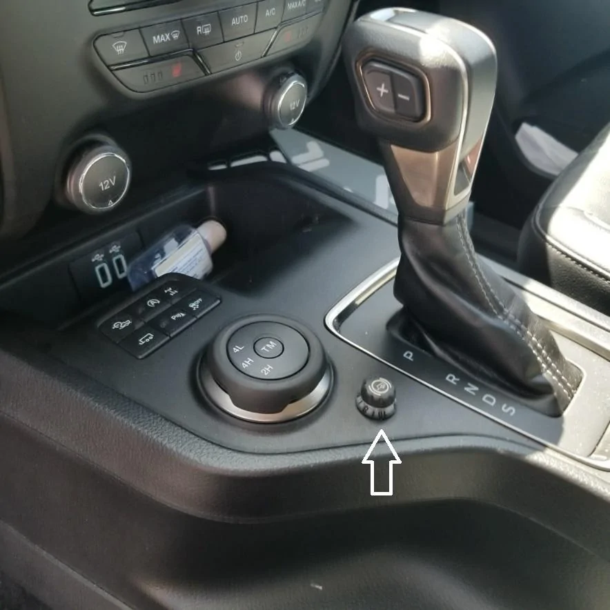

I’m out of my league. I’m going to hose something up. I’m meticulous in what I do and wish everyone had the same work ethic but this isn’t my bag. I’ve emailed literally 15-20 Ford dealerships in SC this evening. Tomorrow will tell if any reply.
I used a mobile mechanic to install the Ford TBC, on my driveway, at a very reasonable price. San Diego (near Qualcomm), not Temecula. I'll leave that here for you as an option. You can send me a DM and I can give you his phone # and name. Also no objection if you wanted to do it on my driveway... I can't help you with the tow pkg though.
Az19
Winston
Apr 14, 2021
2020 Ford Ranger 4x4 (Lariat)
I’m assuming you were happy with the results? May I ask at which location on the dash you had it installed?
I like the idea of having someone come do the work. I feel like they may not be under the same time constraints as someone at a shop.
And thanks for your kind offer! Very nice of you. First I’ll see if he can come out my way. I’ll DM you.

Yes, everything worked perfectly. I had him mount the switch between the shifter and mode selector.

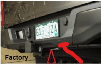

As most have mentioned. The rear bumper is totally different with factory tow package
As others have mentioned, it 's not "totally different", it's a couple of trim pieces.

The Ranger tow package really is just the hitch and the 4/7 pin connector, no additional transmission cooling and they all get the tow/haul mode. You can pull 7500 lb with an aftermarket hitch.
This shop probably doesn't want to install a factory hitch because the OEM hitch IS the rear bumber, in addition to liability related to VIN numbers dictating towing capacity. It's not as simple as bolting on to the frame as with other trucks. Several pieces have to come apart to install Ford's hitch.
