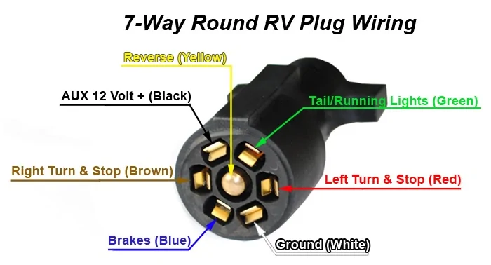

Lots of threads here on this. An aftermarket hitch is fine if you want to do it yourself and don't mind the hitch being lower than the OEM hitch. You already have a 4-pin connection for lights so your set for a small trailer without brakes or one that has surge brakes like most Uhauls. If you need a 7-pin connector for electric brakes or 12v+ to charge a trailer battery, I recommend getting the factory parts installed. It will plug into the factory harness and save having to run wires the length of the truck. If you plan on towing big regularly I reccomend getting the Ford TBC installed as it ties into all the trucks safety systems. Occasional towing a Curt Echo brake controller is fine, just remember the 12v+ on the truck does not come on until the truck sees the trailer plugged in and the truck is running
