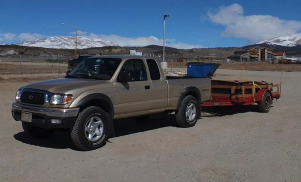

Strange you keep saying that.. cause it's just false.
I've hauled loads with my 5' x 10' trailer for the past 35 years.. no brakes at all.

Obviously a tiny trailer like that you don’t need one. Didn’t think I needed to point out the obvious
It has 3,000 thousand lb capacity, full size 15" trailer wheels and is a tilt bed.
5 ft x 10 ft is bigger than the bed on your truck, like twice as big. You call that tiny.... well... ok.

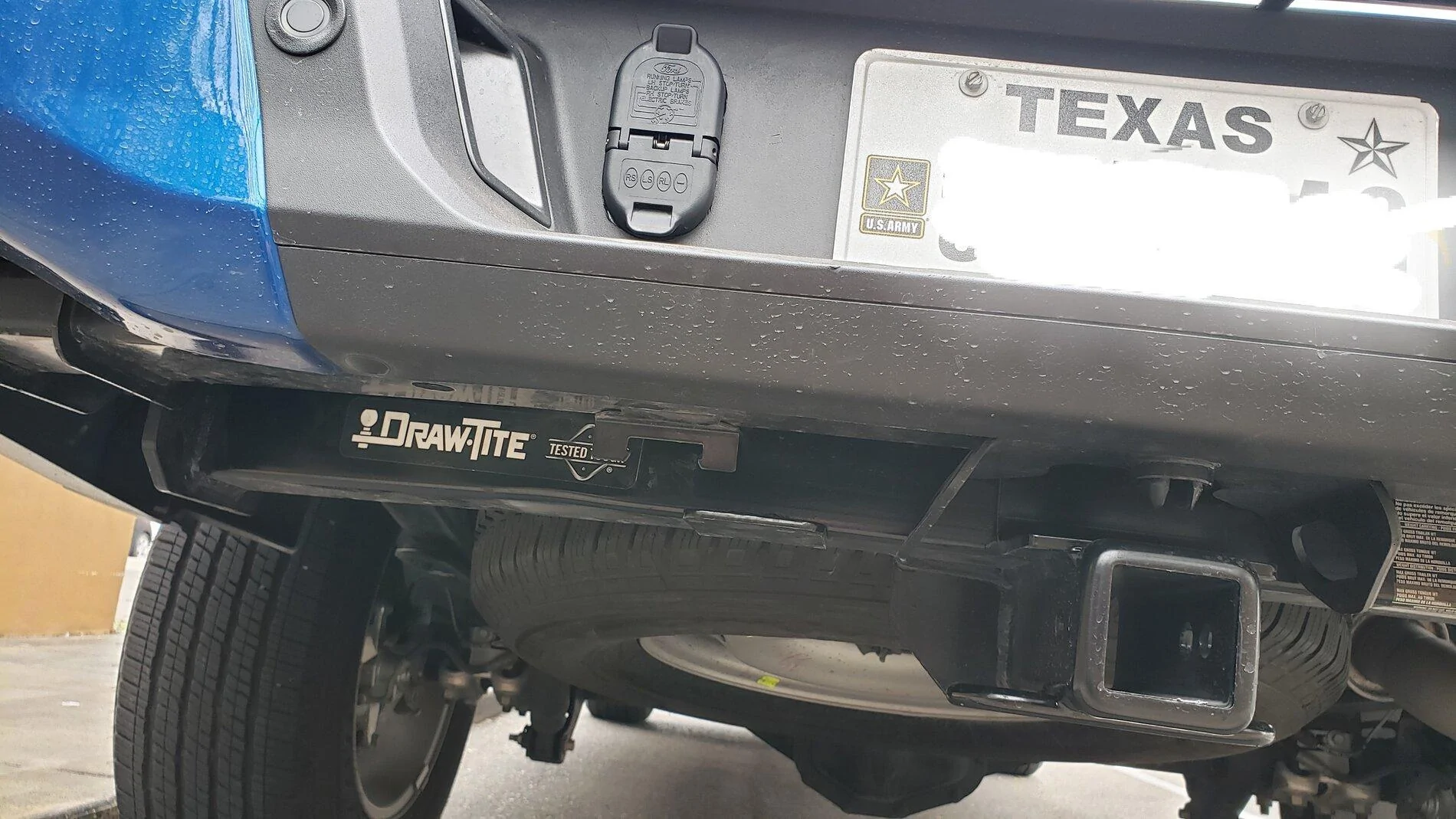

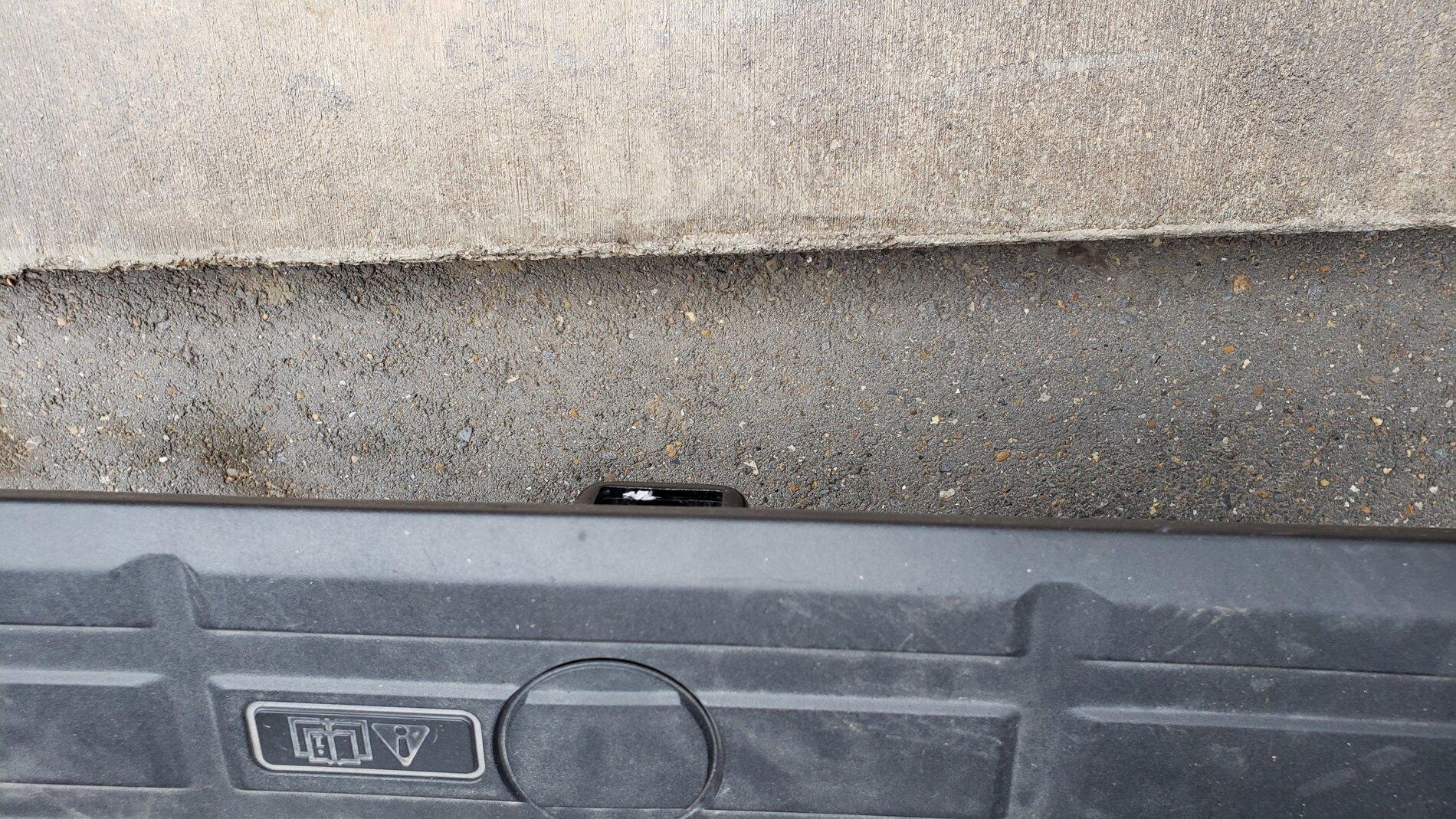

Xlt no tow package. Cost me 150 bucks. Hitch 120, 7 pin, 30 wiring harness ford points. The Ranger can do 7500. Now for a redarc ebrake. Had this same discussion here with a tt place said i could not do more than 3500 with a 4 banger. Maybe, maybe a 6. So this vehicle very capable. Use a weight distribution hitch. I would. Its safer. The reese hith tuck a little forward of the bumper. I have not had problems with trailers. Box trailer for a harley and a 1k trailer for a mower.
