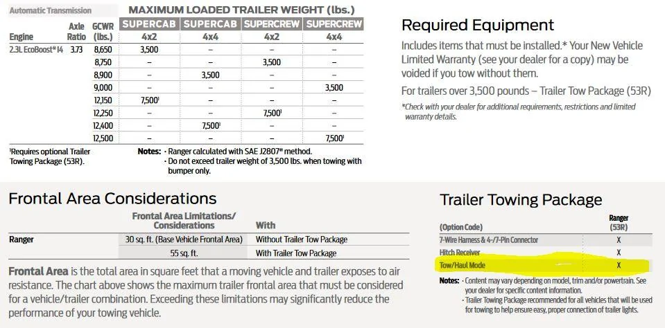

I made no claims, but you made me search.
Here is the documentation. https://www.ford.com/cmslibs/conten...ral/pdf/guides/20Towing_Ford_Ranger_Oct15.pdf
Tow/Haul Mode.
Other documentation lists it as standard. https://www.ford.com/trucks/ranger/...onic-10-speed-transmission-with-tow-haul-mode
Nothing in the documentation you referenced says anything about a 5000lb limit even if tow/haul mode is not standard. A separate 5000lb limit for non-tow-package trucks is the claim.

Right. It is 3500 lbs.
Unless you add the stuff from the tow package. Which, as has already been said in this thread, consists of a hitch receiver and 7 pin connector. https://www.ford.com/trucks/ranger/2020/models/ranger-xl/#trailer-tow-package
You've added the novel twist that maybe the tow/haul button is part of the tow package (I suspect it's an error, as I'm pretty sure I've seen it on non-tow trucks before.) But there's nothing to suggest that button has anything to do with the GVWR.

They all come with tow haul mode so I’m not sure what you are trying to say. All rangers with a hitch, 7 way plug and brake controller can tow 7500 pounds wether it came with a tow package or not
I think he found another ford documentation bug, unless that's about to be the next cost-saving measure.
you don't need a brake controller either unless your trailer requires it.

:facepalm:You cut off the bottom of the page where it makes the distinction between towing with the bumper (3500 lb limit) and towing with a hitch (7500 pound limit).
My 2019 XL did not come with the tow package, but still came with both the tow/haul button and trailer sway control.

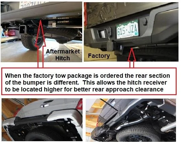

I was worried this was going to be a pain in the ass to have done. If dealerships don’t want to touch it anymore due to complaints it says something. The muffler guy said he has done many of the new rangers however it wasn’t clear if he only meant 3rd party. He said I would be in and out in about two hours. He may not be aware of the job he is taking on. Might have to touch base with him again. I can just imagine him breaking a bunch of clips or something.
I think more than anything the amount of time Ford says it takes to install the hitch isn't enough. Therefore the tech can't get it installed in that amount of time and the dealership looses money.
They don't want to lose money.
The aftermarket hitch is a simple bolt on... but looks nasty in comparison to the factory set-up.
No way I'd let a muffler shop do the factory hitch.. unless I had previous experience with that shops quality, or unless they gave me references and the phone number of the previous new Ranger owners that had the shop install the retrofits, so I could call them to verify form/fit/function.
Hope that helps. Good Luck!
