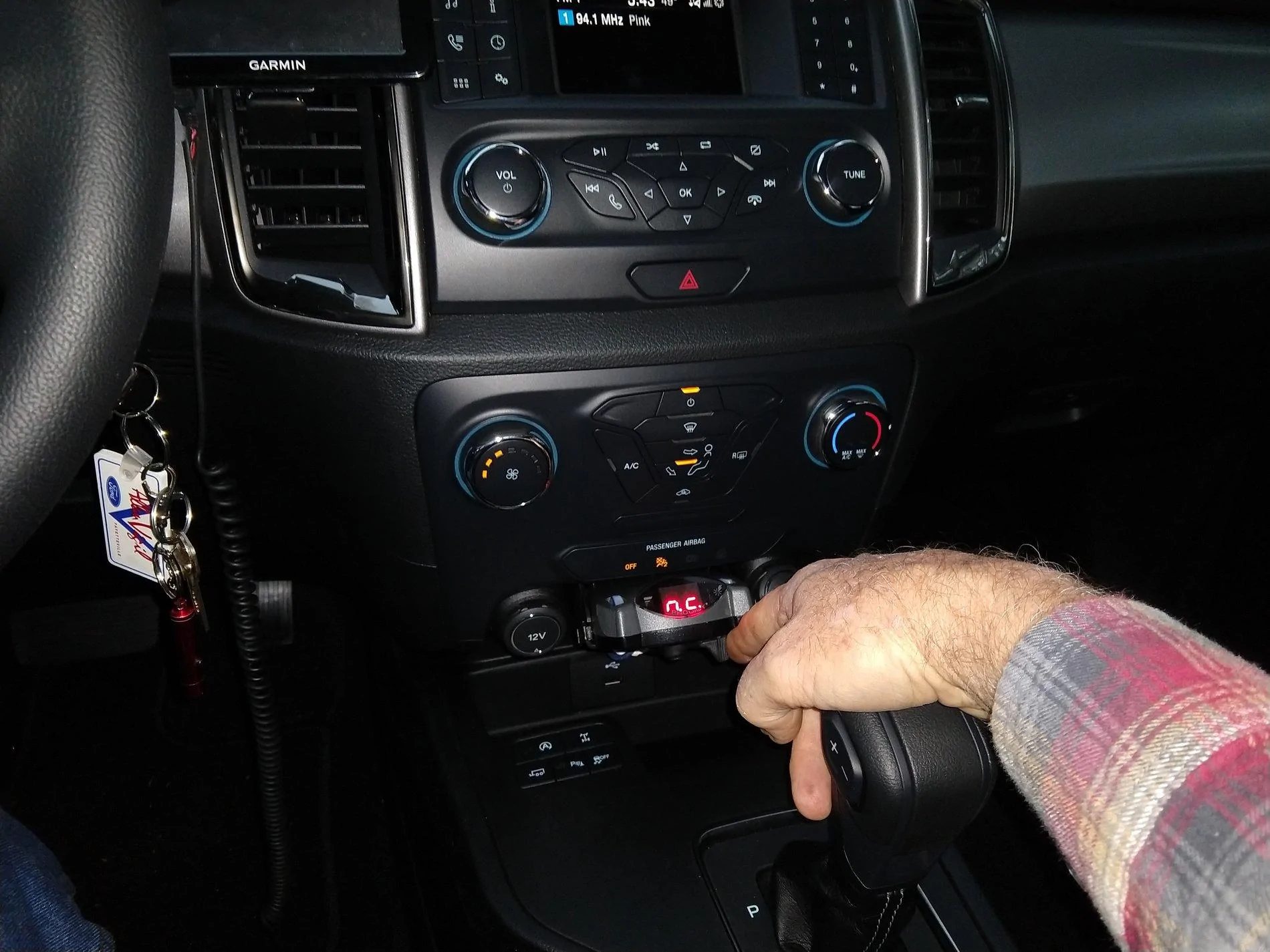

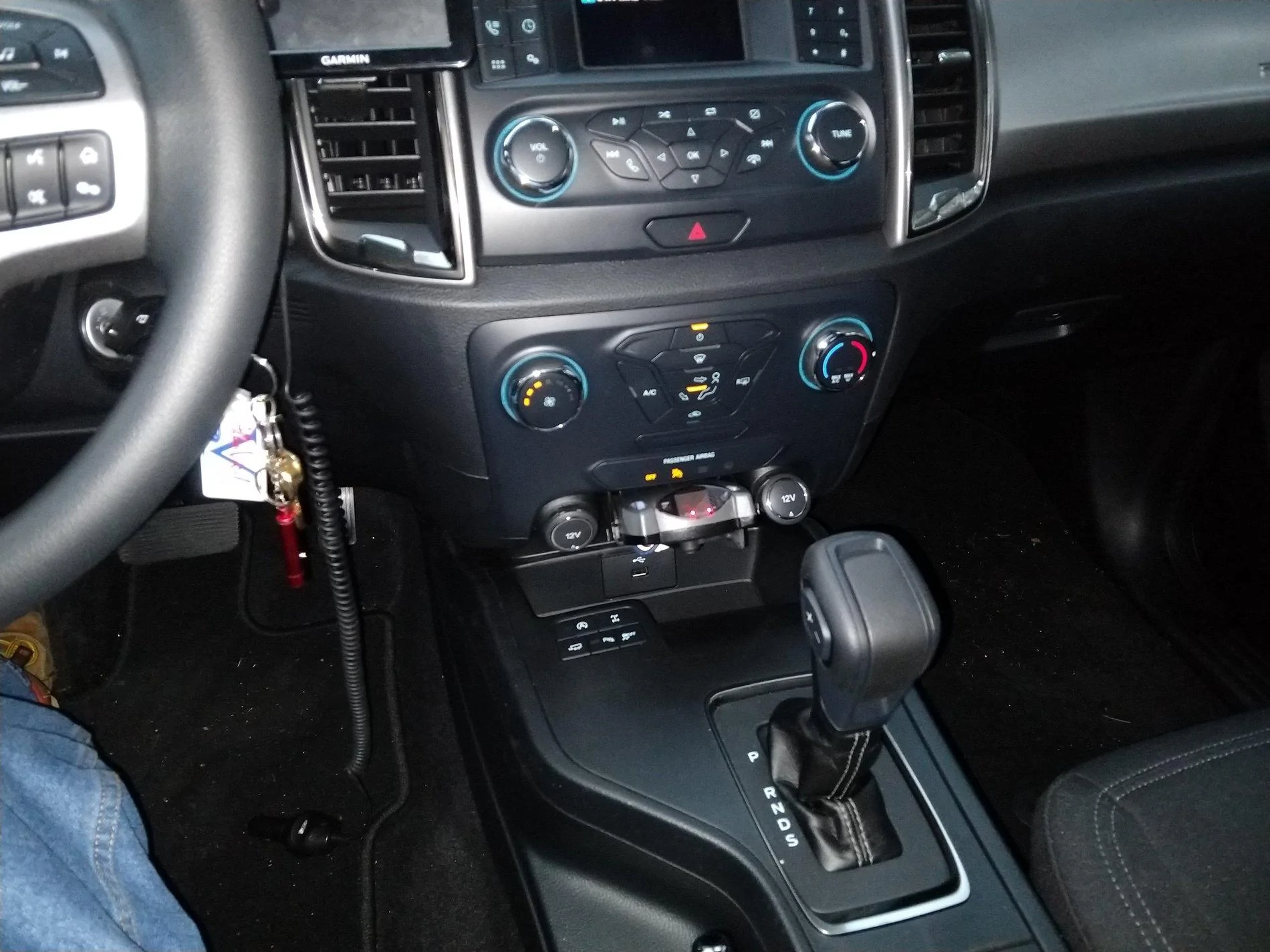

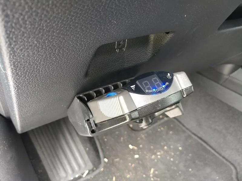

No fuses blown. Not sure if it was a computer reset or time or just a poor ground on the tester, but everything seems to be working fine now. Mounted the P2 holder below the fuse box handle using max strength 3M tape. We'll see how long that holds.
I had planned to put mine there too, but I noticed my knee would be hitting it every time I got in due to my long legs.
I like the smallness of the Redarc, and I also like the Insight that Floyd has, but since I already have a Tekonsha I decided to install that for now and I can switch it back and forth easily between my three tow vehicles.
I pulled the trim piece off to check there was nothing behind it that would interfere, attached the holder to the trim piece using an existing hole for the screw, drilled a hole for wiring through the panel and put the trim back in place.
Easy to get to the sliding brake switch and check the readout, and my Tekonsha 7 pin tester says everything works!

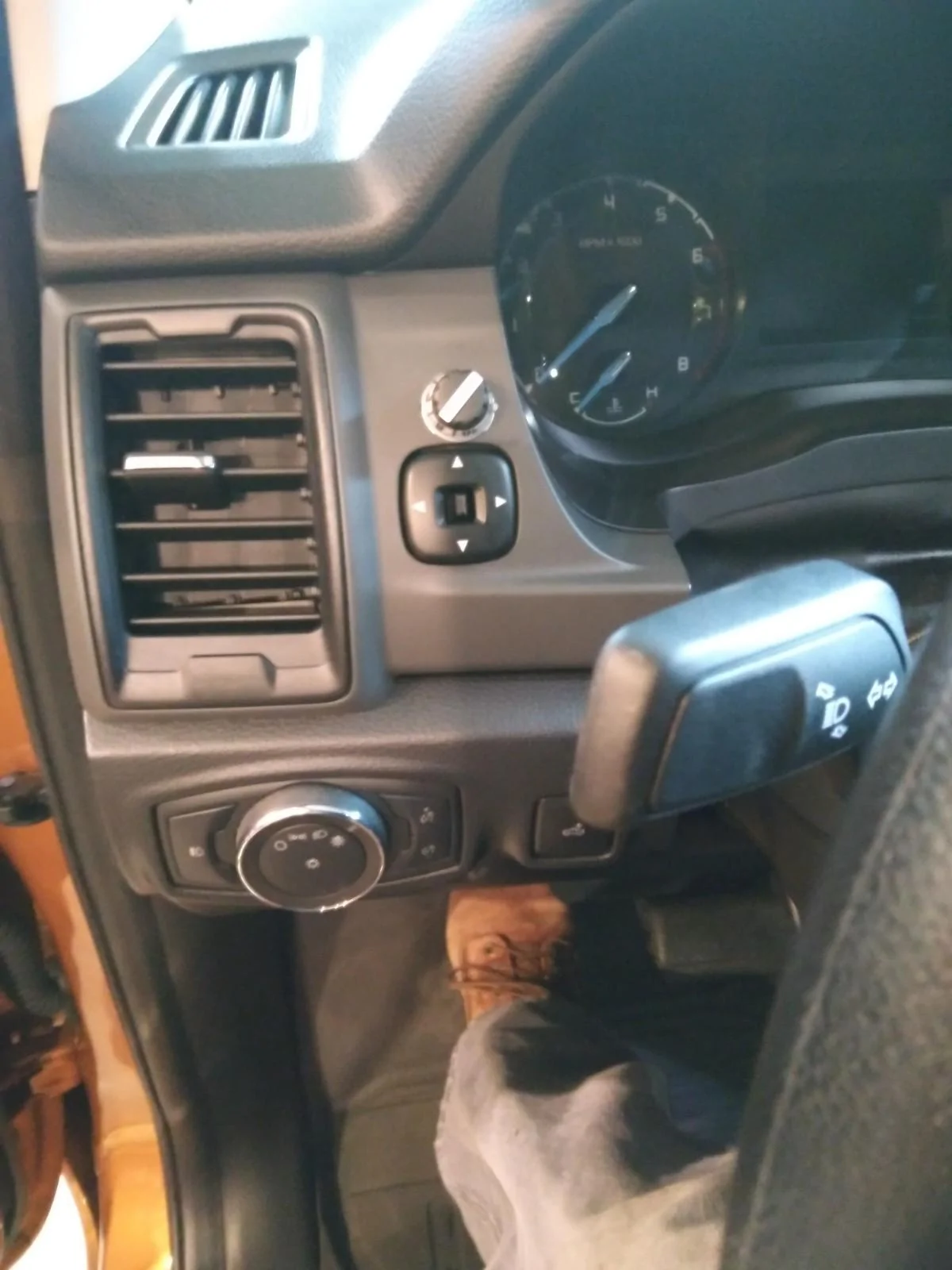

Thanks to everybody for figuring out the wiring for those under-dash brake controller wires.
I went with a left-of-steering-column install, because it's what I'm used to, and I didn't like some of the other possible locations.
Tried VHB tape to mount the holder, but it didn't hold up well enough for me. So I just screwed the mount in.

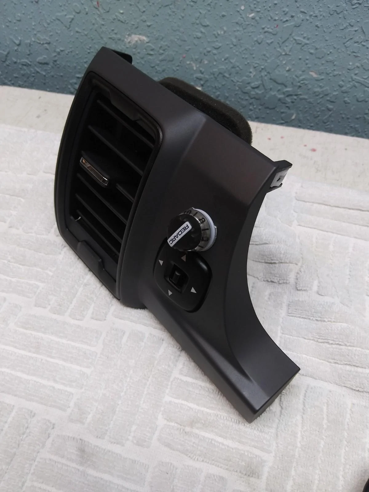

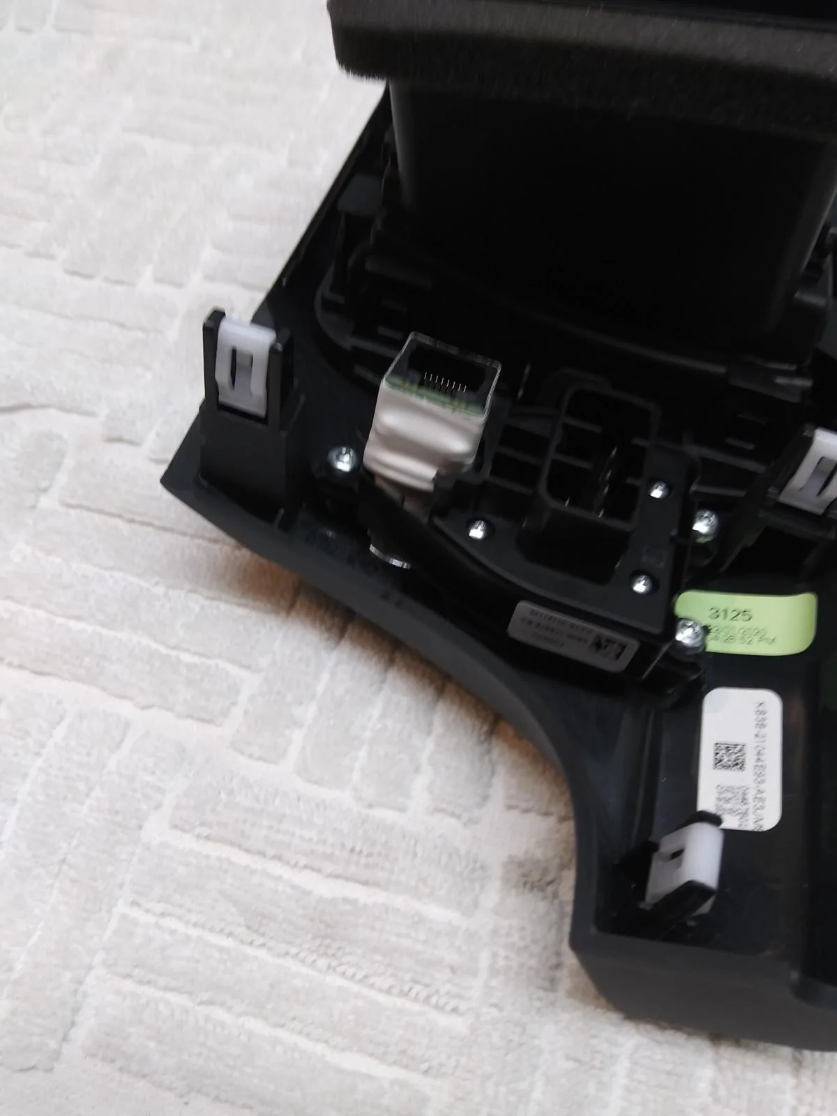

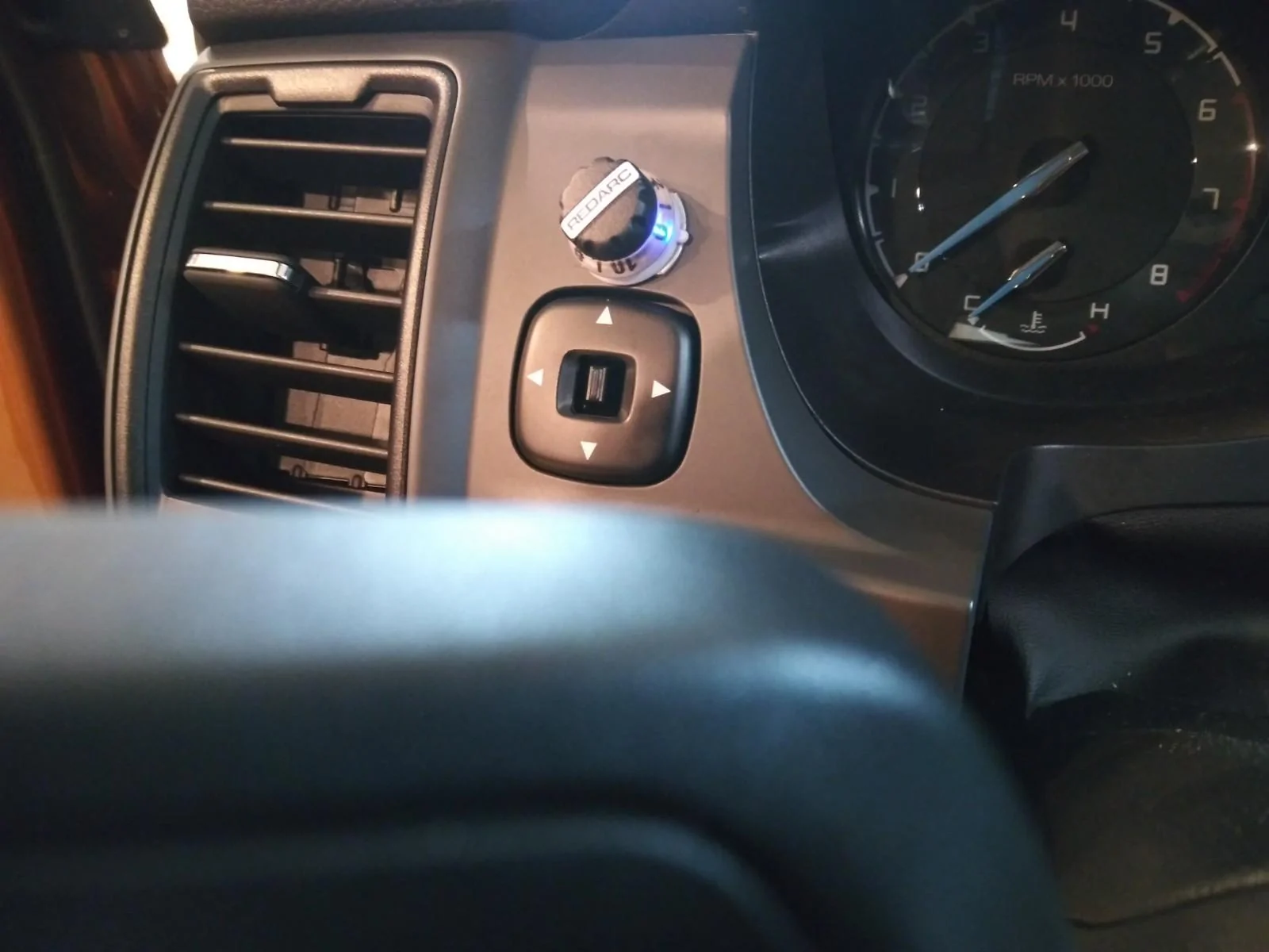

Installed mine- How about that location?
I wanted mine up there on the dash, where i could see it. My mirror mover had a unused spot above it, maybe there is something there on the XLT and Lariets. Now mine has a Brake Controller there. ?
Wana know how i did it? FPITA about 3 -4 hrs.
That is where the power fold button would be if you have that feature. That does look like a good spot to install the switch for all of us that do not have power folding mirrors.

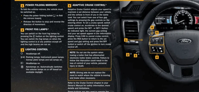

Actually Ford did tell us. This is a screen shot from the Quick Start guide provided when I received my truck in 2019. See the notes in the square boxes.
