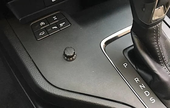

Ford is making an integrated trailer brake controller an option that buyers can choose at dealerships. Two-wheel-drive models have the trailer brake dial located next to the transmission shifter; four-wheel-drive models have the dial mounted behind the Terrain Management rotary dial. All Rangers are prewired for the trailer brake controller regardless of whether they're being equipped with a tow hitch. We think it would be better to make the trailer brake controller a factory option as part of the towing package instead of an add-on at the dealership. We've seen several dealer-installed trailer brake controllers not perform as well as those integrated into the dash during the manufacturing proces
Where'd you pull that bit of info from? The controller pictured is the RedArc I mentioned - just with a Ford cap.
