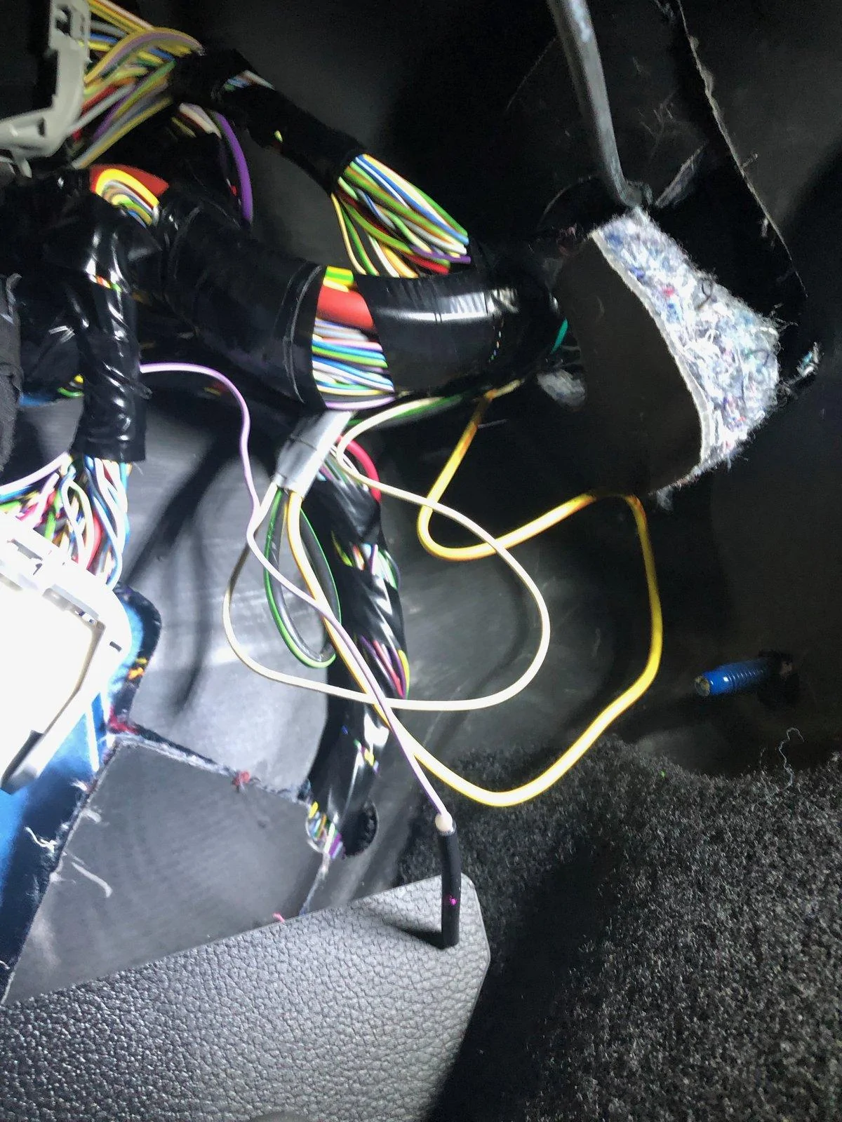

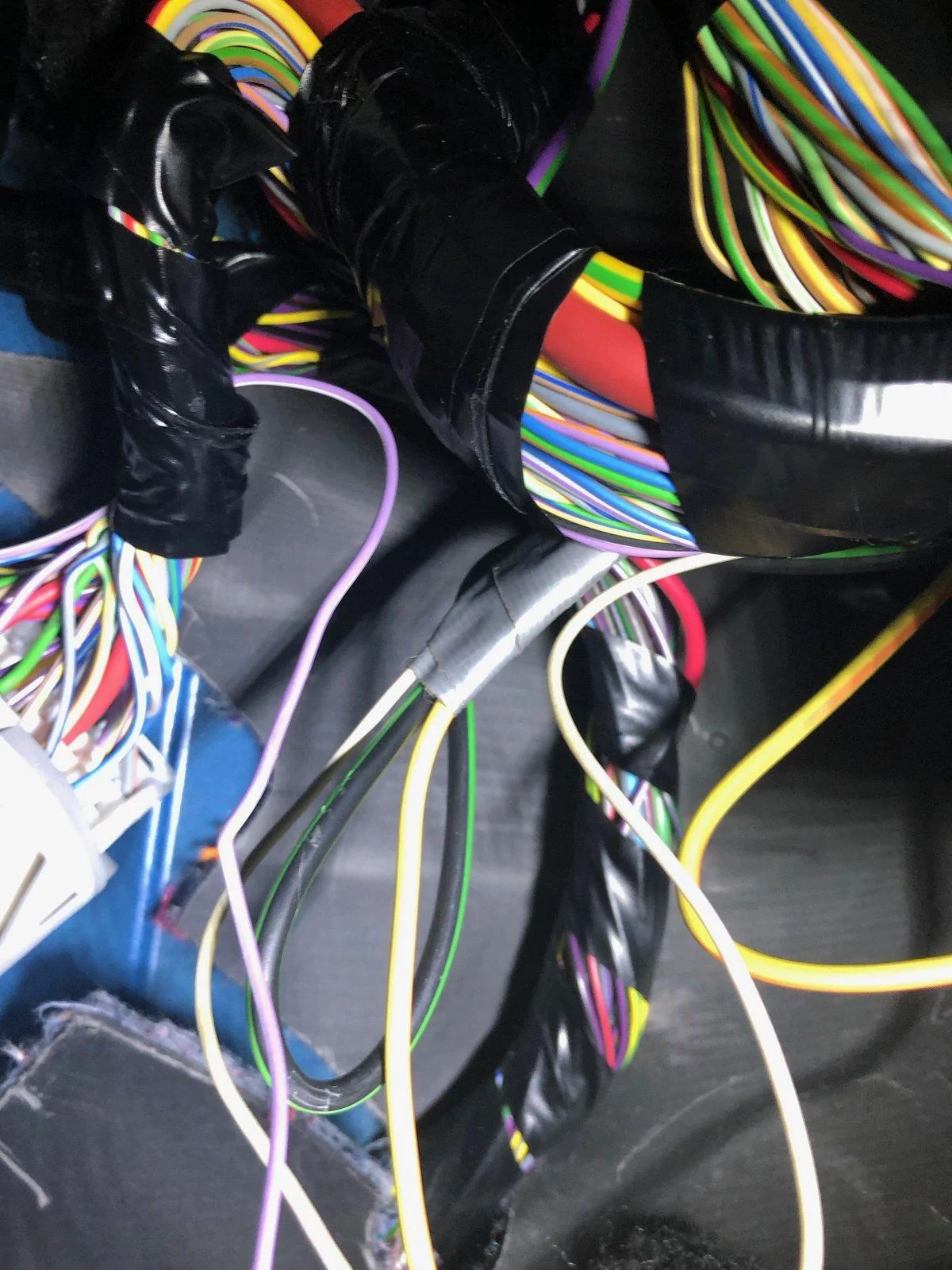

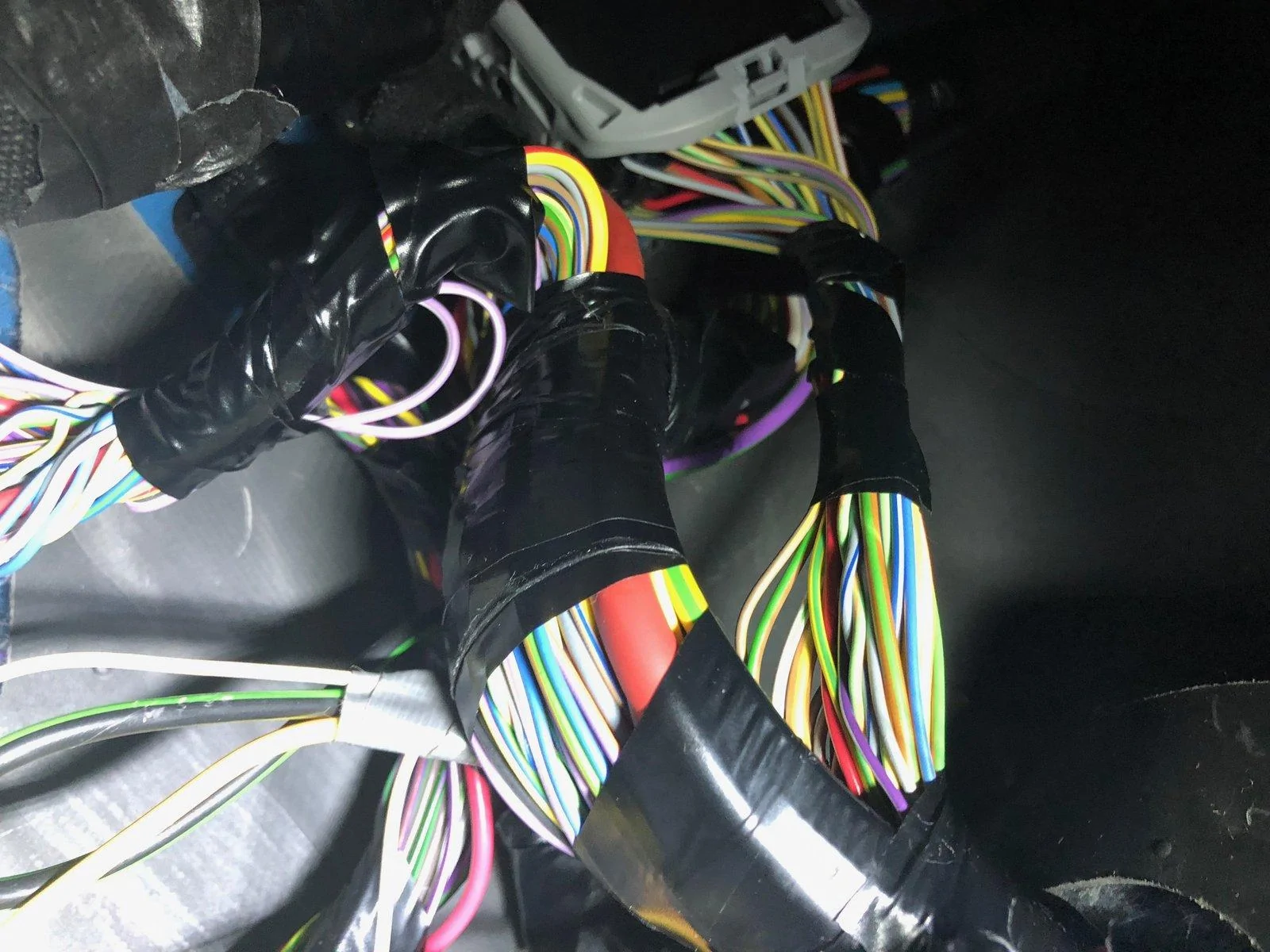

found the violet/white wire tape in a near the others but coming out of the white plug. here are some pictures

Sounds like you've got the 4 necessary wires. Put a tester on the end of the Violet/white wire to make sure it goes on and off with the brakes and you should be set.

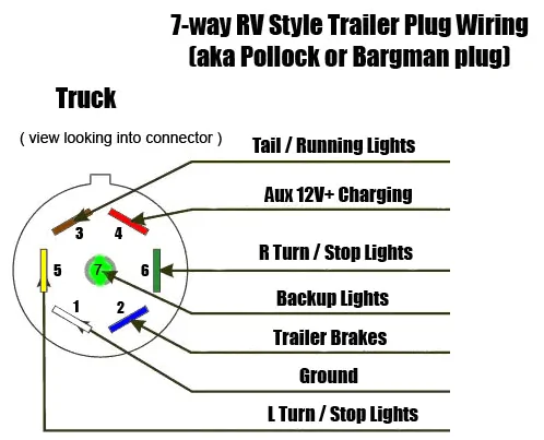

Just wanting to make sure....you did verify the Green/Black wire went to pin 2 of the 7 Pin round connector correct? The diagrams show a Blue wire so I'd double check that if I were you. (convention shows it to be blue as well).

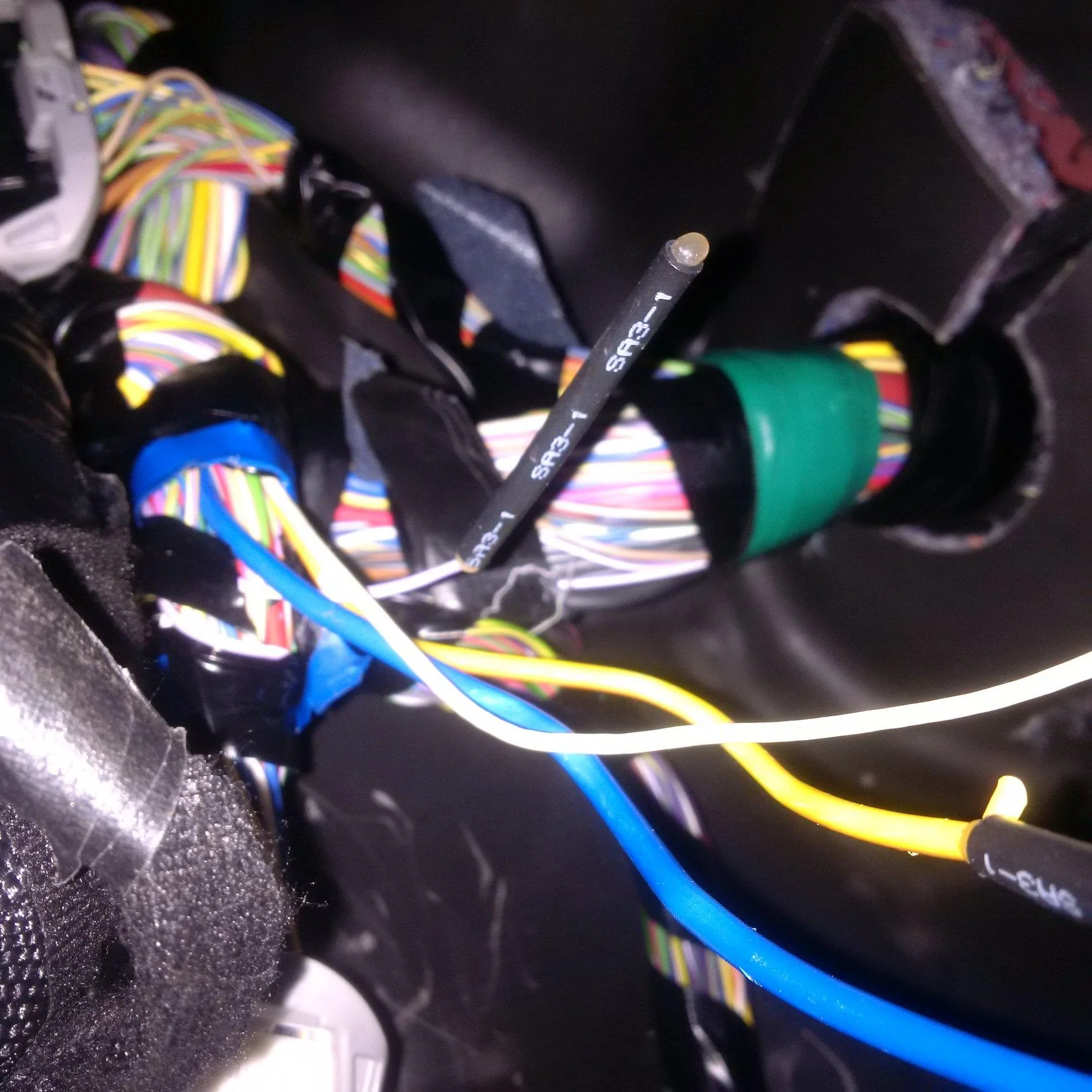

This is close to an answer but will be great to hear from an owner who has accomplished the task
The 4 wires for the brake controller are bundled up by the driver side left kick panel. They are butt ended and shrink sealed. No plug so will need to be butt spiced to an aftermarket controller.
