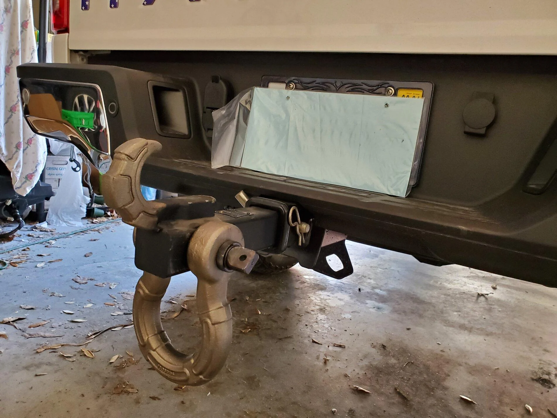

I'd stick with the stock recovery points. A shackle/D ring whatever you want to call it fits through them just fine to connect a tow strap or winch cable, and they're already there, and rated by ford. I trust that a little more than a block of metal and welding that an aftermarket company is doing.
Also, the aftermarket things look cool when the shackles are attached, but you can't really drive around with the shackles on, as they make a ton of noise, can rattle loose and fall out, or will likely get stolen, and those aftermarket points look silly without a shackle connected to them.
Also, it seems like all the ones available stick out a lot farther than the stock recovery points... I can imagine them digging straight into the ground on a steep incline and getting clogged up with mud/dirt or banged up on rocks, where as the stock loops seem like they'd deflect a lot better.
It is a good idea, though, to get an adapter for the tow hitch of your truck so you have a solid recovery point at the rear of your vehicle, and those are easy enough to remove when not in use.
