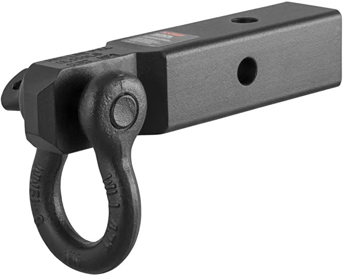

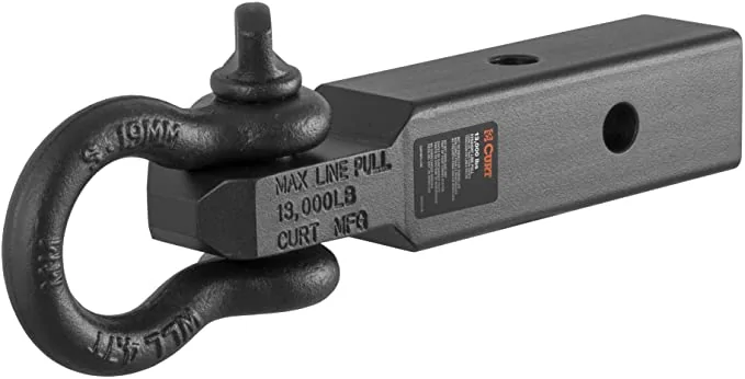

So on the trailer mount D-ring/shackle/clevice, that I am getting, you can orient it two different ways as per the picture. Just curious when would you need it sideways?
edit: I did a lot of googling and turning it sideways is for angle pulls.
