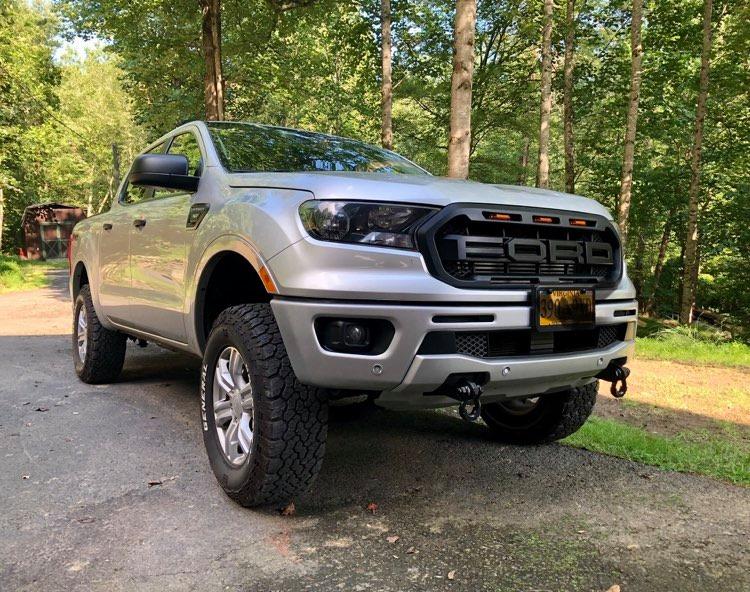

Tossed a set on my truck. Super easy install, 10-15 minutes, and I used cotter pins to discourage anybody who might decide to 'borrow' the d-rings.
