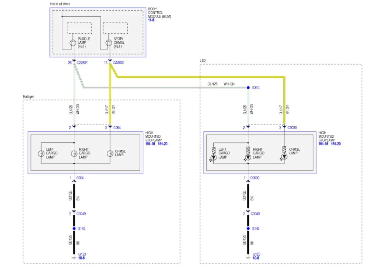

I have the Ford branded TBC but not installed because of the wiring to the cab brake light.
I tried to find the post someone posted an under dash connection for rear cab brake light. I don’t mind splicing into a wire harness as I have a lot of experience and the proper tools so no biggie to me. I just need to know the connector and pin number. Any help would be appreciated.

Here is the wiring diagram for the center stop light. The yellow-grey wire from the BCM (fuse box under the dash) appears to be the one that you want. (Connector C2280D pin 13)

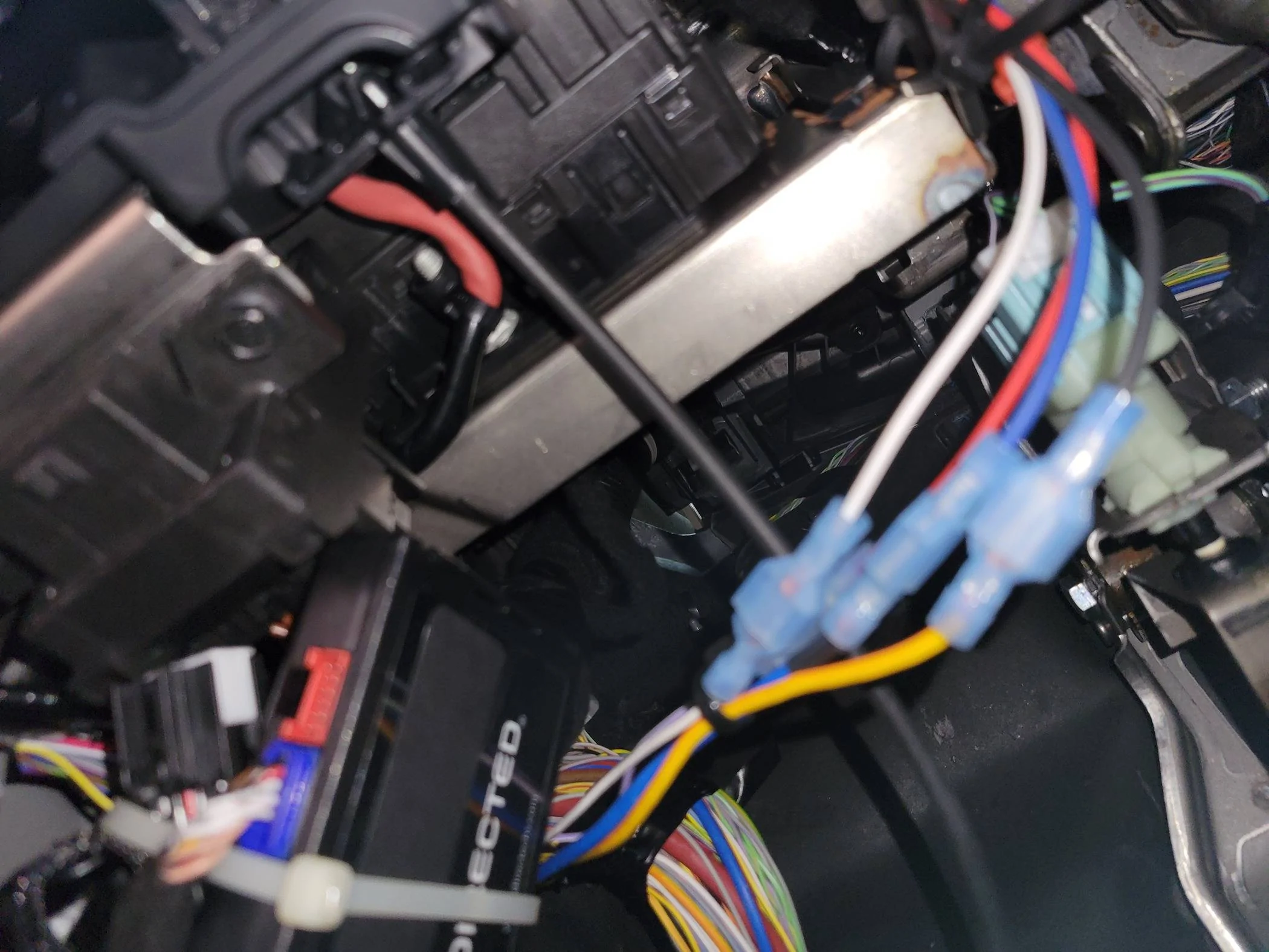

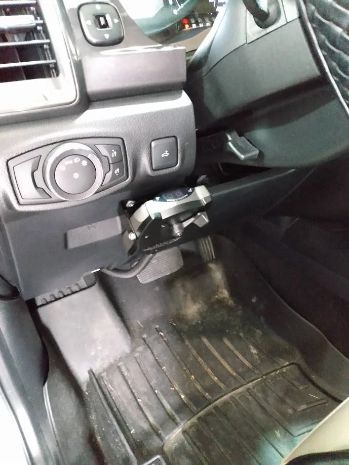

I put the redarc liberty on my 21 lariat. The only hard part was finding the 4 wires way up under the dash.
Thanks for the pic - gonna install the Liberty I got for Christmas soon. =)

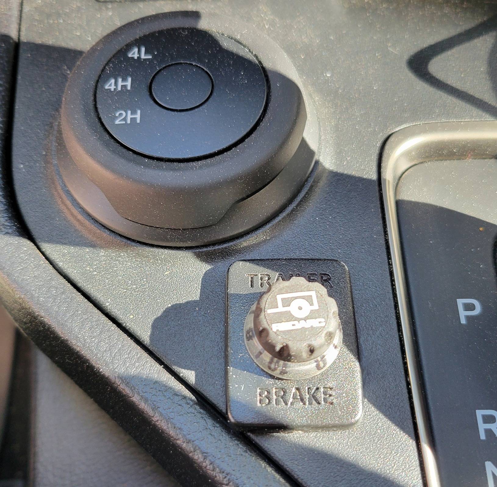

Here's my control knob. I accidentally drilled the first hole too big and had to order the rectangle cover to cover the gap.
I like that location - the passenger could hit it if all heck was breaking loose. I have a 2WD so I could move it forward to like where your transfer case knob is. That Liberty knob back end is so long, I'm glad to see it can fit there - thanks! =)
Was it hard to pry off that panel?
I'm scared to death of busting pins. I did a great job of mangling the front valence and put it back in missing a few of those metal clips and it sits a bit wonky! =D

That panel comes off fairly easily. I didn't plan on putting my TBC there, but considered placing my Homelink there, so I pulled it to see. If I remember right, there are some ribs under that trim that limit placement a little. Once you find where you want the knob, you might also need to Dremel off some plastic underneath, so that it can lay flat. There were too many for me to want to place my Homelink buttons there (they're big), but the RedArc knob should be no problem.

Not hard at all. Start lifting from rear and it just pops up. I was surprised at how easy it was. I found a YouTube video that showed how.
