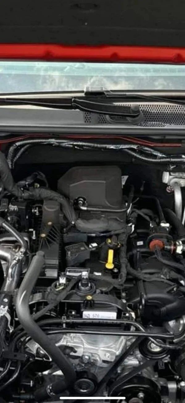

The new rangers have a cover/insulator over the high pressure fuel pump.

Finally got around to installing mine. It will work with the JCR engine cover, clears it with a mm to spare.

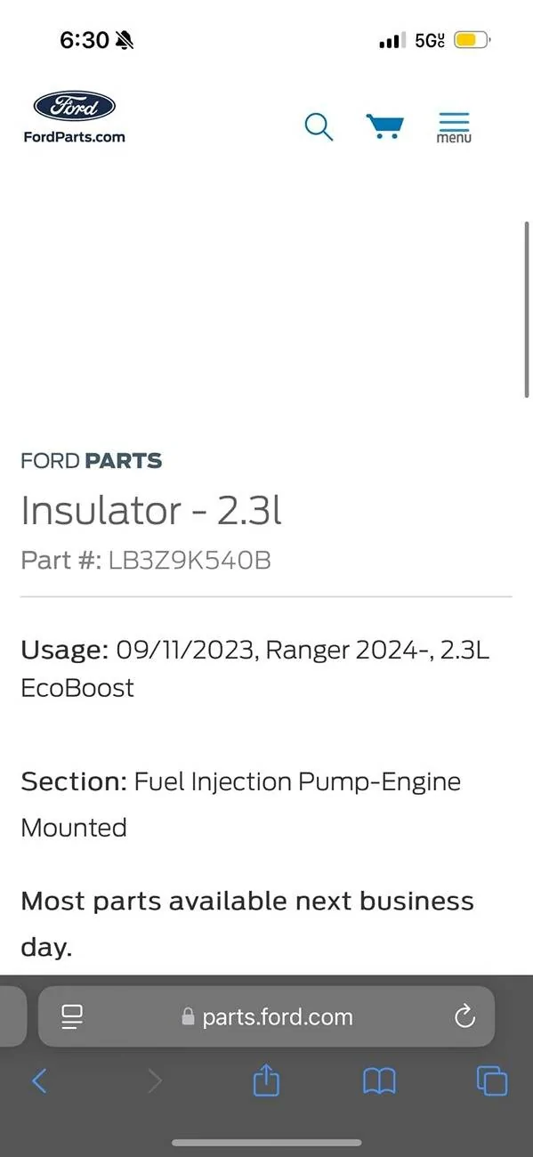

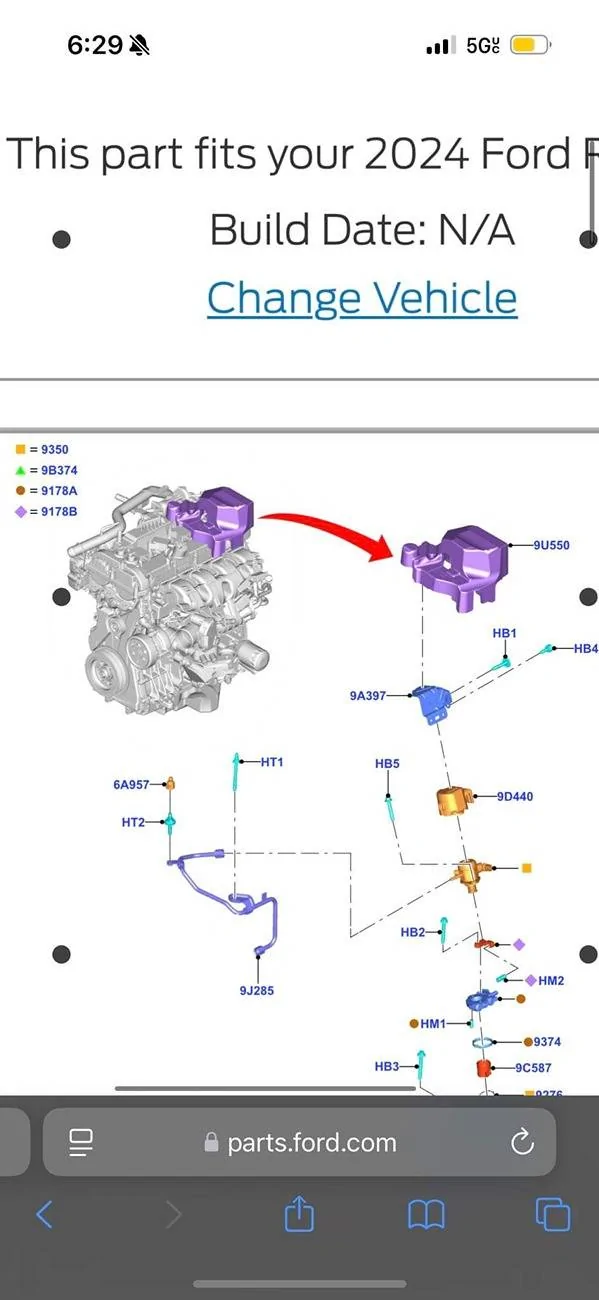

Saw this on Facebook where someone noticed the new rangers have a cover on the high pressure fuel pump. lt supposedly fits the 19-23 and drastically reduced the pump noise. It's made of the same material as the engine cover. Might also p
rotect that area from the famous drip onto the engine.

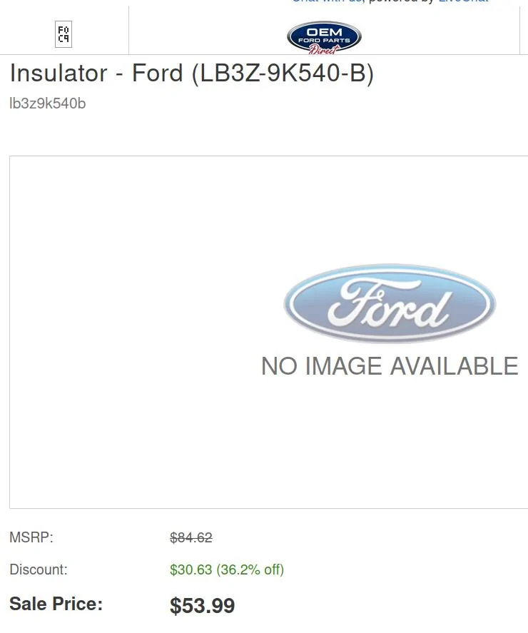

Ford Part LB3Z9K540B

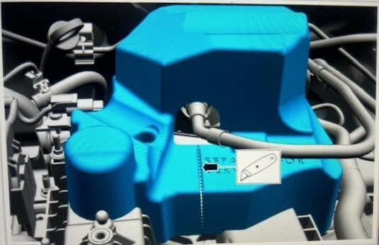

The problem with that cover is that you have to make a cut into it to get it over the fuel line, thus possibly defeating the 'water proofing' ability.
