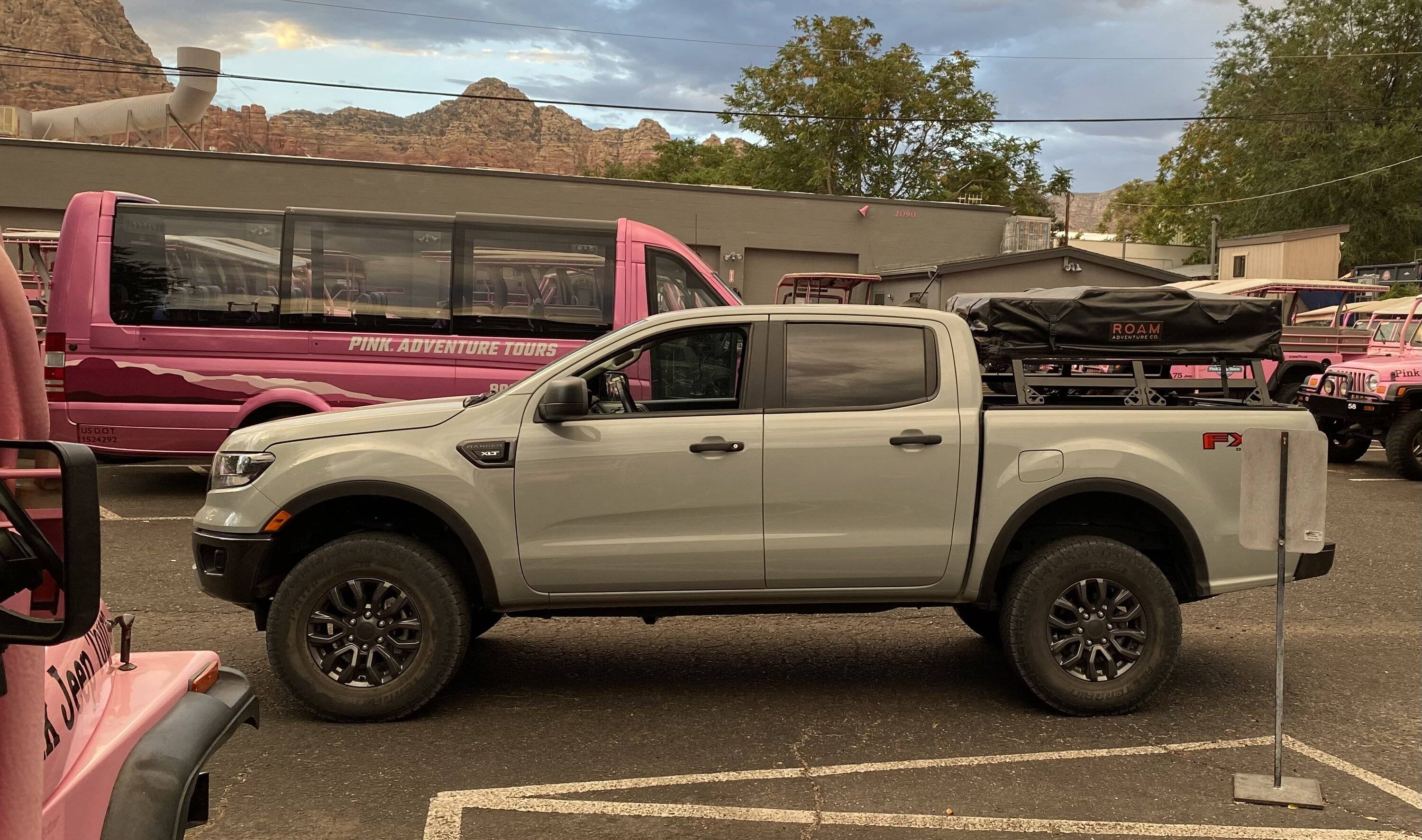

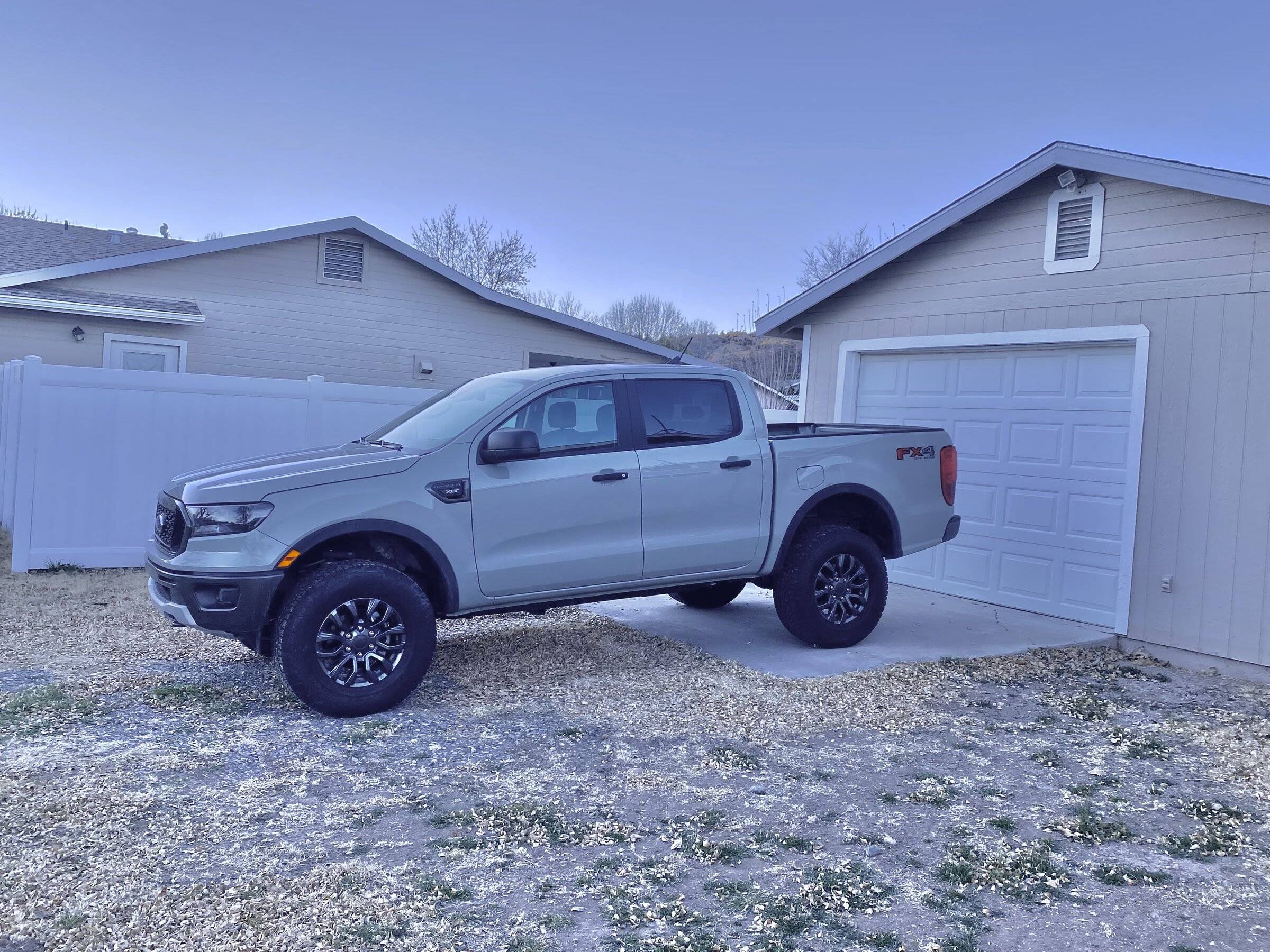

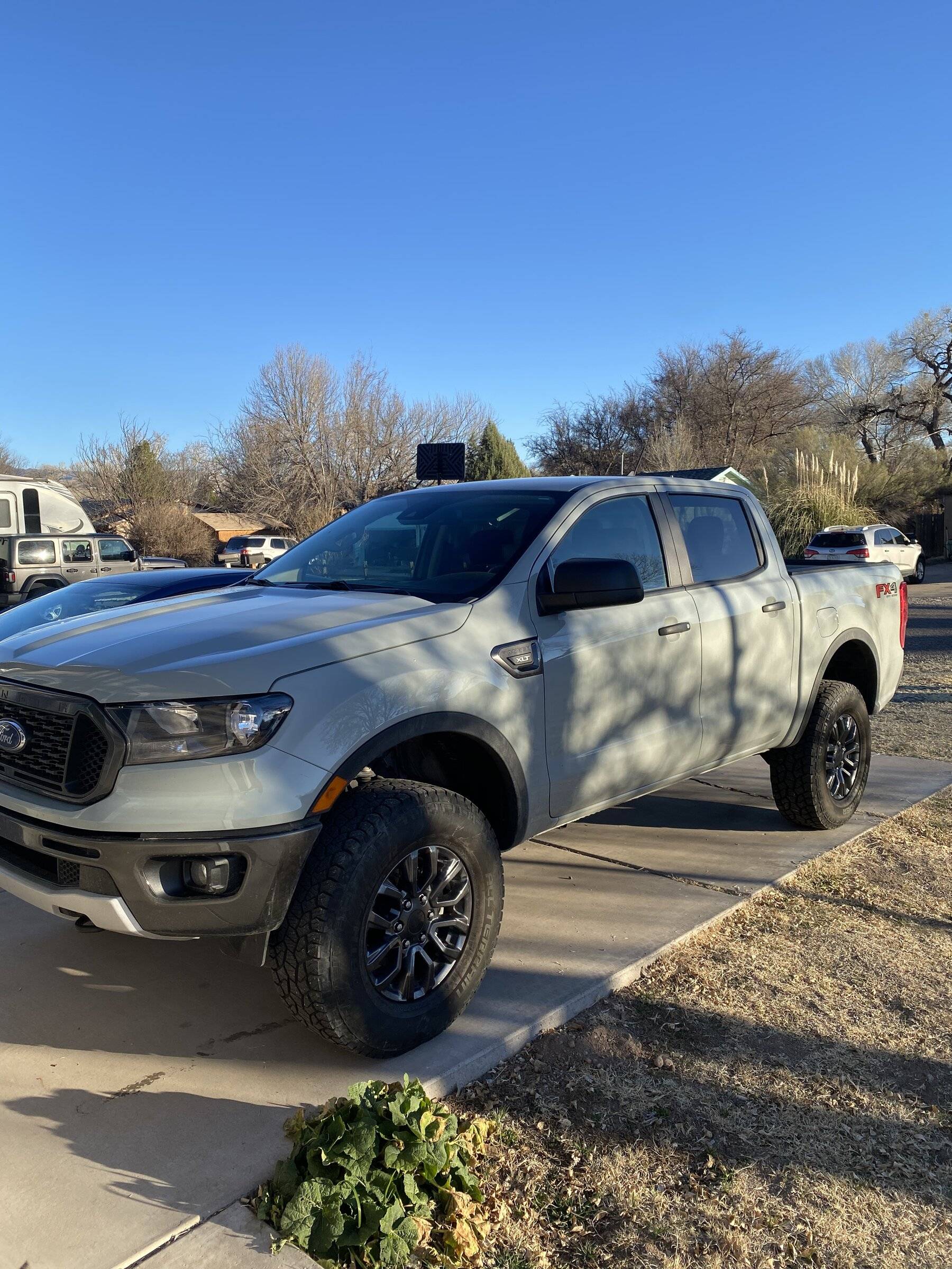

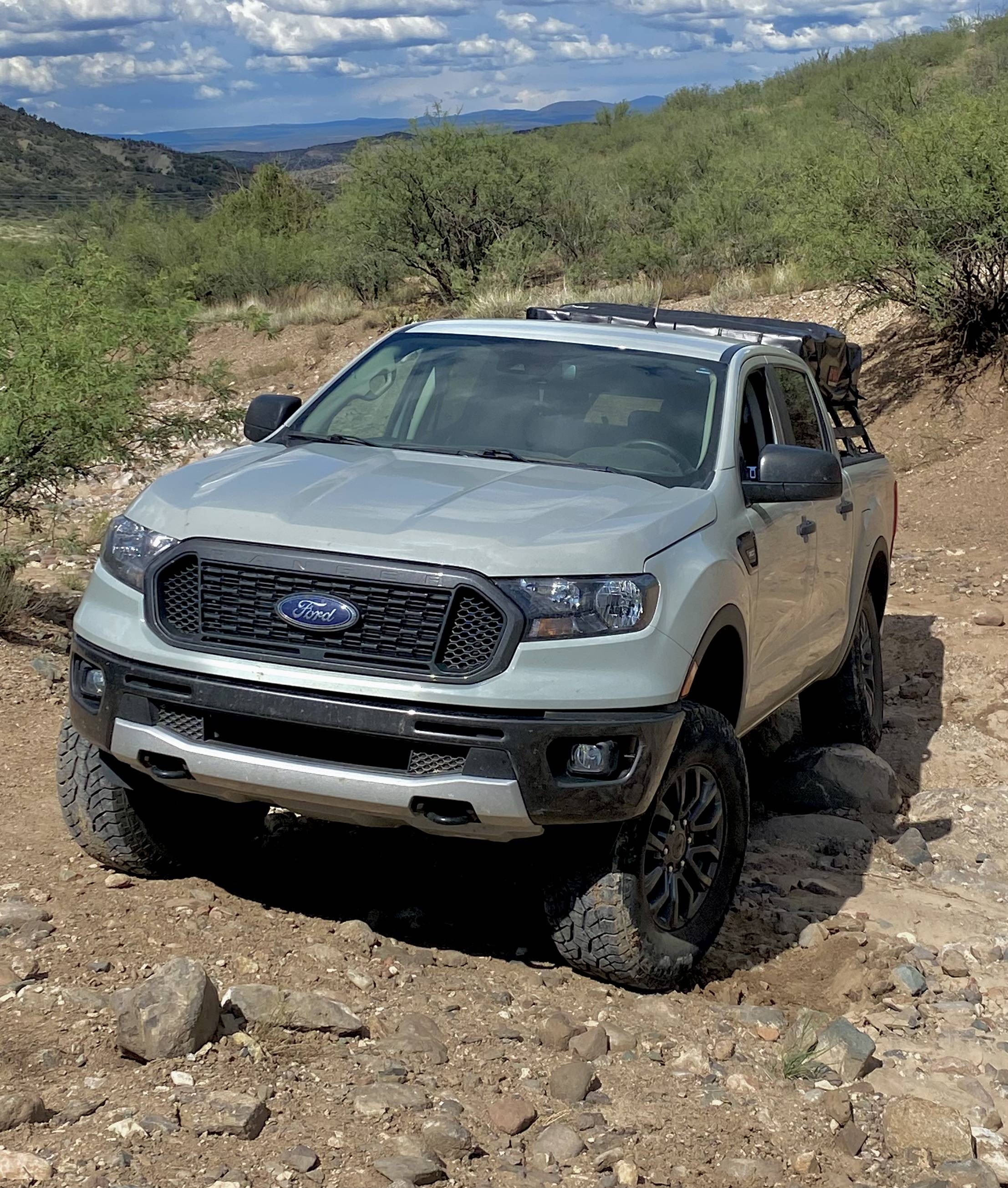

Well I finally got around to putting the 285s on. A nail in the old tires kinda forced my hand.
To my surprise they did not rub on the steering knuckle or upper control arm. So for anyone wanting to keep the stock sport package wheels and not use wheel spacers, the pathfinder All terrain in 285/70/17 will fit. (I have roughly 2” of lift).
Also to my surprise is that I haven’t rubbed on the crash bars yet on the street. But they’re close and will likely touch on articulation.
Overall I am happy with how they look. I’m leaning more towards a subtle truck and keeping the stock wheels was key to that.
