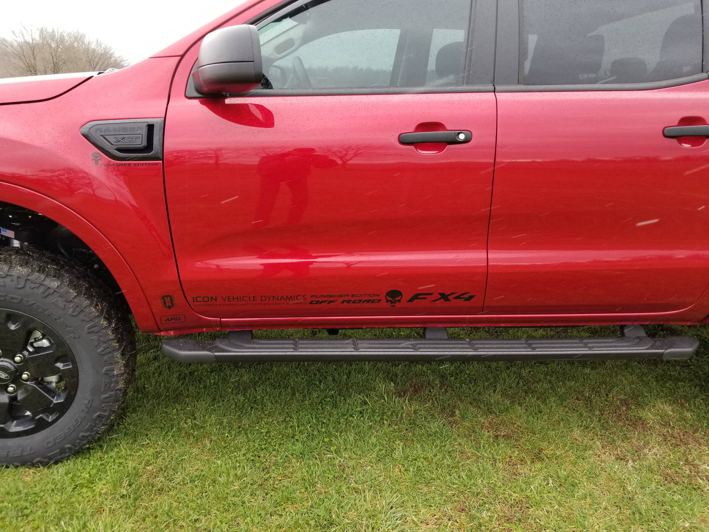

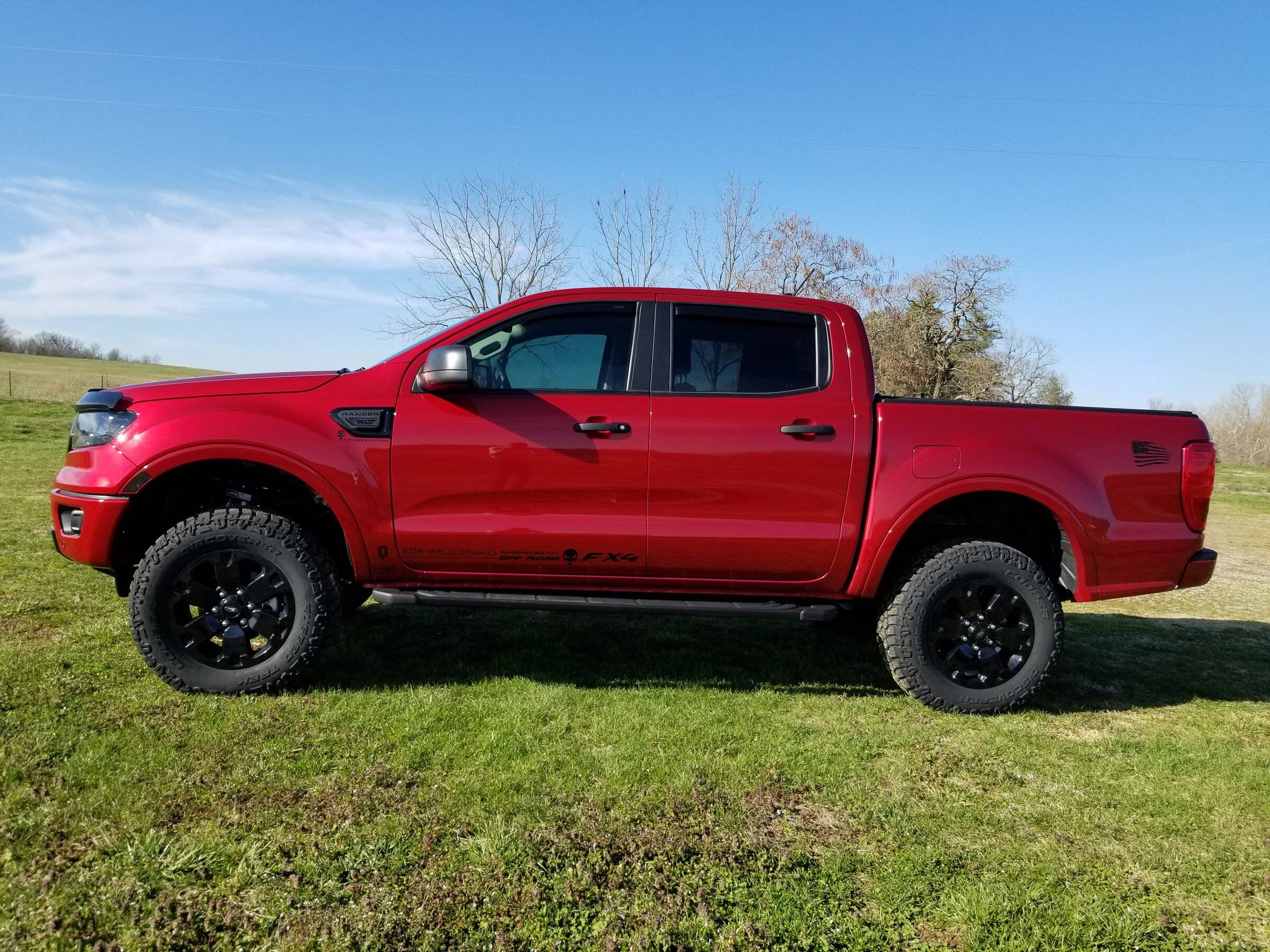

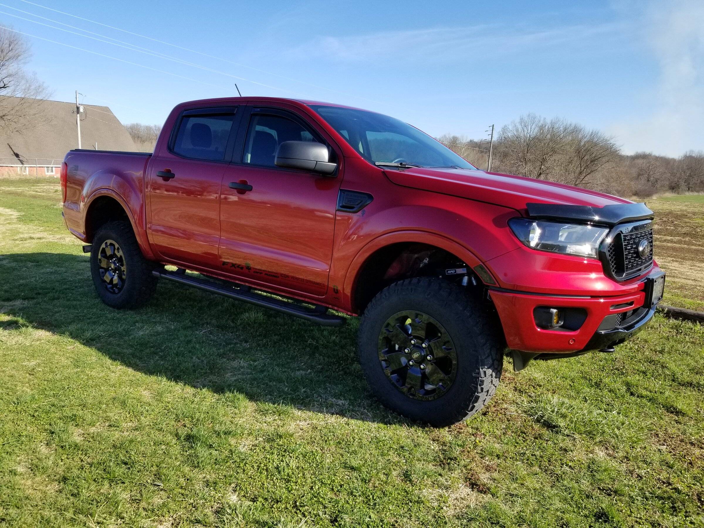

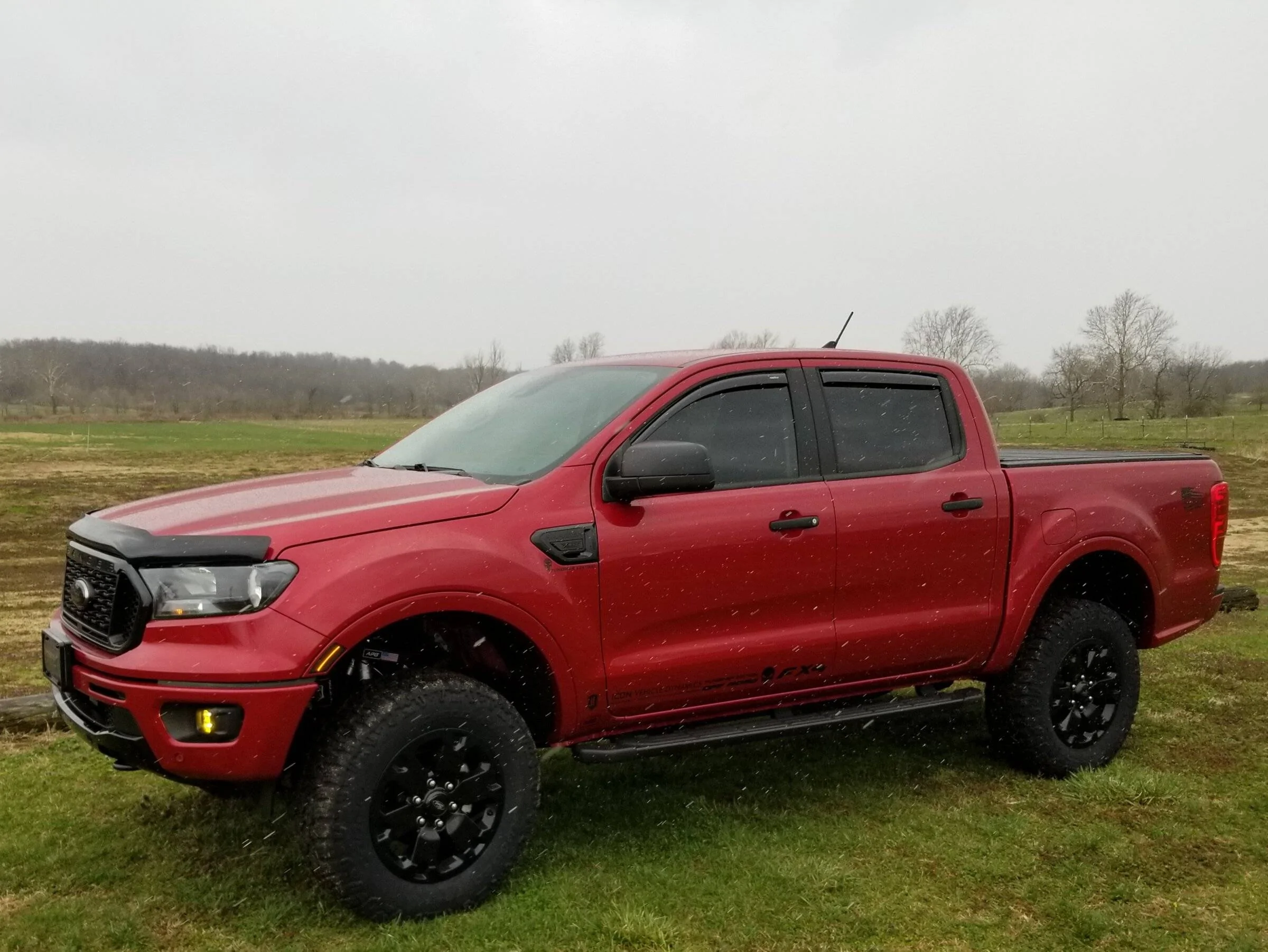

It has been 1 year since I wrote the check and drove my 2021 Ranger XLT FX4 off the dealer lot...(4/2/21)....under MSRP, and paid for...following are a few pics of it now , and a list of the mods I have done so far...

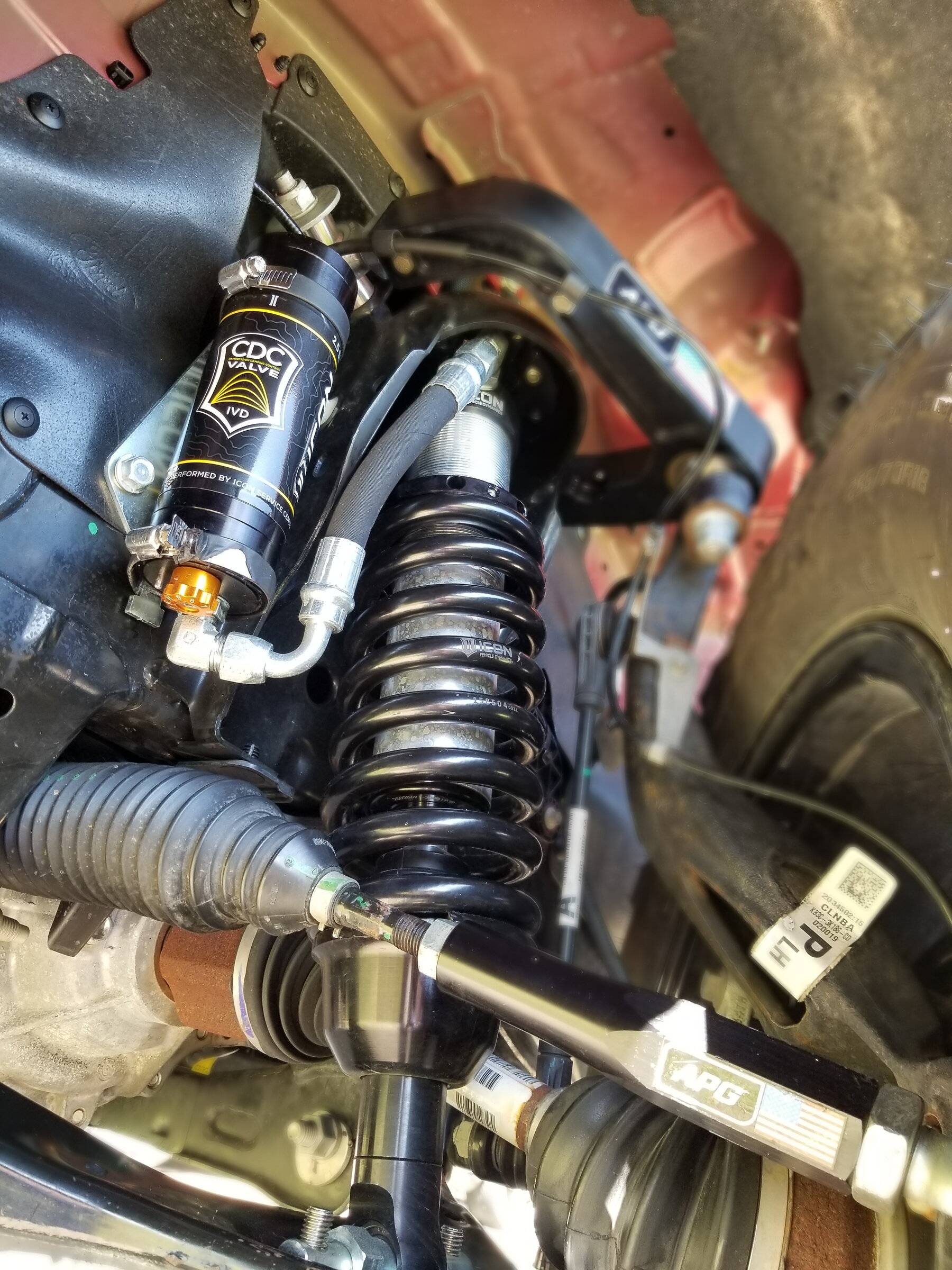

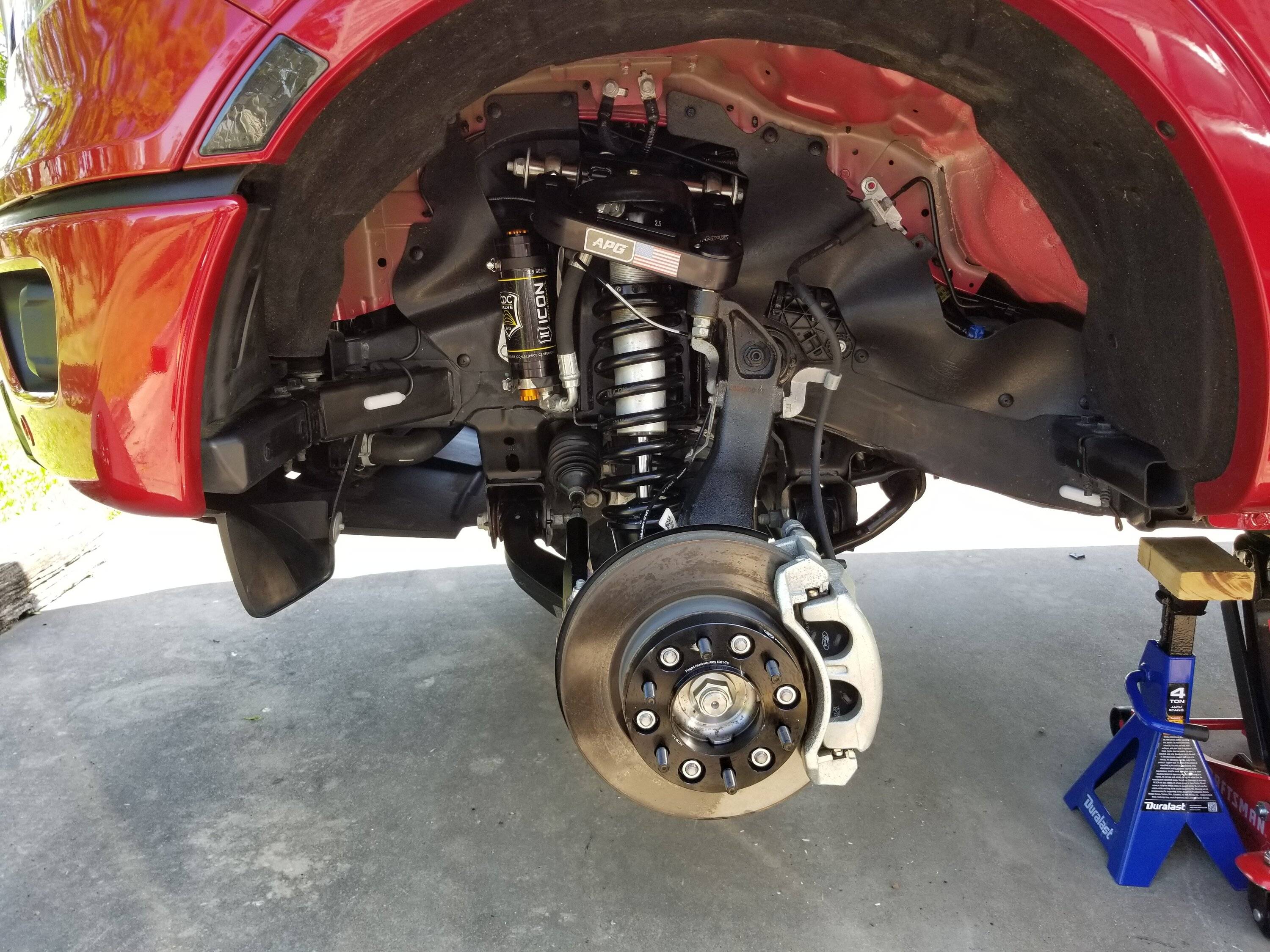

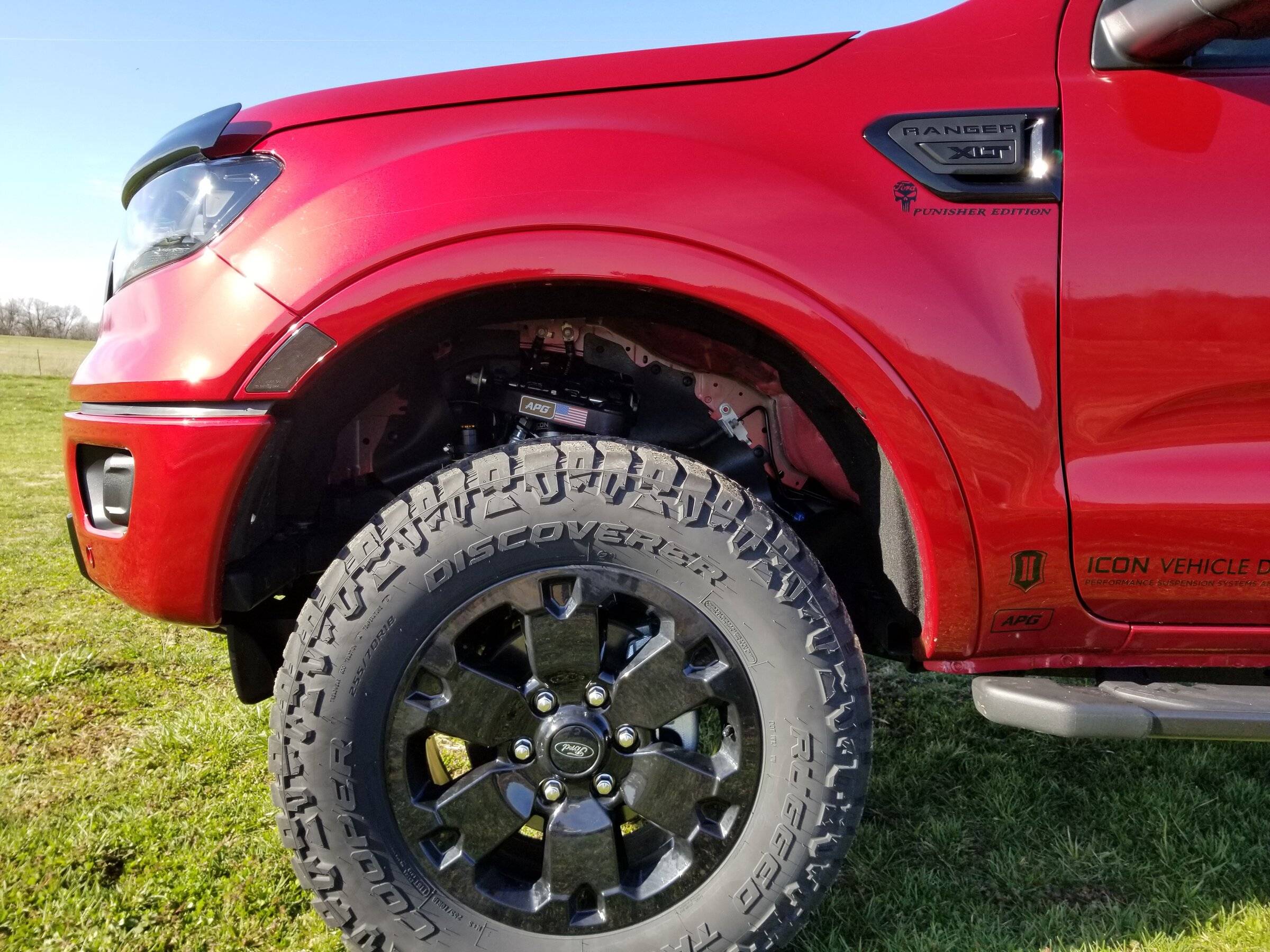

Front Suspension: ICON 2.5 RR CDCV ET Coilovers, APG Billet UCA, APG Billet tie rod ends, extended travel 3.0" lift...

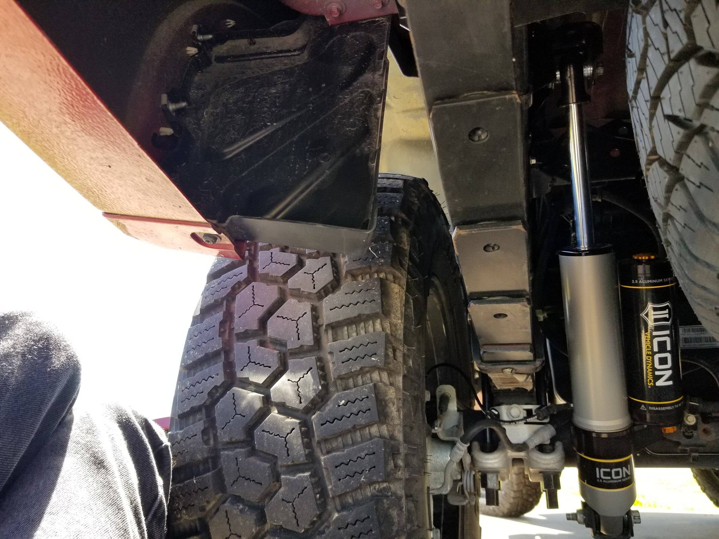

Rear Suspension: ICON 2.5 CDCV Piggybacks, ICON RTX progressive leaf spring pack and ICON foam bump stops.
1" lift...
Wheel ,Tires : Ford BAP 18x8 , Cooper Rugged Trek 255 /70 R/18 XL load rated , 32"

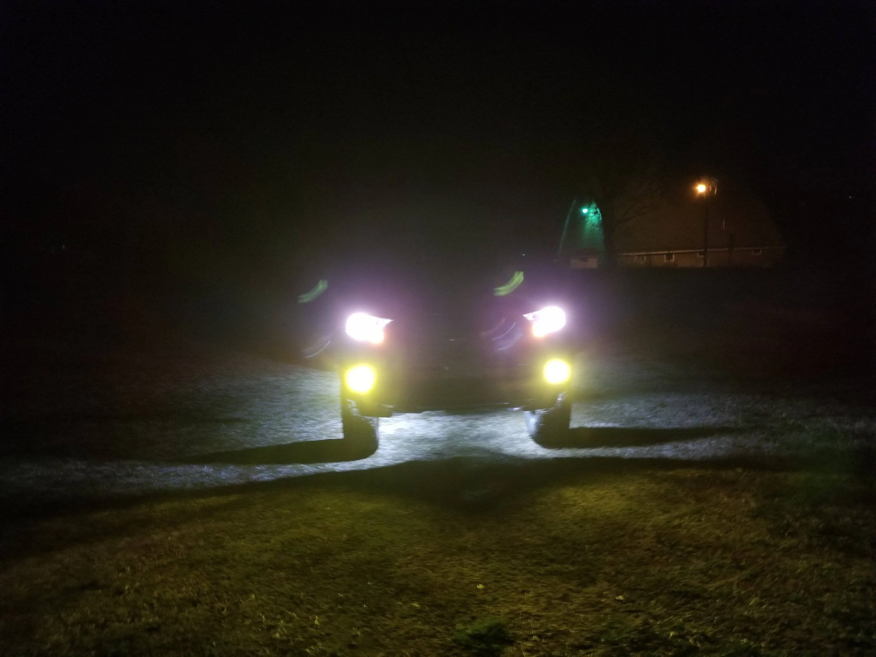

BakFlip MX4 tonneau bed cover, Front side windows 35% LLumar tint, Goodyear wind and vent shade, AVS clip on hood bug deflector, smoked lens LED front fender marker lights, DD SS3 Pro yellow fog lights, vinyl front vent, rear bedside and rocker panel decals...
All installed by 63 year old man , outdoors on a concrete parking slab...?...Up dates on any future mods when they happen....

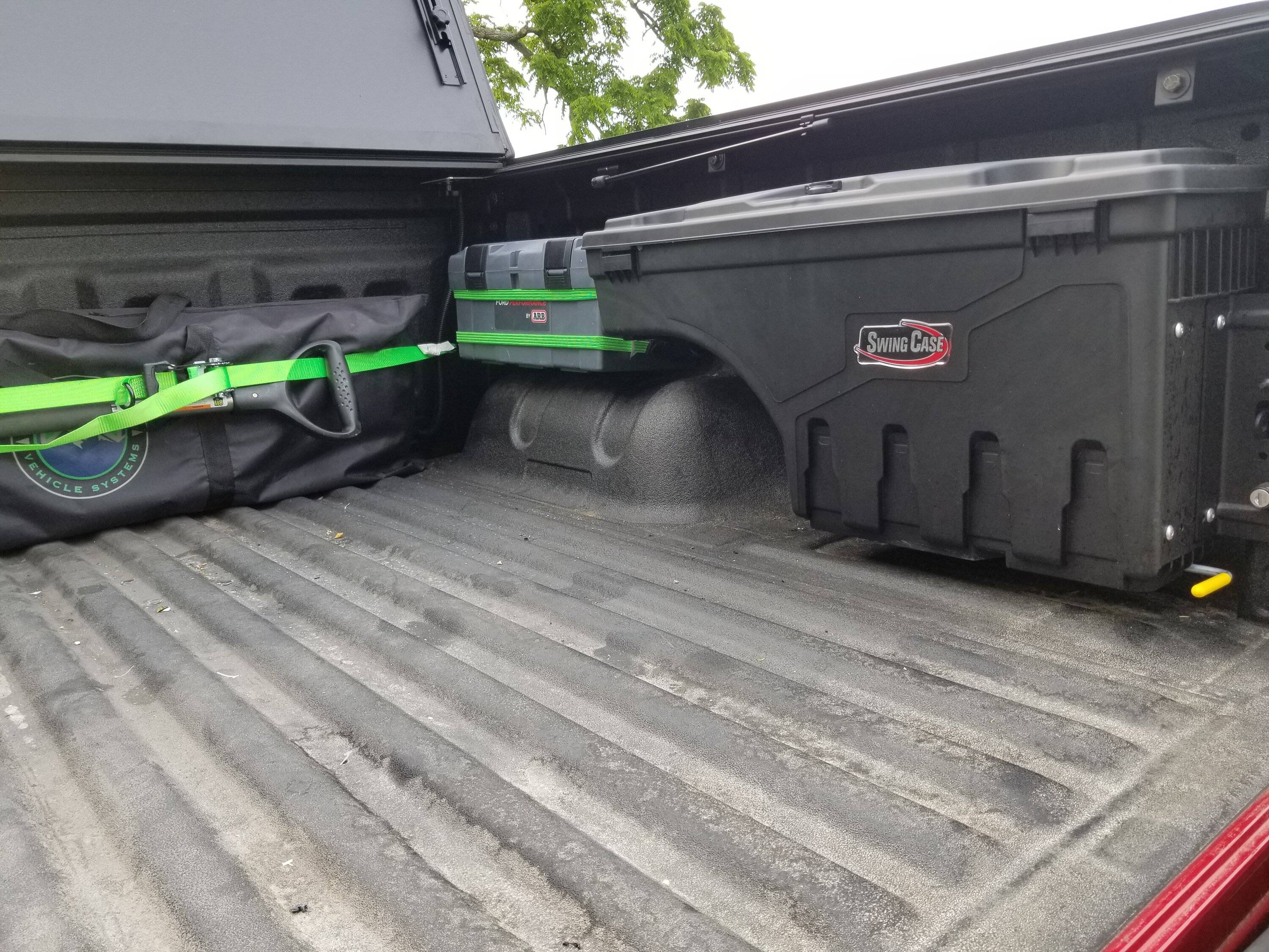

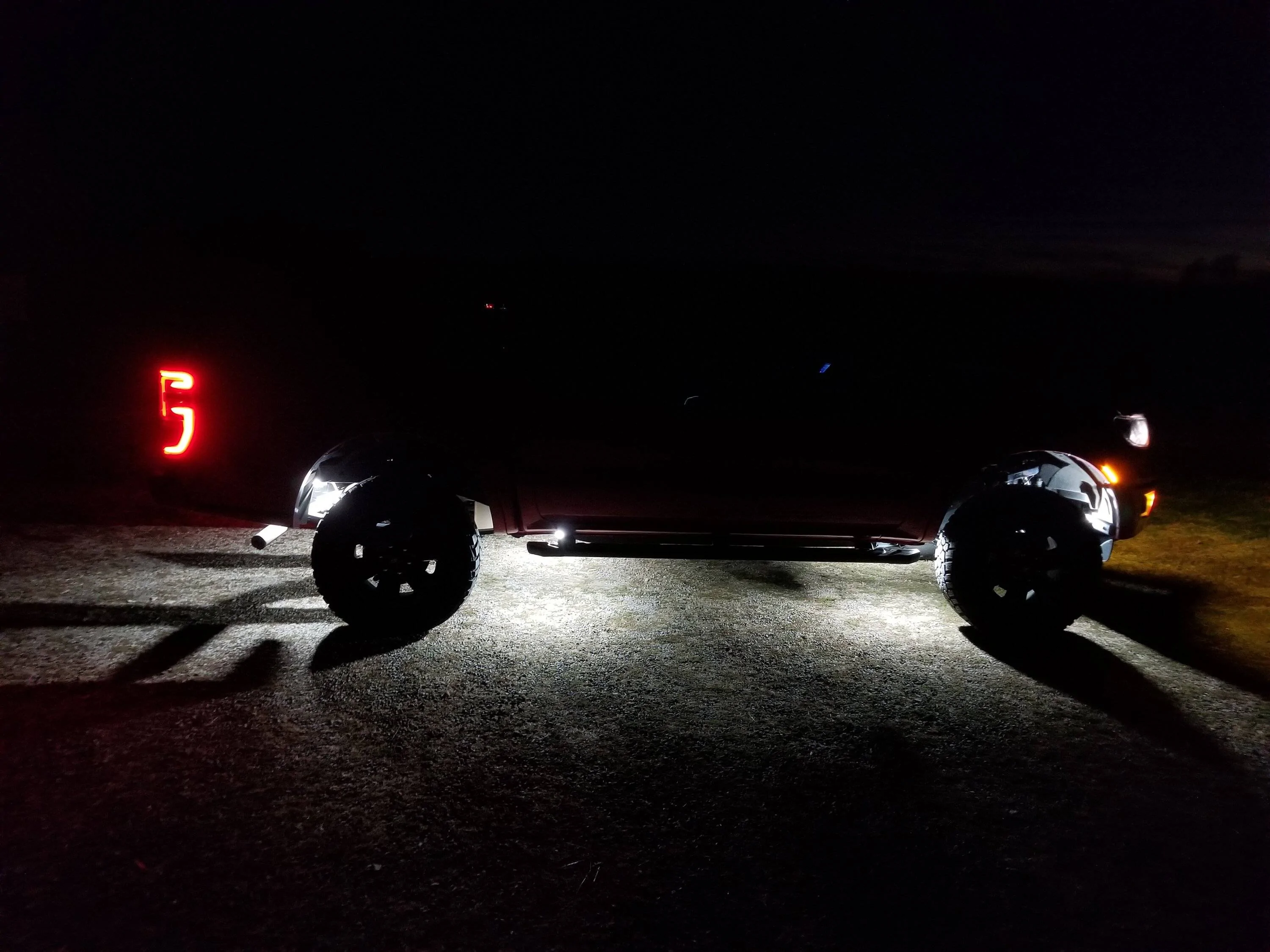

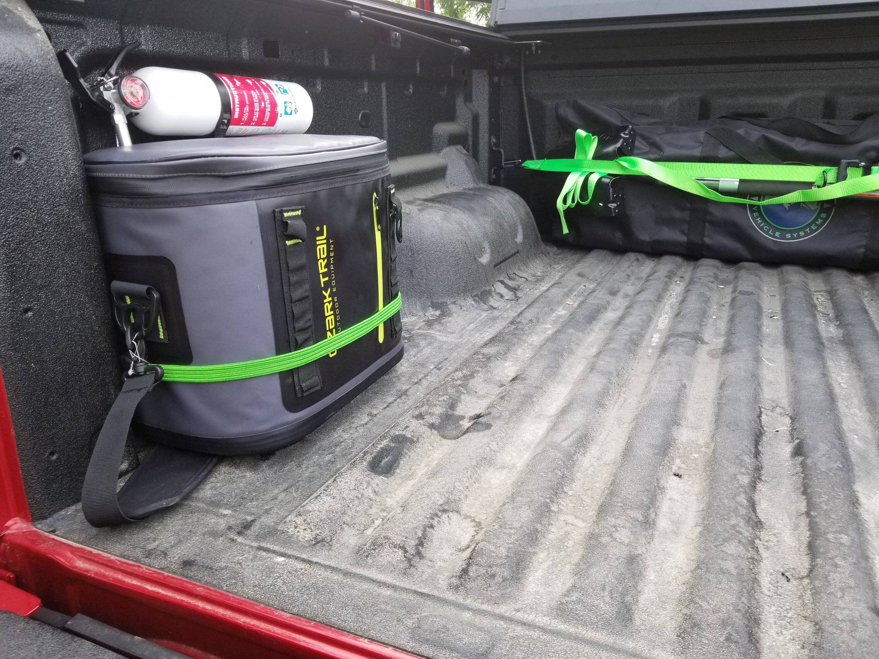

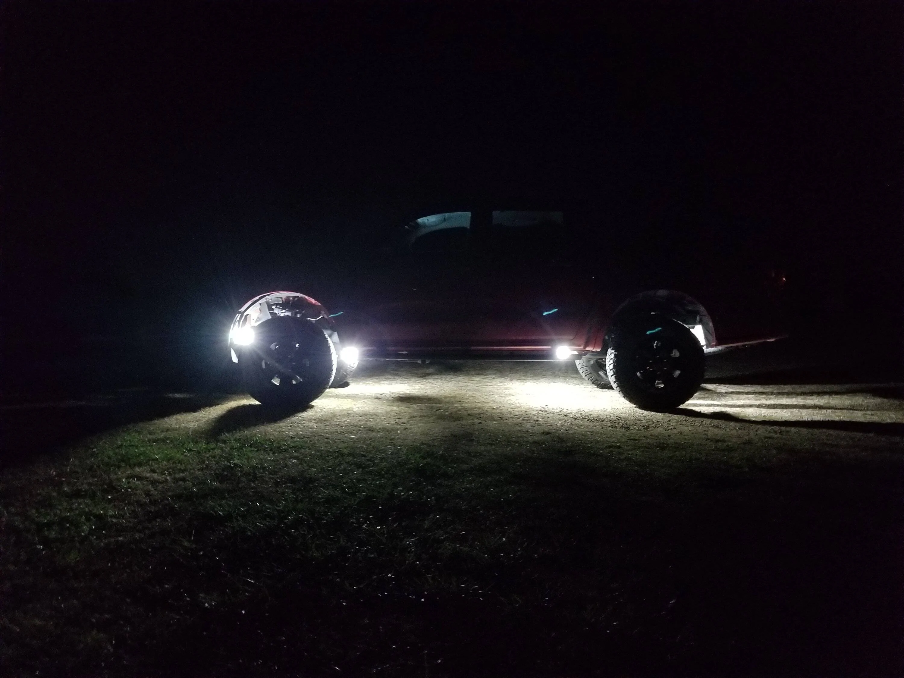

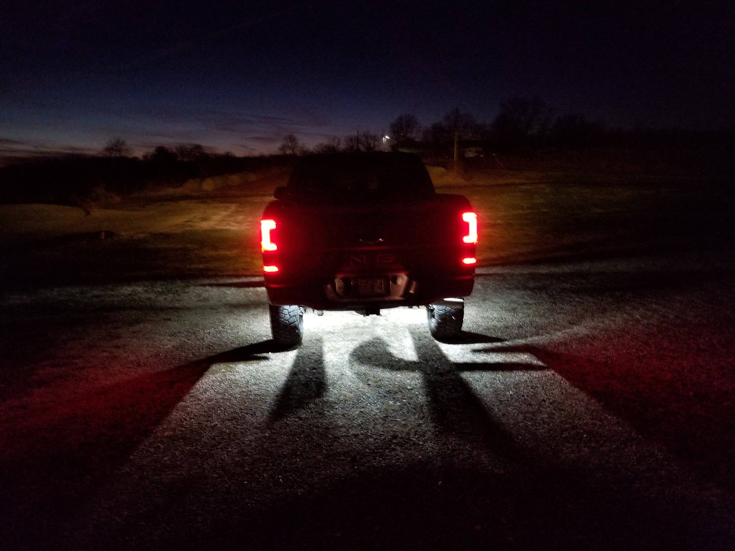

Bed accessories for offroad day trips, and Lux rock lights for bro-crawling malls...
Swing case, ARB Ford Performance portable 12V air compressor kit in a box, Overland Vehicle Systems recovery boards, Kobalt shovel, Marine/Auto fire extinguisher, cooler.
8 Lux LED white rock lights, Lux rocker switch, Lux Pro installer box for Spod systems...I don't have auxiliary/ trigger on my truck , so I had to add the inline fuse and do a little extra wiring myself...

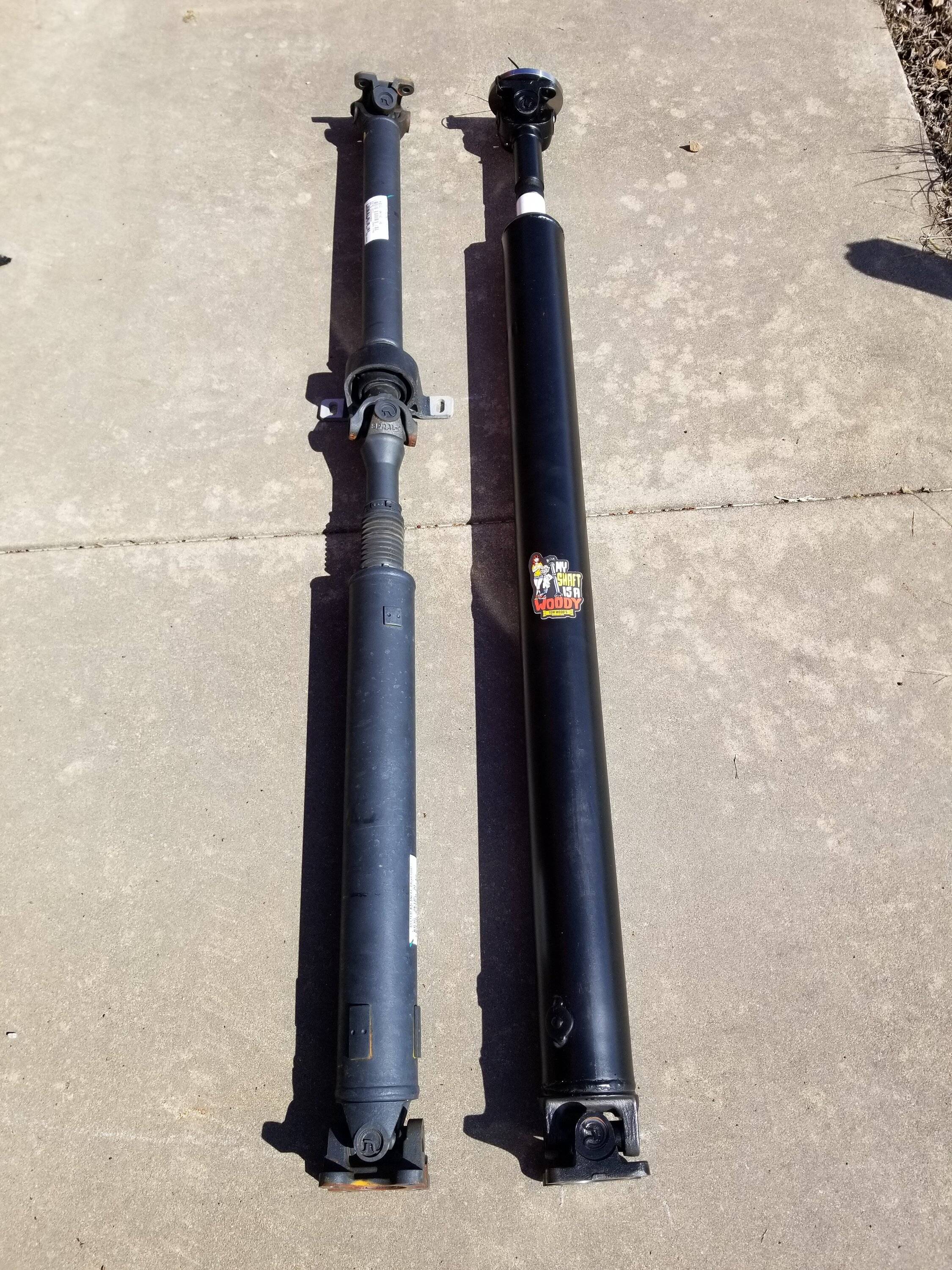

Update for the last couple mods I did back in April before celebrating 2 years of ownership....

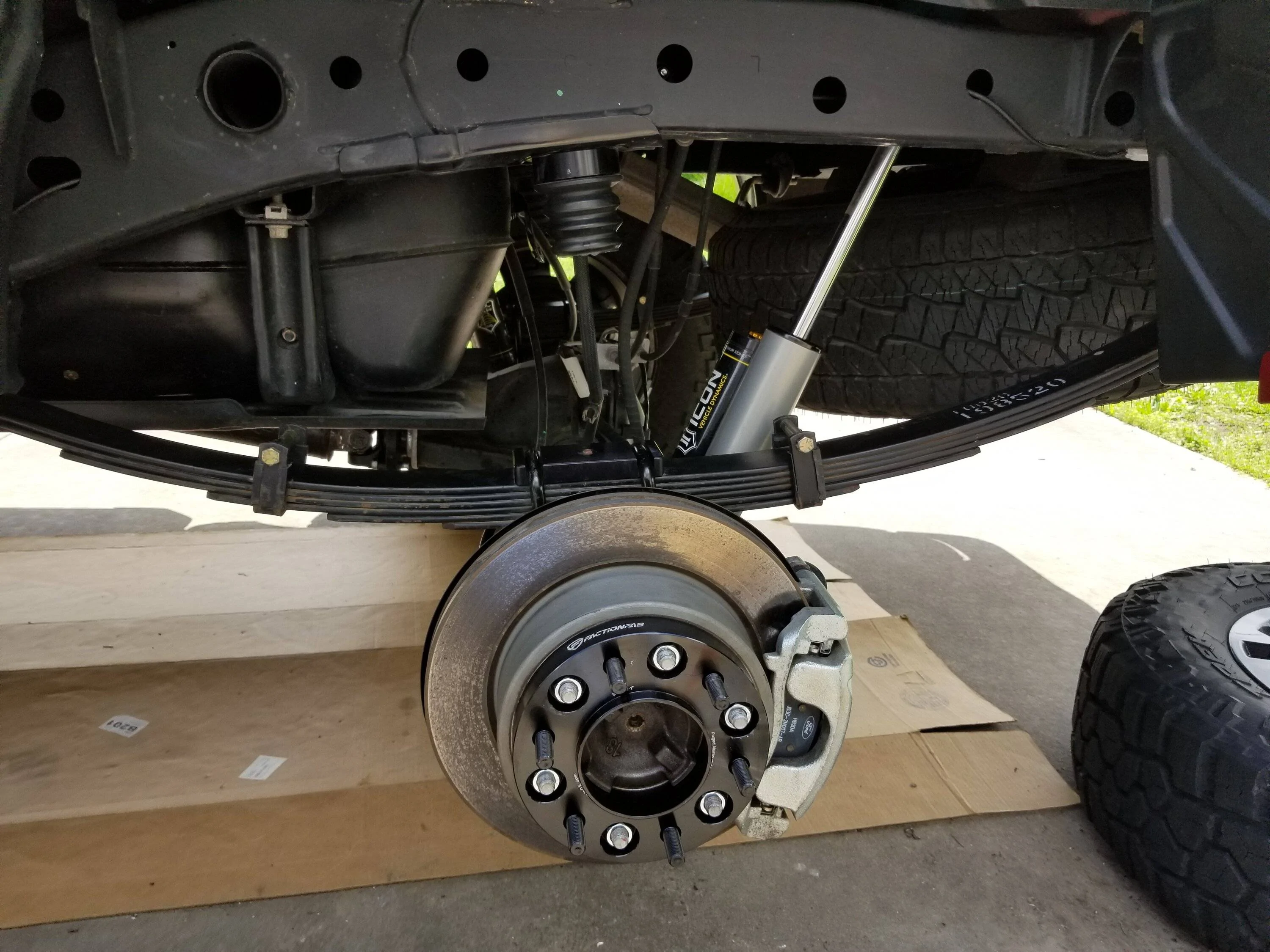

Tom Woods 1 piece drive shaft. I also added a 5° shim to get the Pinion angle to 0.4° lower than the transfer case output flange, to allow for axle wrap.... I did it because the stock 2 pc.
was making the whistle/squel sound of failure...was worth the $$$ and effort...vibrations at highway speeds completely disappeared....
I also added the Faction Fab Billet 1.0" wheel spacers...used my Stage3 Motorsports rewards points to get one helluva deal. ( Thanks Frank ) This was done for future tire and wheel combo options....I like my current skinny 32" tires with the Ford BAP wheels...but with the 55mm offset it looked like my truck skipped leg day..Kind of digging the 2" wider, more aggressive looking stance...
