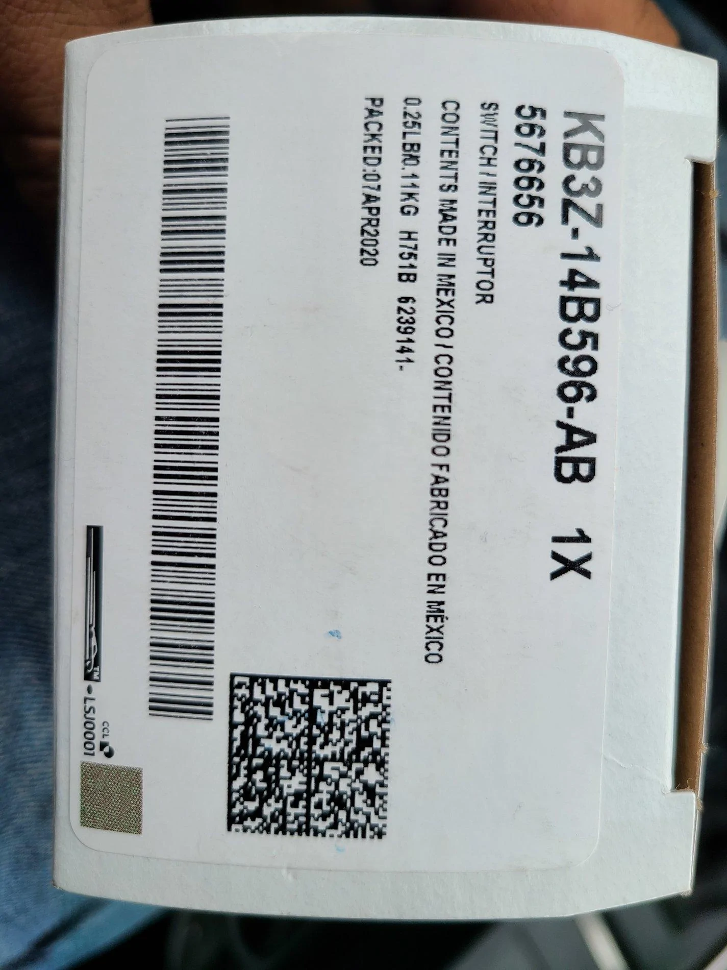

So my dad ordered all the parts from this thread... The parts guy told him it was on the steering wheel, and he needed different part numbers for the center console. He elected to ignore the parts guy and ordered the (correct??) part numbers.

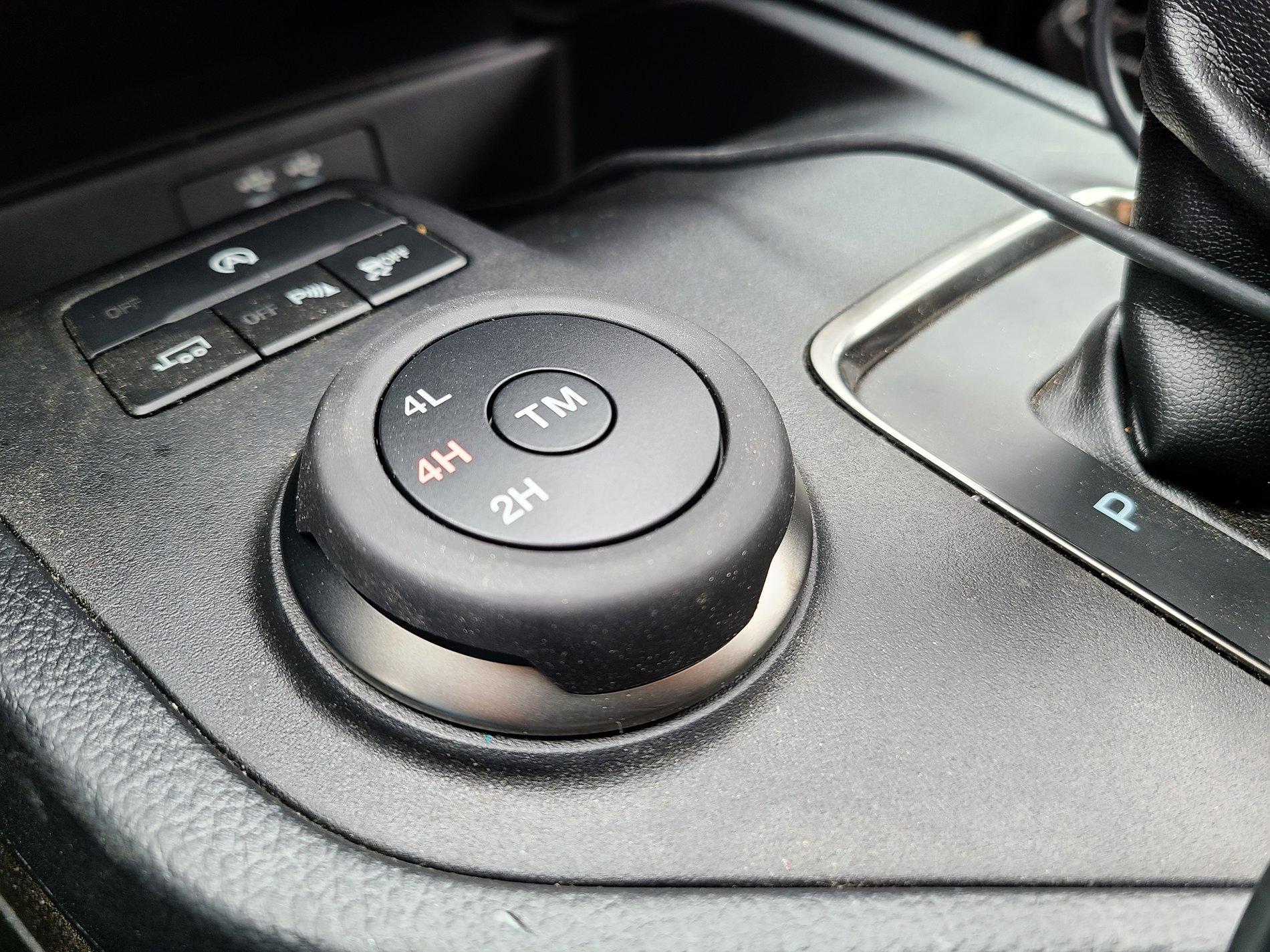

Are you trying to remove the entire center console, or just the part with the 4WD knob and buttons? That part just pries up, starting at the seam with the cupholders.

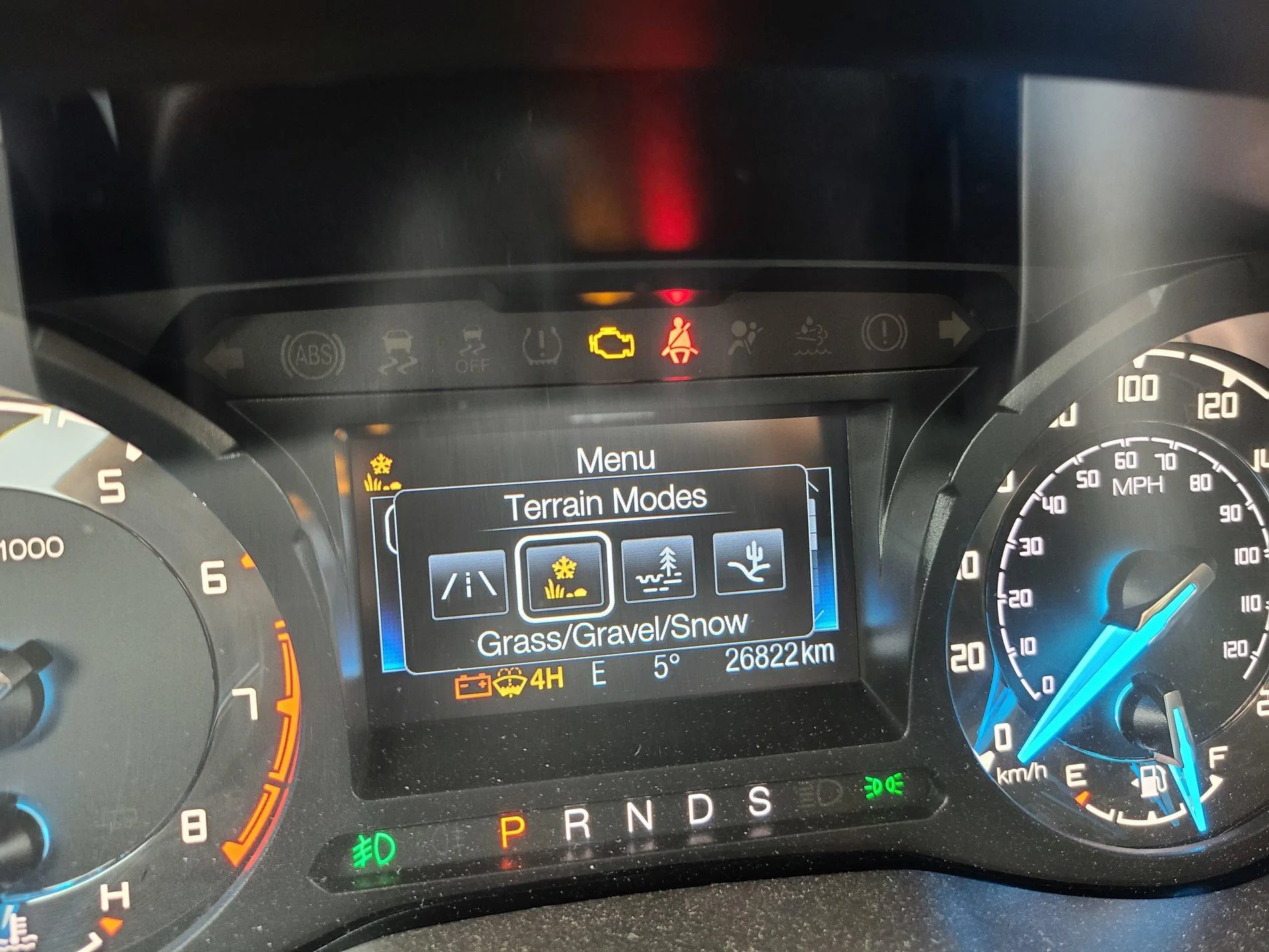

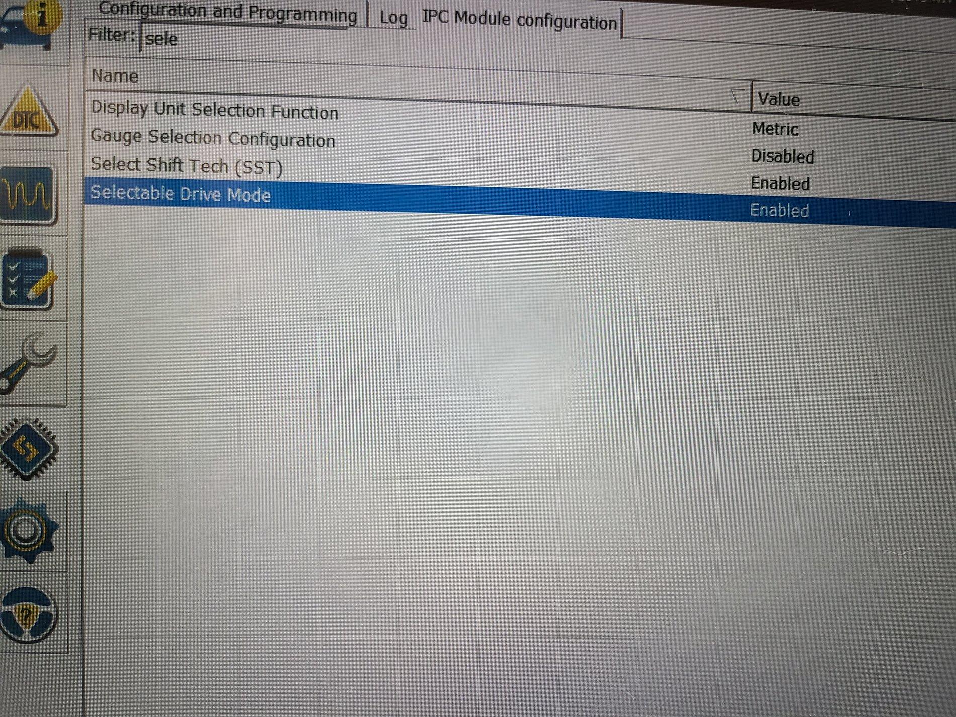

Got mine from the dealer today. Quick easy install, just enabled selectable drive mode in IPC and it worked. Nice trim upgrade as well, looks better then the plain black plastic one.

Does the entire center console need to be pulled to get at the switch?
