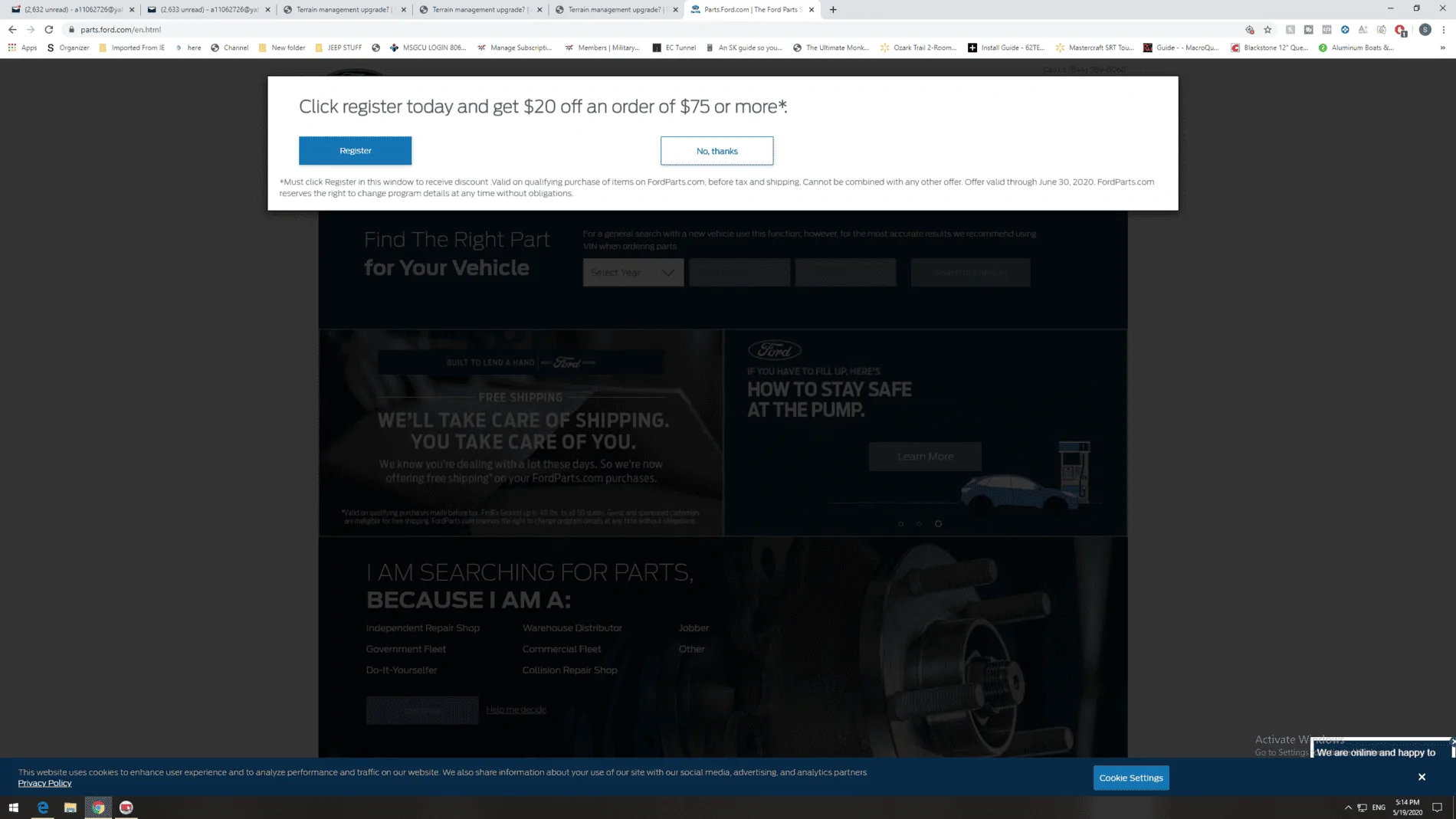

go to parts.ford.com . You should see a pop up that tells you can the $20 off when creating a new account
Interesting I'm not seeing it, maybe it was a one time thing?
