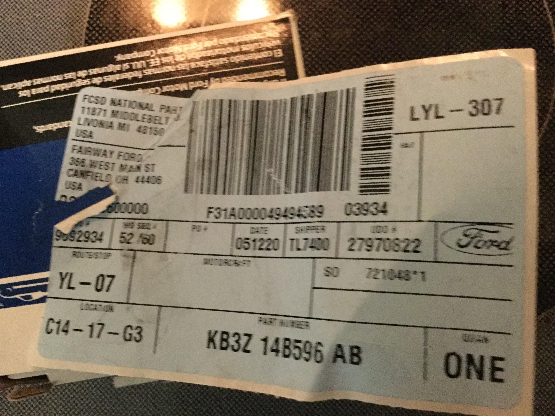

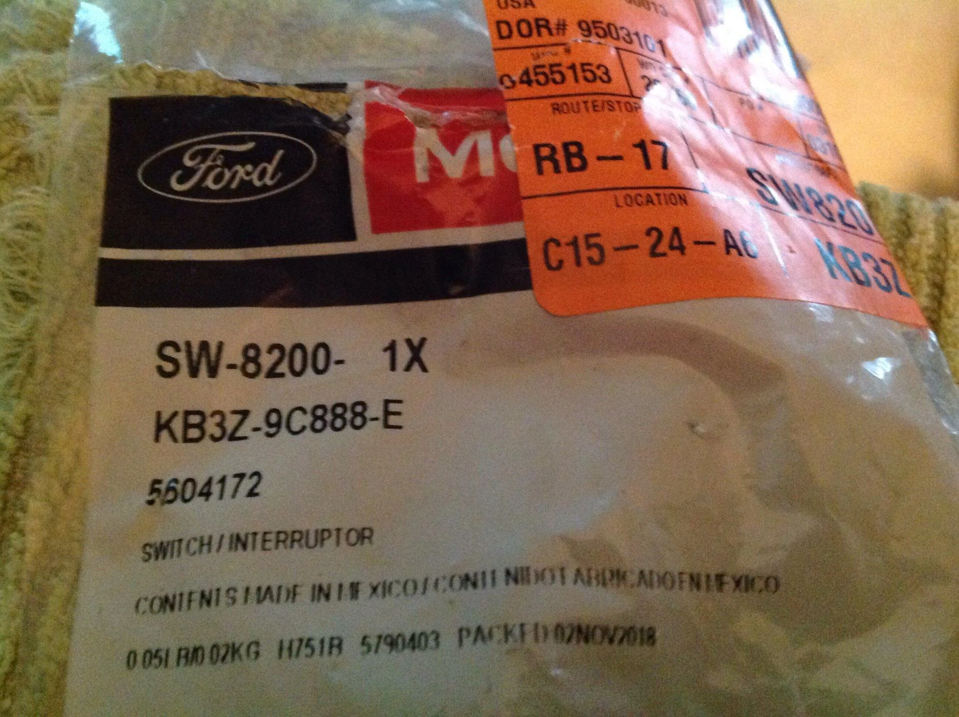

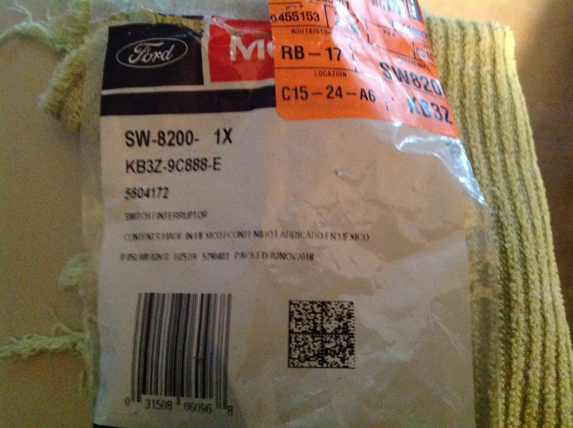

I installed the terrain management switch today and then went into forscan IPC and enable selectable drive mode. It works excellent. Now I need to find out how to activate trail control so The Cruse control will work with trail control and terrain management.. Hear is the part number for the terrain control knob.

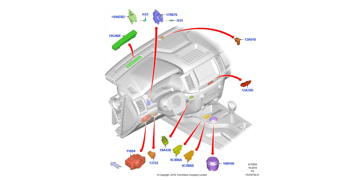

Thanks for posting the part numbers. Just ordered both parts. $80 shipped so not too bad.
https://parts.ford.com/shop/en/us/switch-assy-control-9343073-1
If you go to the above link and then put in 2019 or 20 ranger the graphic will come up and you can select any of the parts needed, not just the 4WD knob.
