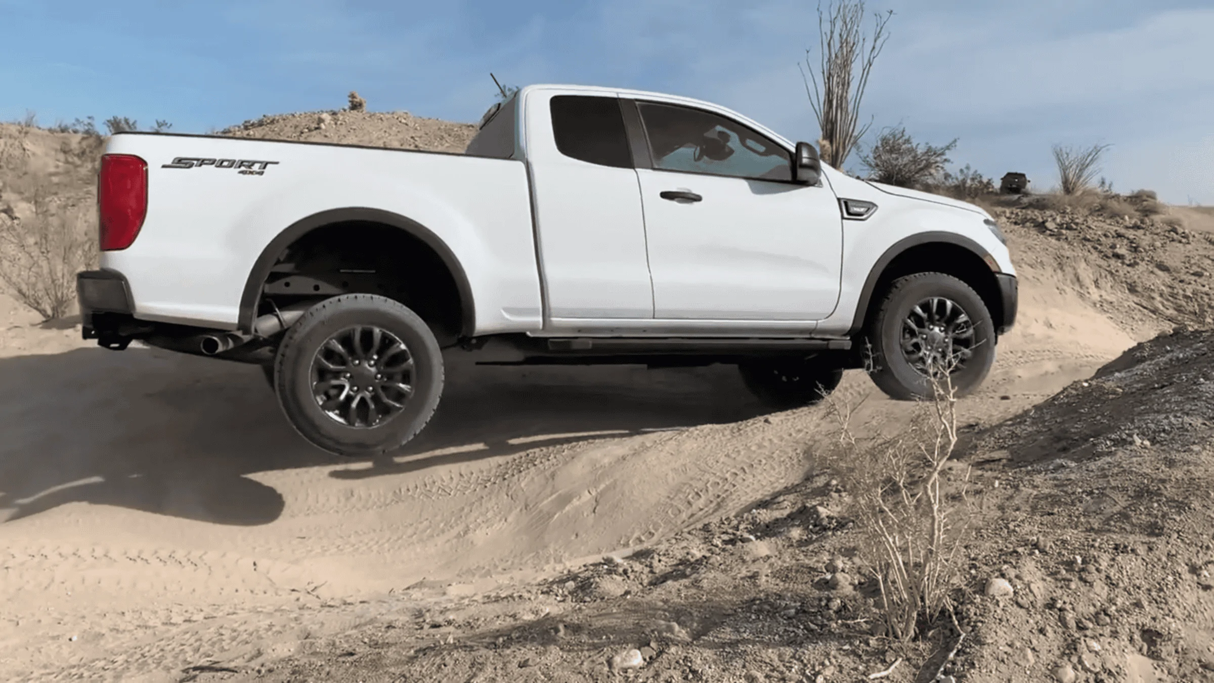

I ran them all at silver lake sand dunes, I was able to climb the big ass dunes with sand mode on stock tires with 45k on them. I have an xlt fx4 with fox 2.0” level only. I am 100% convinced it’s not a gimmick as I was going places in the sand where big ass built jeeps weren’t able to follow. I also use grass/gravel/snow mode a lot in Michigan, and it really helps keep you from spinning tires. I really wish that you could decouple the drive modes from the 4x4 though as I would love to run the grass/gravel/snow throttle map all the time.

I ran it every way I could, the sand mode was noticeably better that any combination of locker on/off and every other mode.
