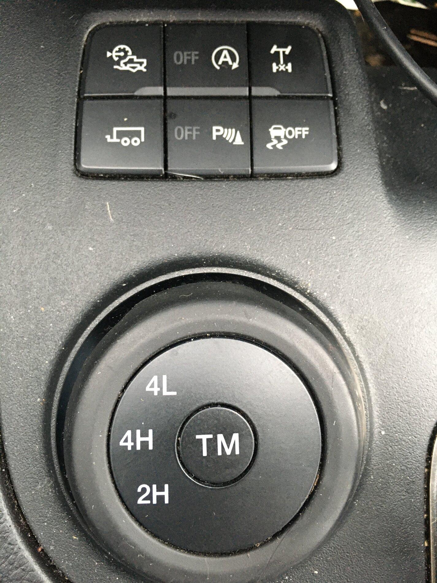

I was wanting to upgrade and add the TM 4x4 switch and have a good idea how to do that. I also want to upgrade the TC switches as well but

my truck only has 3 buttons now. The top one is auto off\on an the bottom 2 are one for trailer and the other for traction control
Yeah, you would need to buy the buttons which are rare now. And you would end up with one to control a rear locker which you don’t currently have.
we haven’t figured out trail control yet, but the terrain management button is easy to do.
the terrain management button is in the middle of the 4x4 knob after you do the install and doesn’t mess with the other three buttons.

There are a bunch of different switches. Sw8200 SW8197 SW8198 for the top set and SW8196 SW8199. Not sure which ones to look for.

Kb3z-9c888-e from your picture is the button set that replaces the 3 you mentioned. It looks like this minus the dirt when you’re done.
