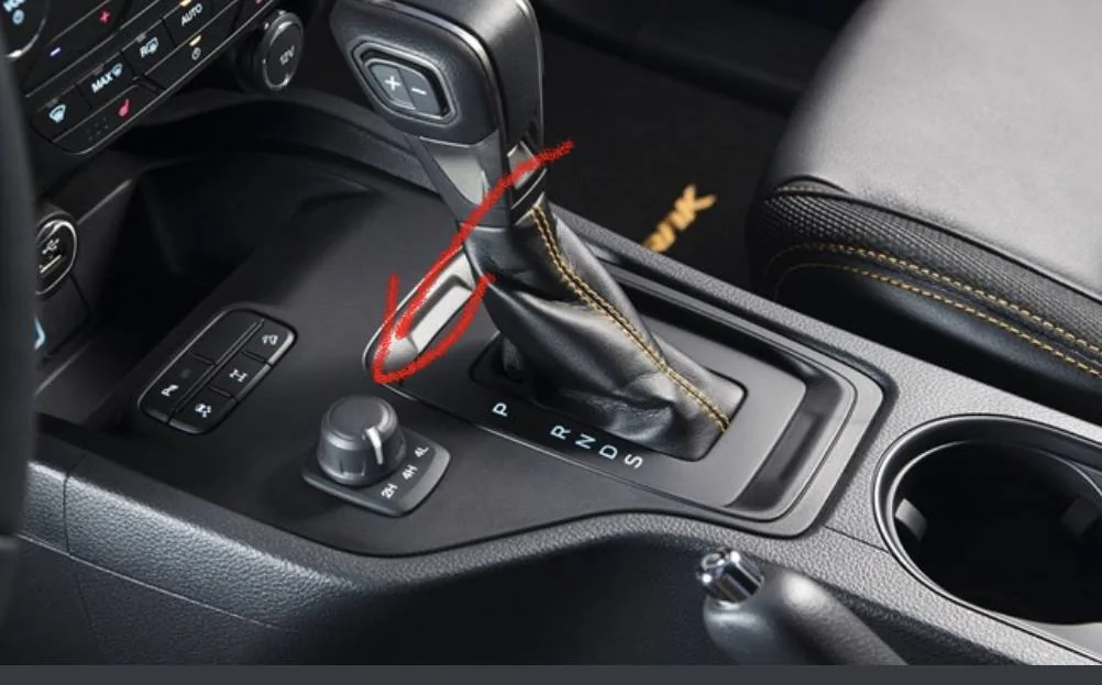

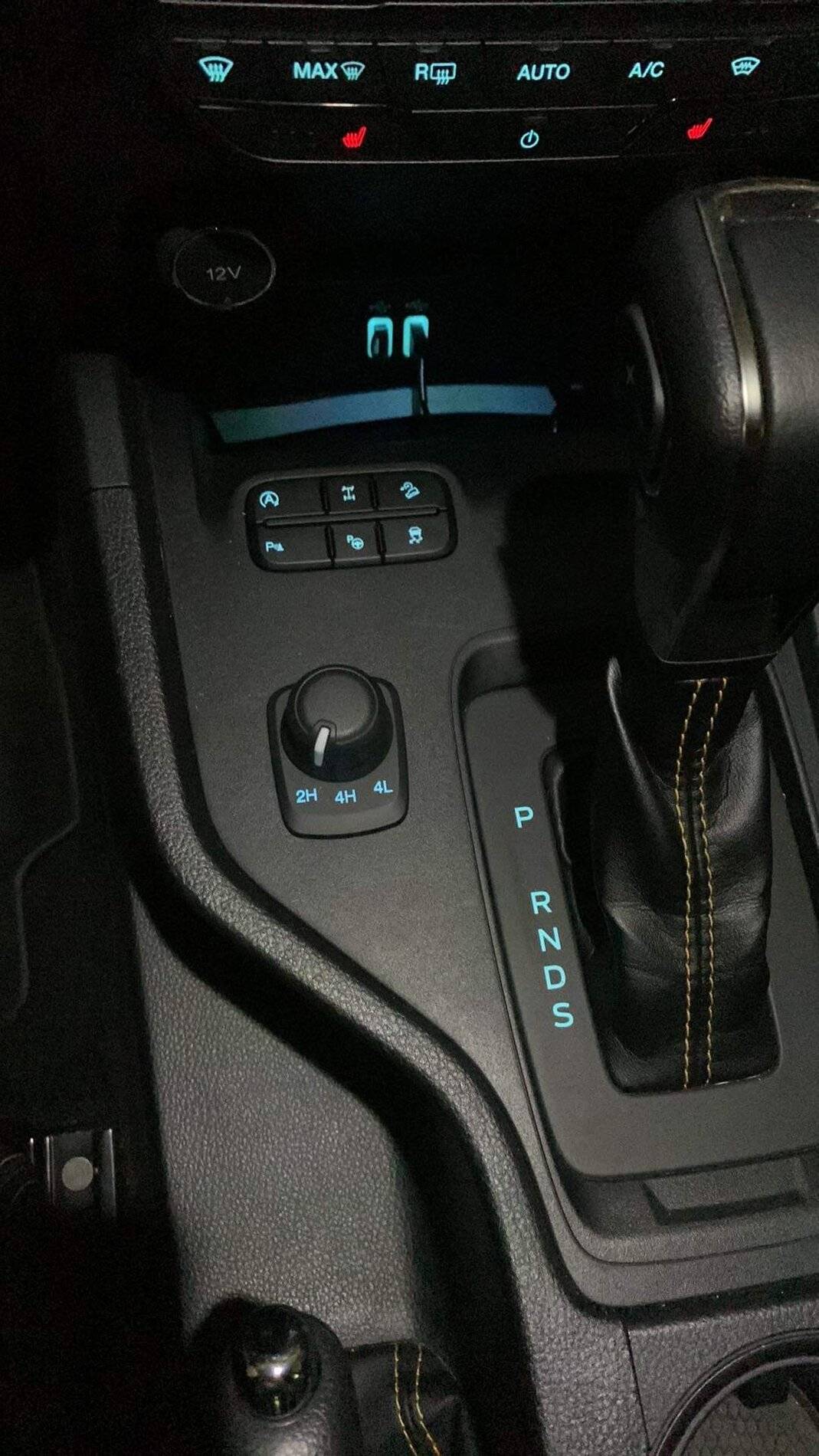

Hi guys!!I made all the necessary changes via FORScan (selectable drive mode - enable)but I have no way to activate the terrain management because my knob is different in ranger..is there any other way to enable this feature?
Pasparakis
Pasparakis
Sep 16, 2021
Greece
Ranger wildtrak 2.0 biturbo 213ps
6 months

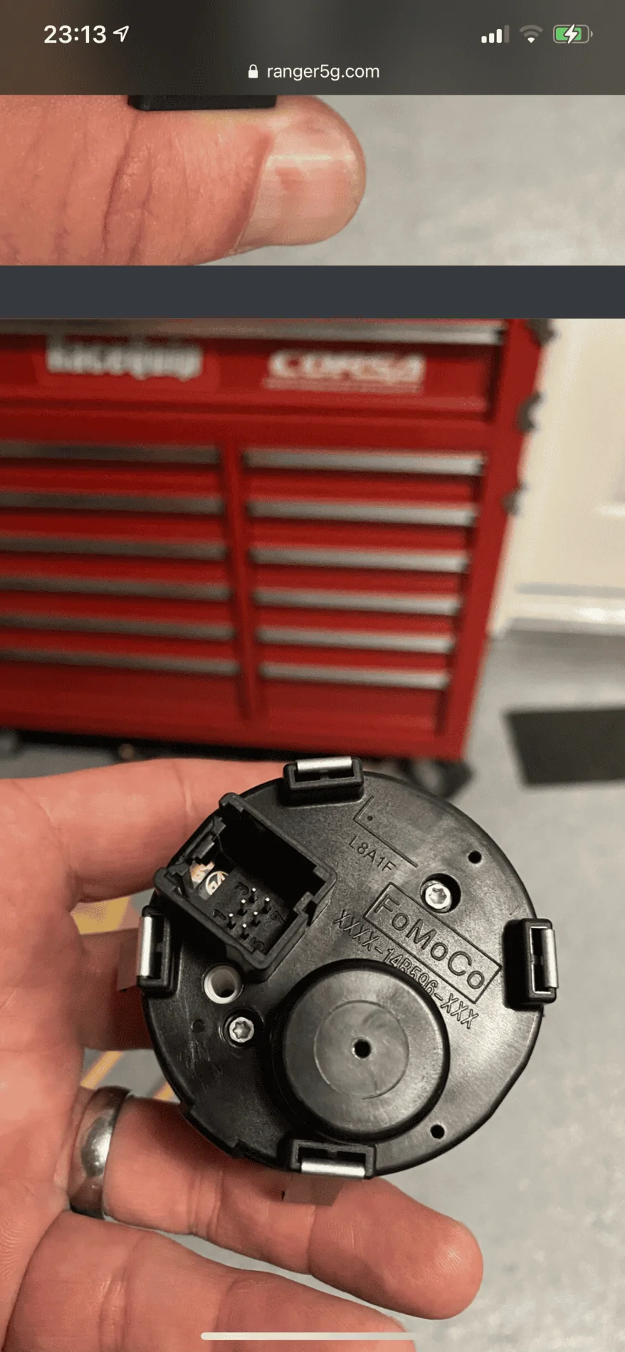

if I replace the knob there is a problem with the connector in back side ..

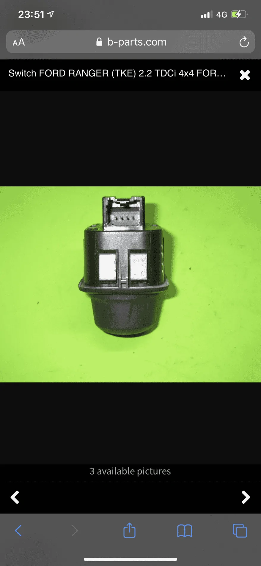

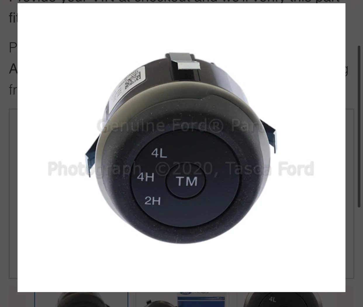

You have a completely different one than most of us on here. Your best bet is to find a ranger with the terrain management where you live, find the part number for the switch and then buy the switch from your dealership(if they let you).

unfortunately in greece all knobs in all models are the same ..
