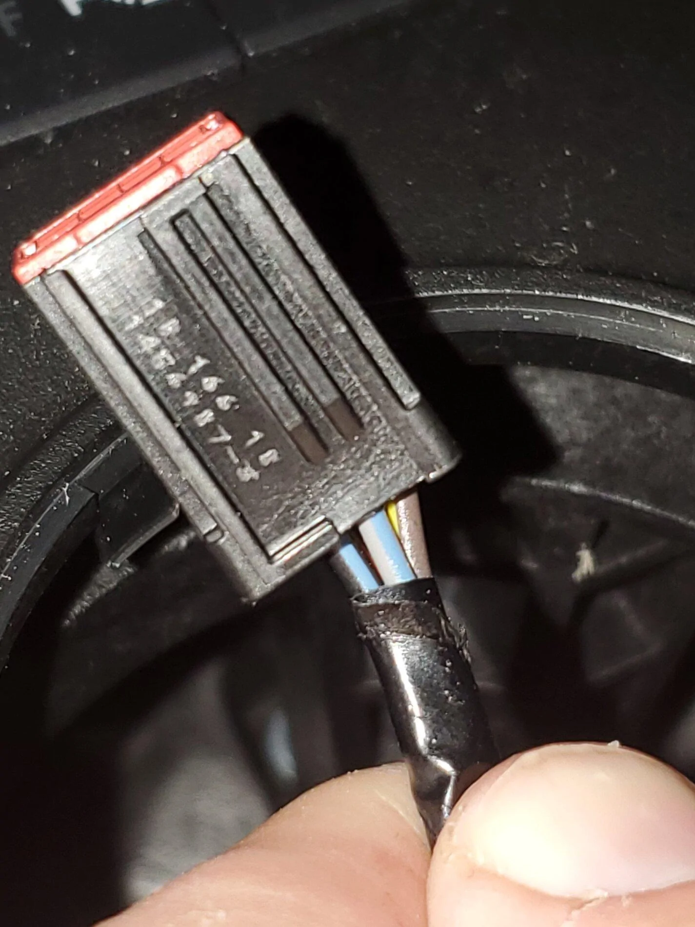

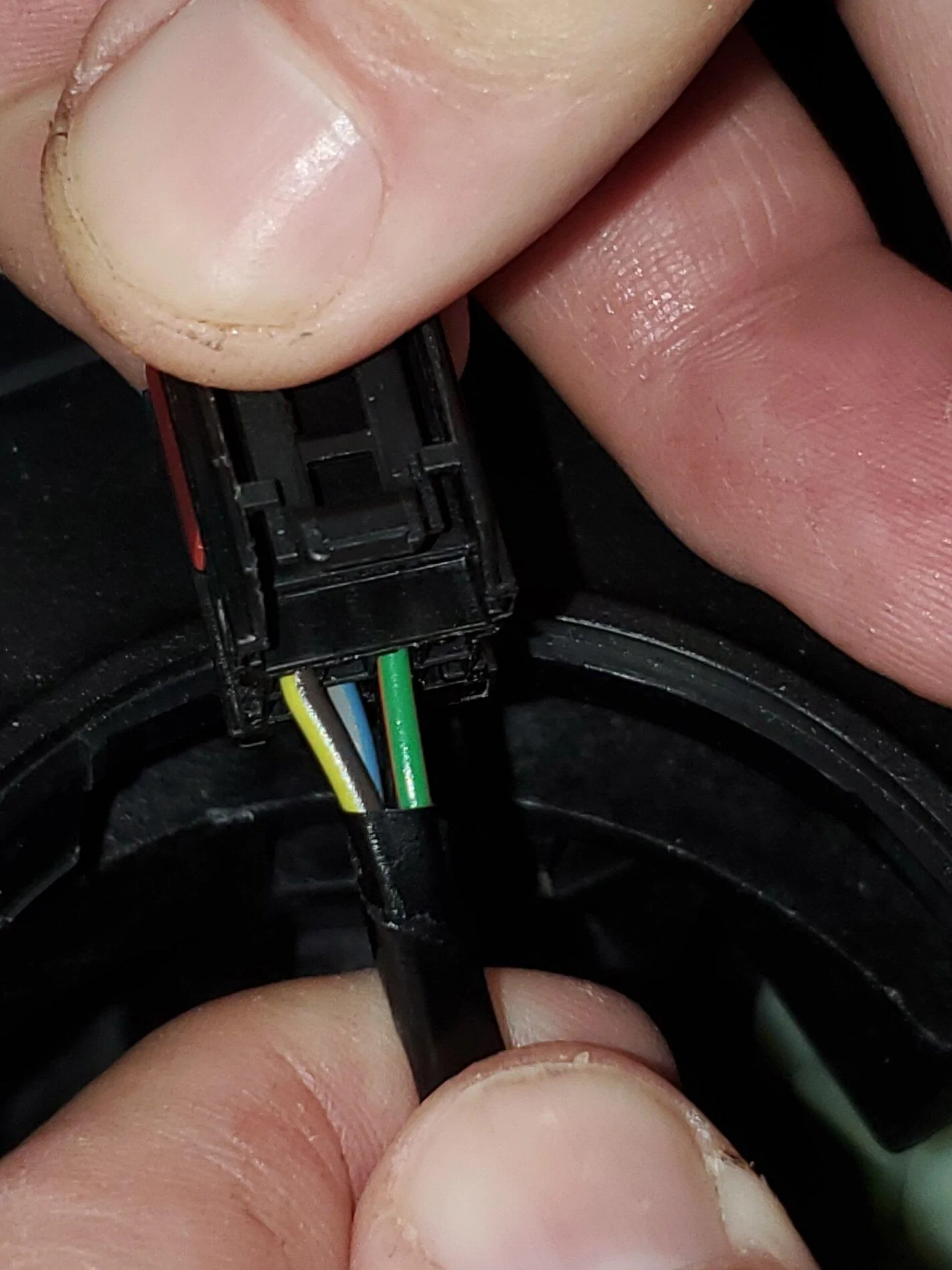

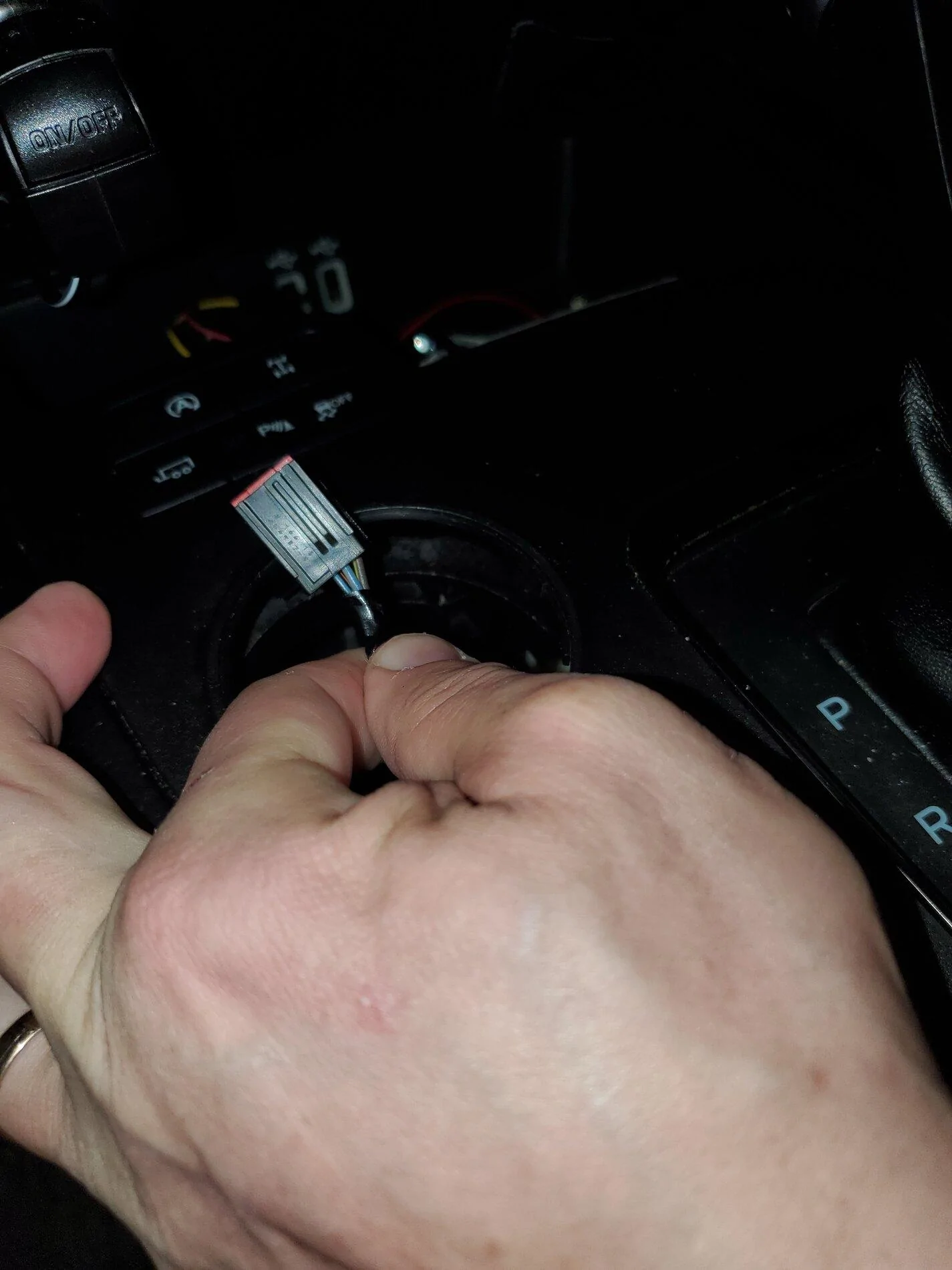

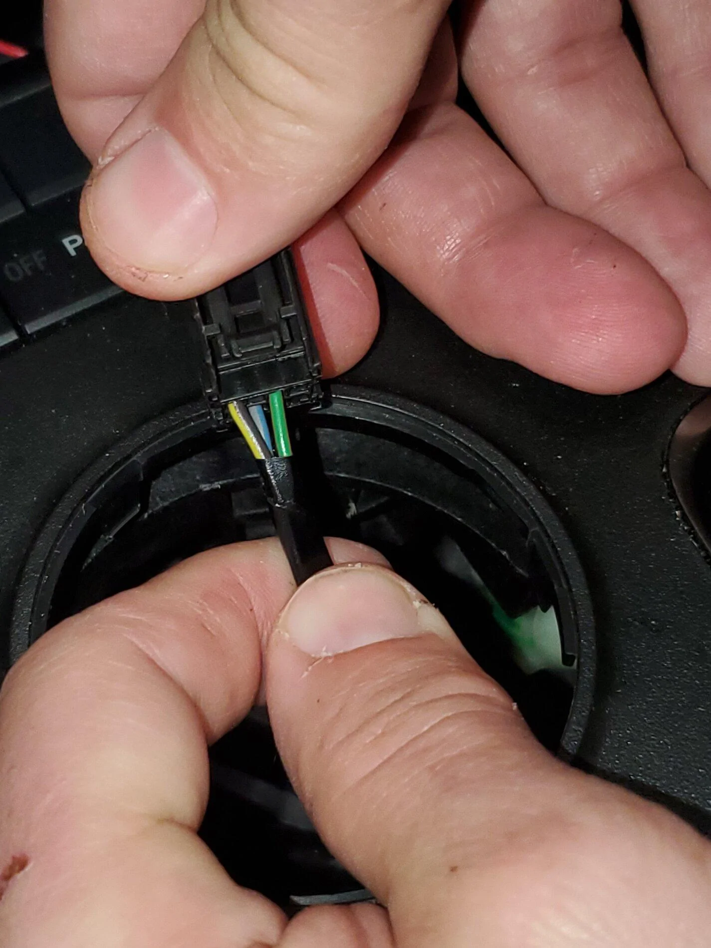

@Michael Crowe Have you pulled the switch out to look at it? Maybe they went sneaky and disconnected a wire or two for the TM part.
Michael Crowe
Michael
Jan 30, 2020
35
30
2019 Ranger 4x4
Can some send me a picture of the connection so I can compare wires.
