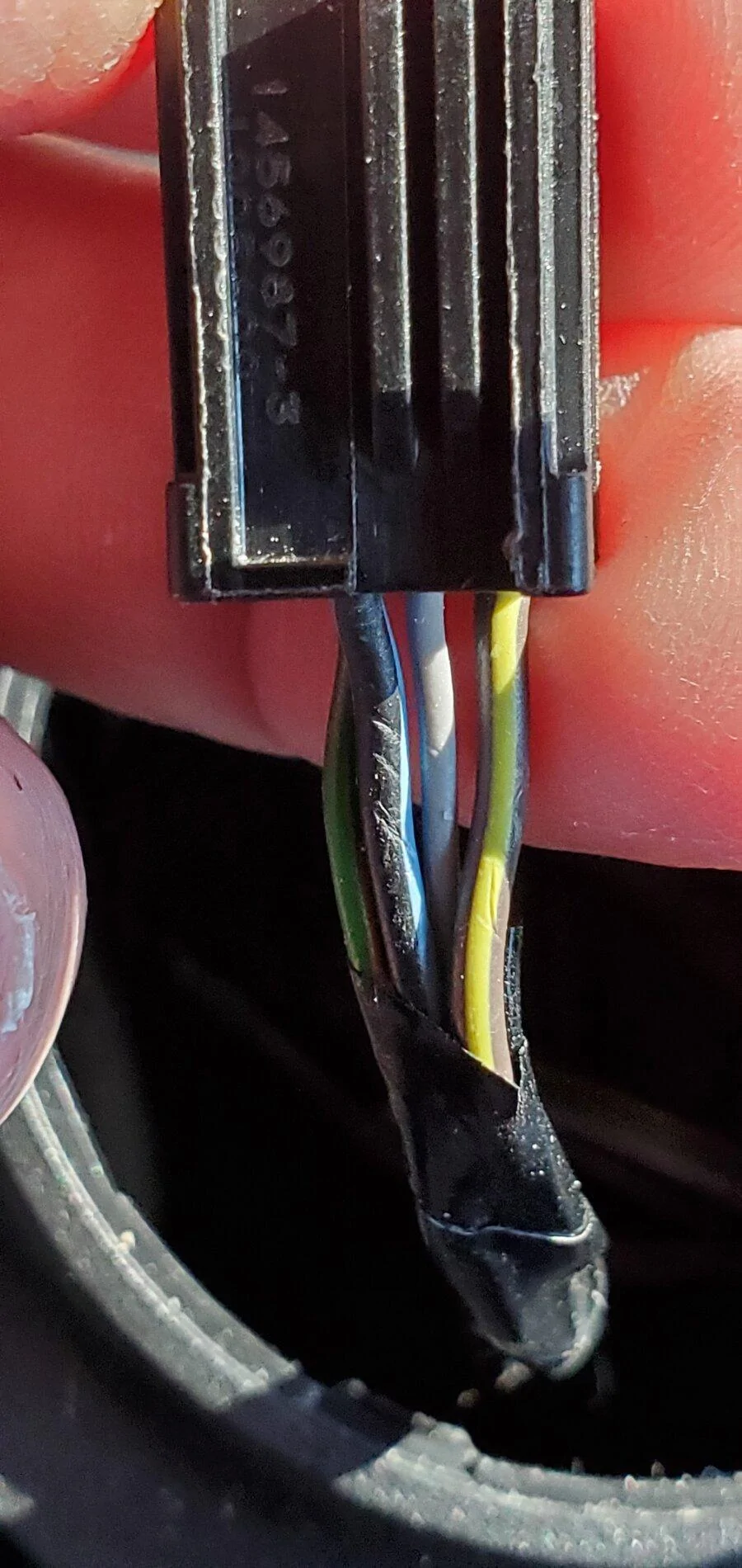

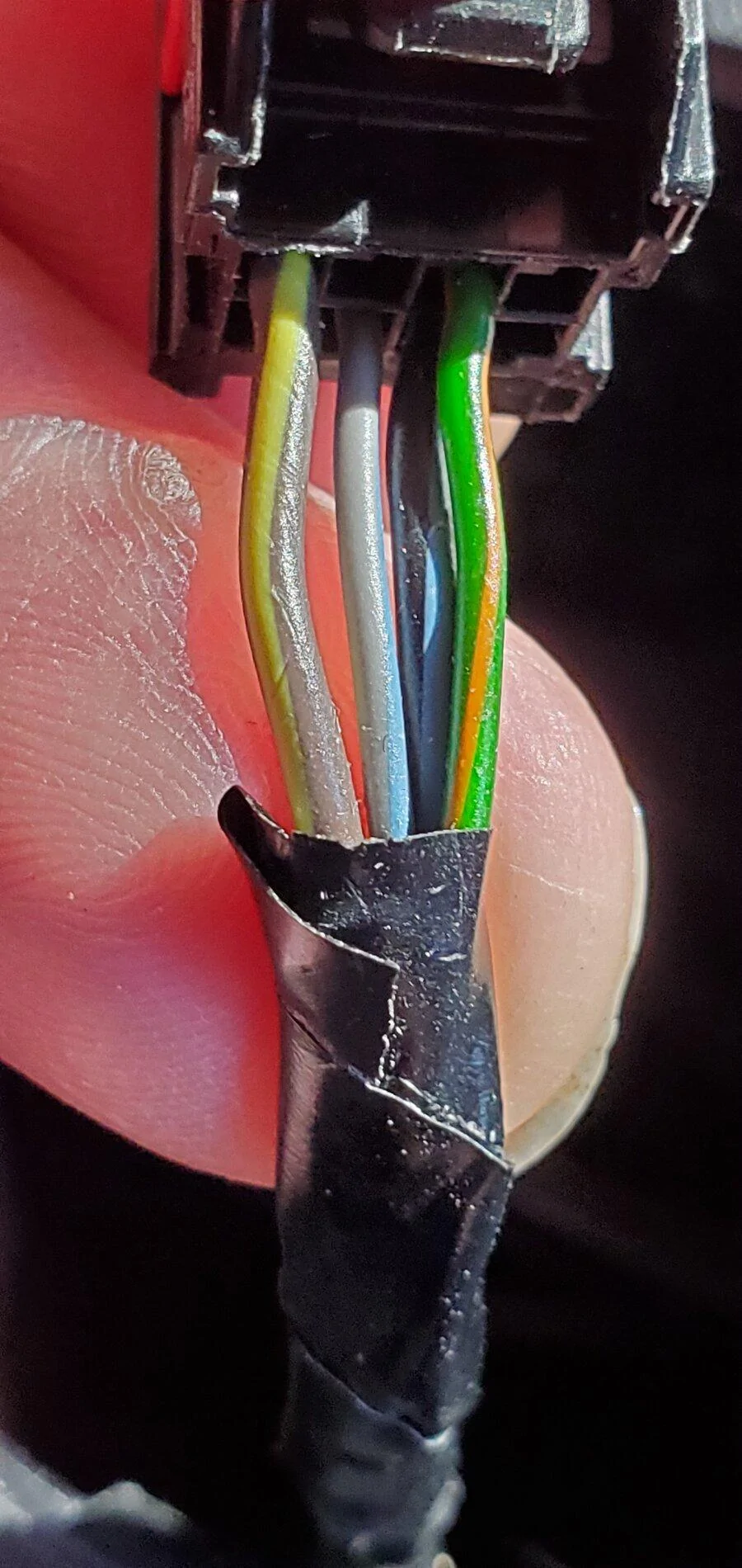

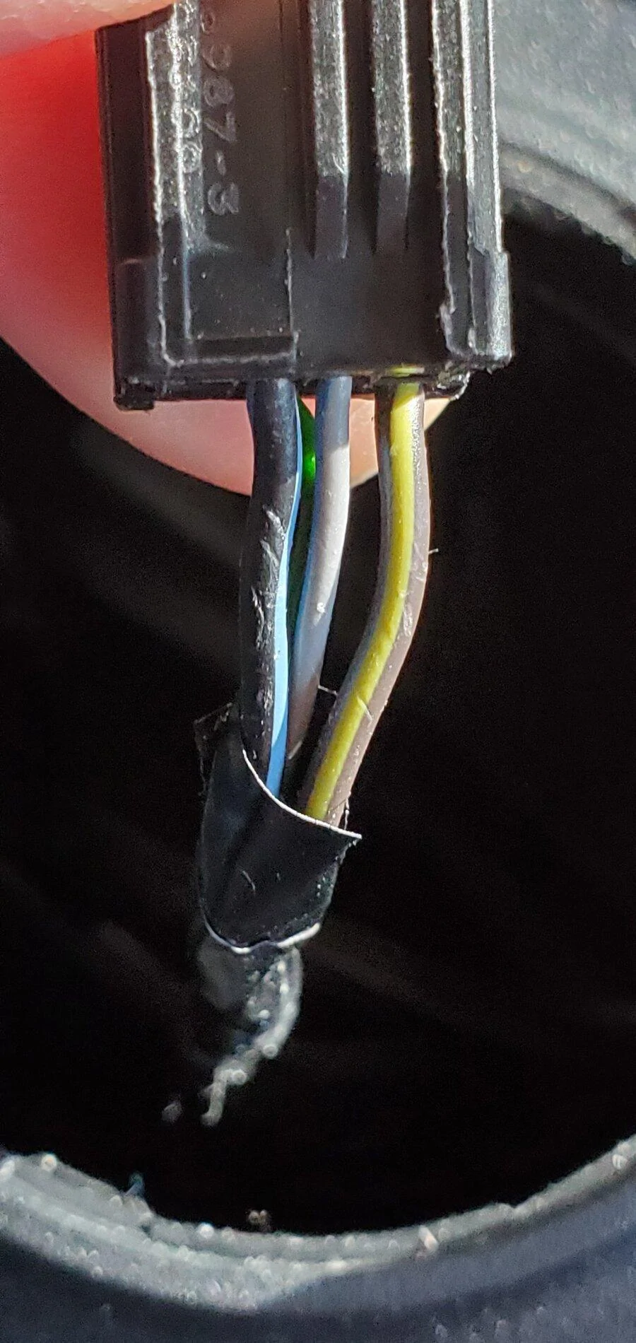

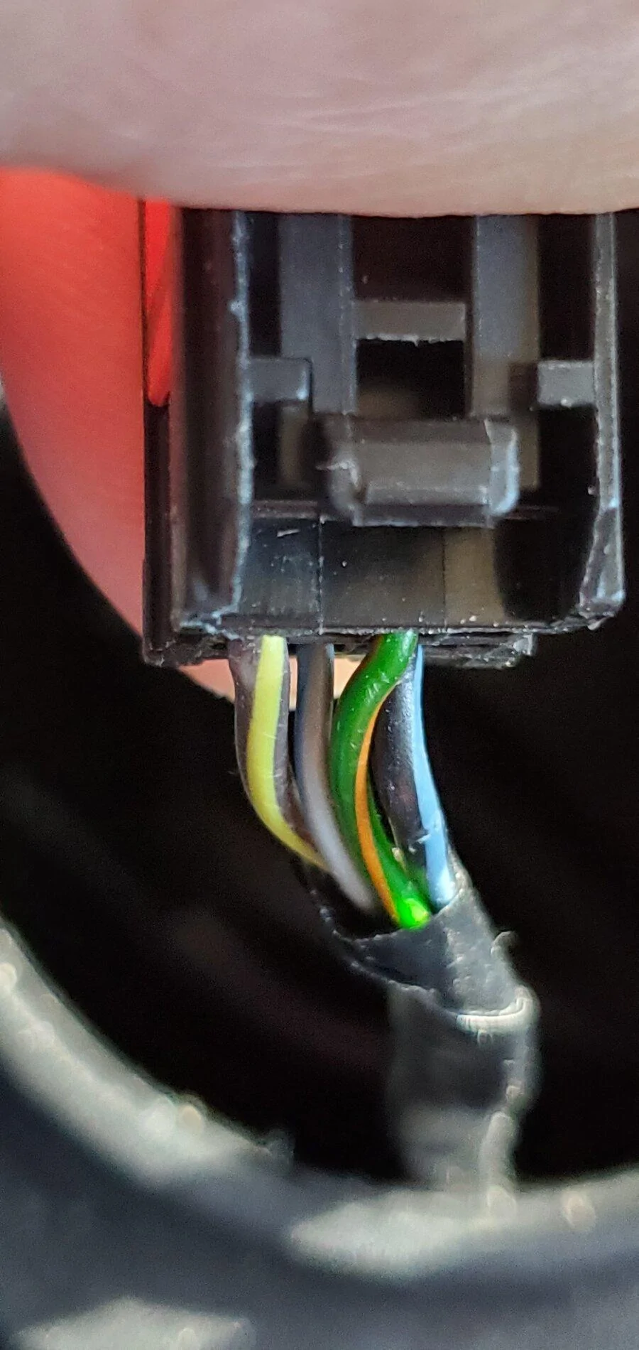

They appear to be the same wires at the same positions. Are there any other trouble codes reported by FORScan? I cannot find anything related to OU439:83-82.Can u tell if there is a difference.
I need a way to check the switch. For some reason it could have went bad on the TM side.They appear to be the same wires at the same positions. Are there any other trouble codes reported by FORScan? I cannot find anything related to OU439:83-82.

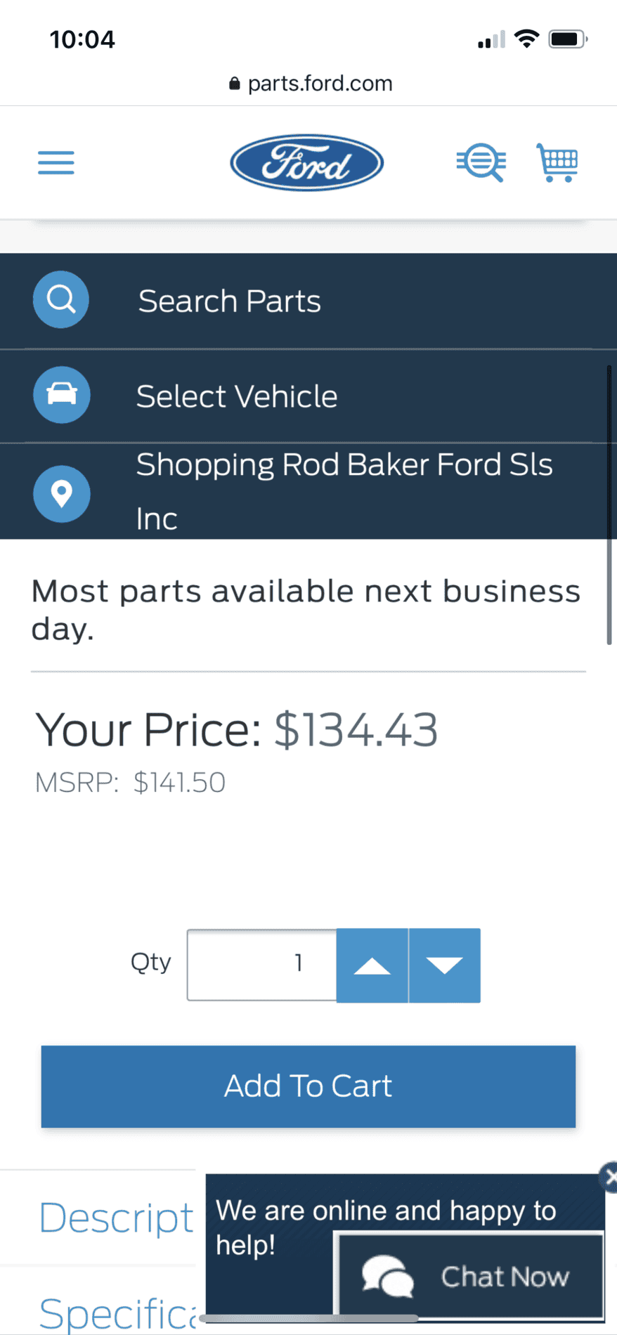

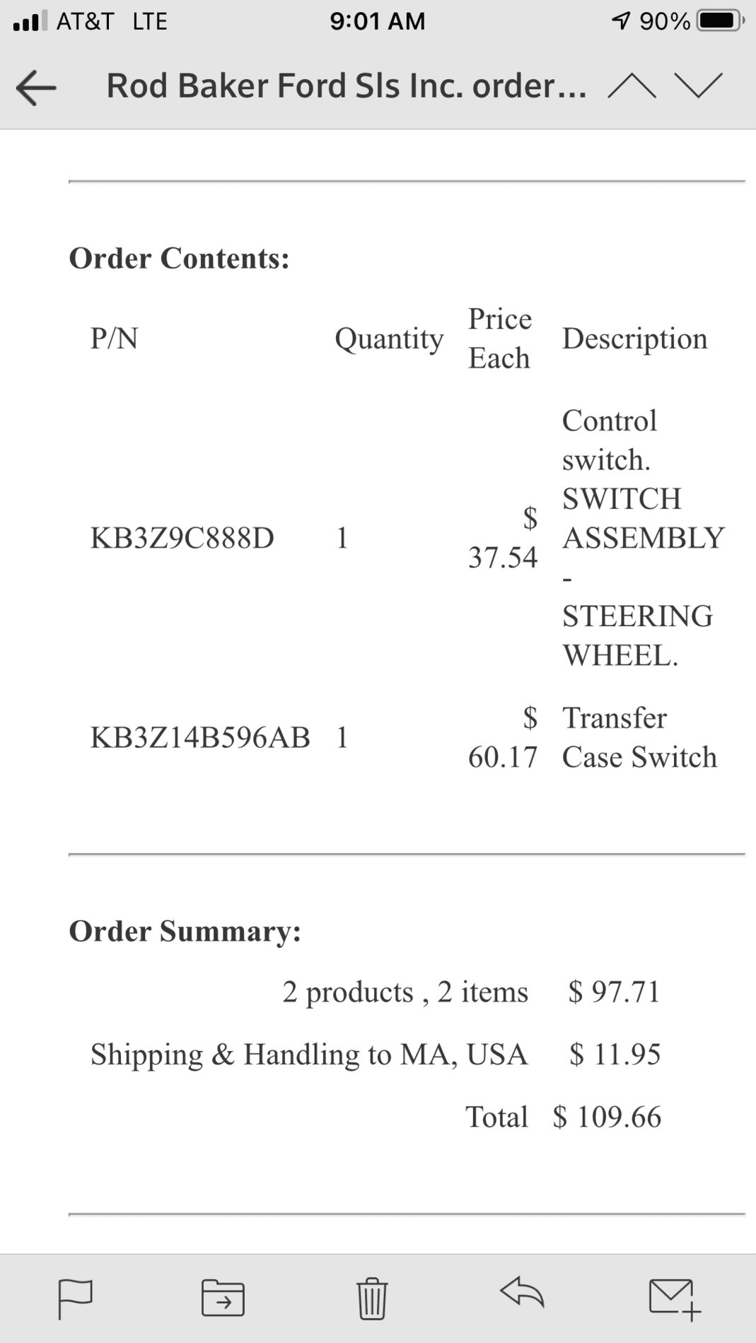

Try Rod Baker Ford 16101 S. Lincoln Hwy. Plainfield IL 60586It’s super frustrating to see the prices for the switch nearly doubled since this thread started. I should’ve pulled the trigger earlier as this mod for less than 60 was a steal. Nearing 100 I’m a lot less thrilled to fork over the cash. But more importantly I hate knowing I’m paying more for something than it’s worth.
Damn. Looks like they jacked up the price too.Try Rod Baker Ford 16101 S. Lincoln Hwy. Plainfield IL 60586
Just got mine delivered to my mailbox today!
