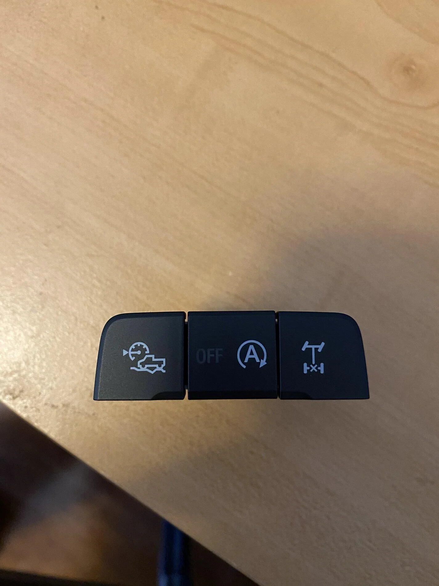

all of you posting how easy it was to add the terrain management switch weren't joking! I'm one of those that if it's something that can be messed up, I'm there! I also order the tc switch but I can't find where I can enable it, maybe I just looked in the wrong place? I've got a '19 XLT 4x4 (non-fx4). pics attached because sometimes I just can't explain what I'm trying to say lol

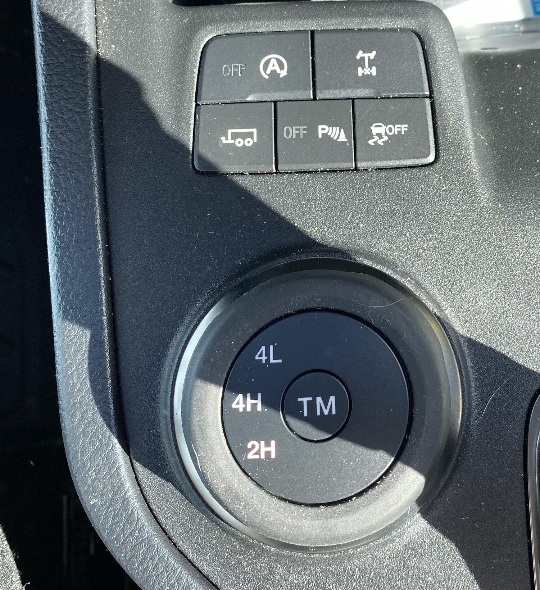

trail management knob and programming done today. 10 minutes tops. This is a pretty cool easy thing to do.

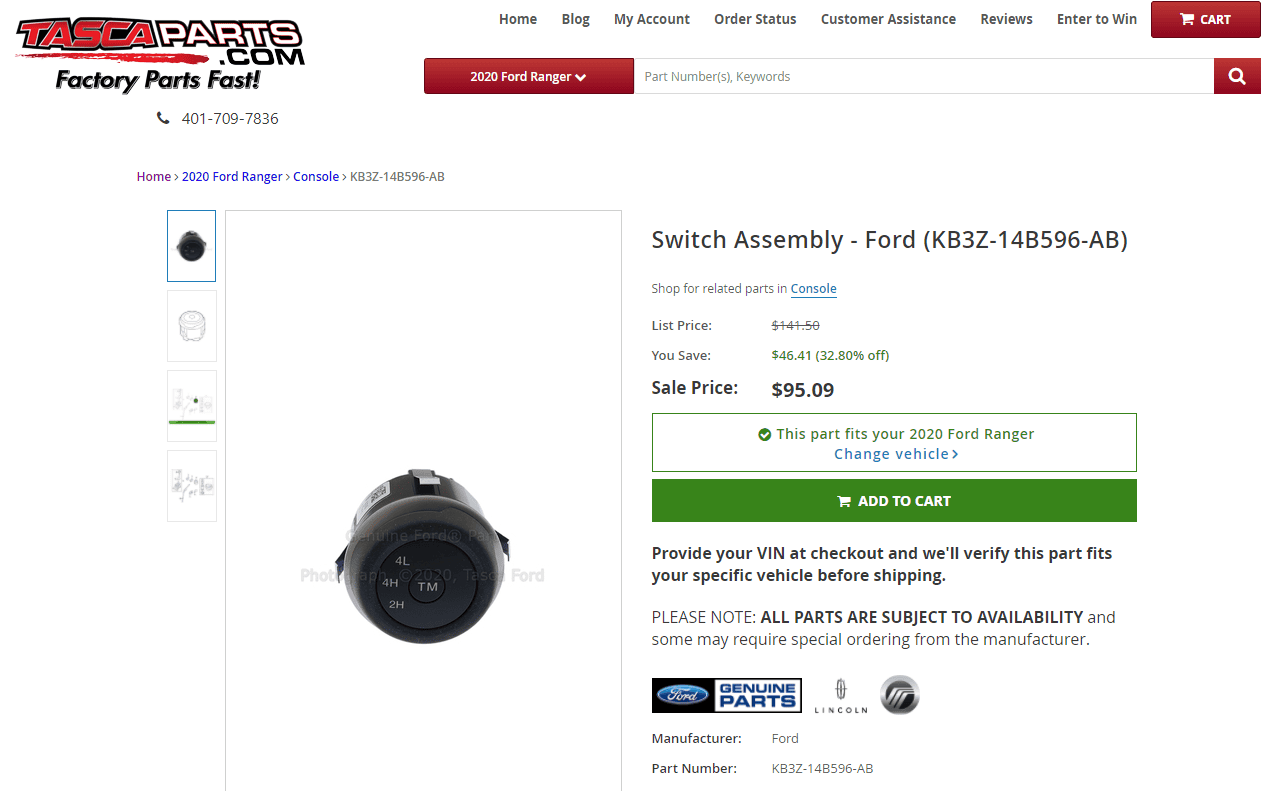

FYI, I tried to order the switch a couple of days ago. Just had my order cancelled by Tasca Parts saying that it's on national backorder. Also, the price has mysteriously shot up by about $40 since I ordered it.
From my order confirmation a few days ago:
And today:

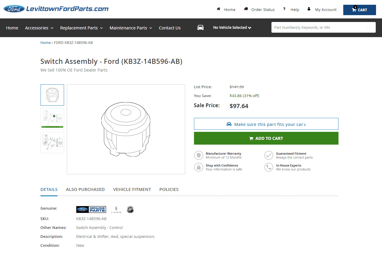

check Levittown Ford Parts. Got mine there for $56 plus shipping last week.

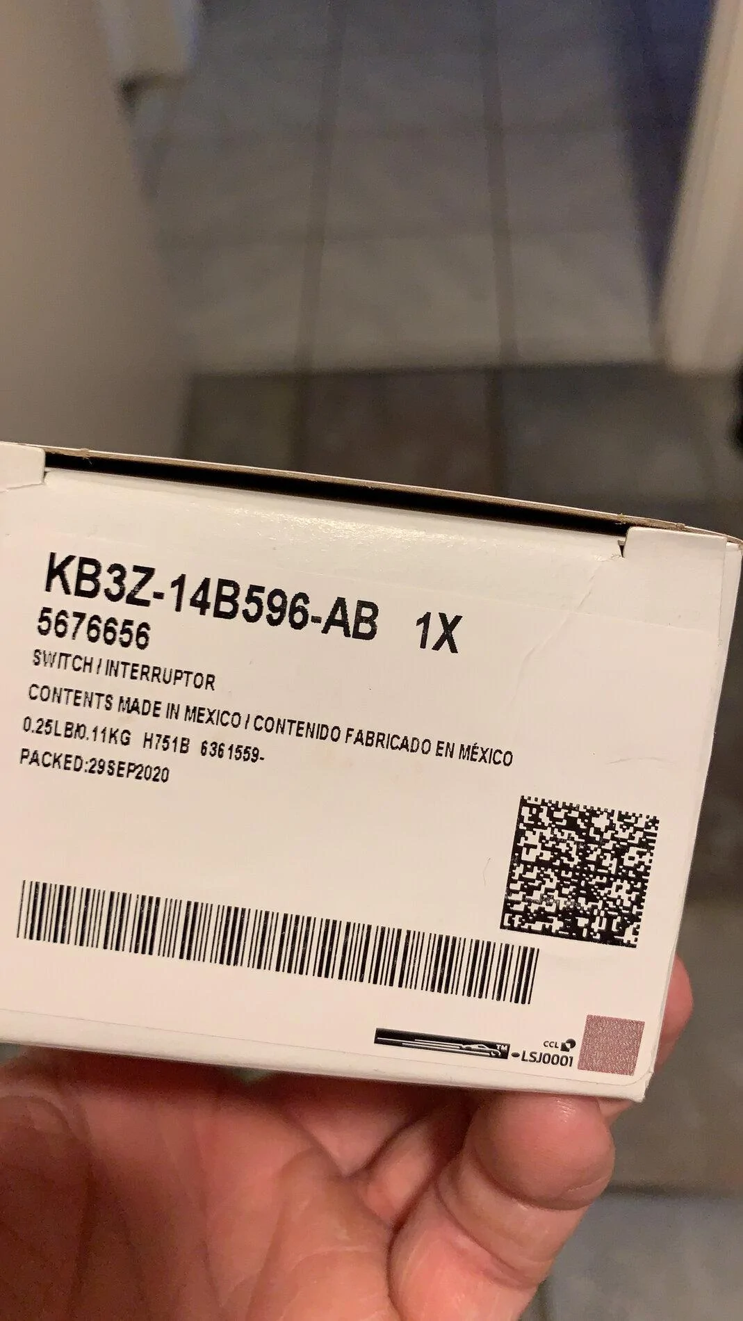

Dayum!! That sucks. I ordered mine from Varsity Ford on November 30th. Wonder if mine was the last one in stock nationwide....doubt it.

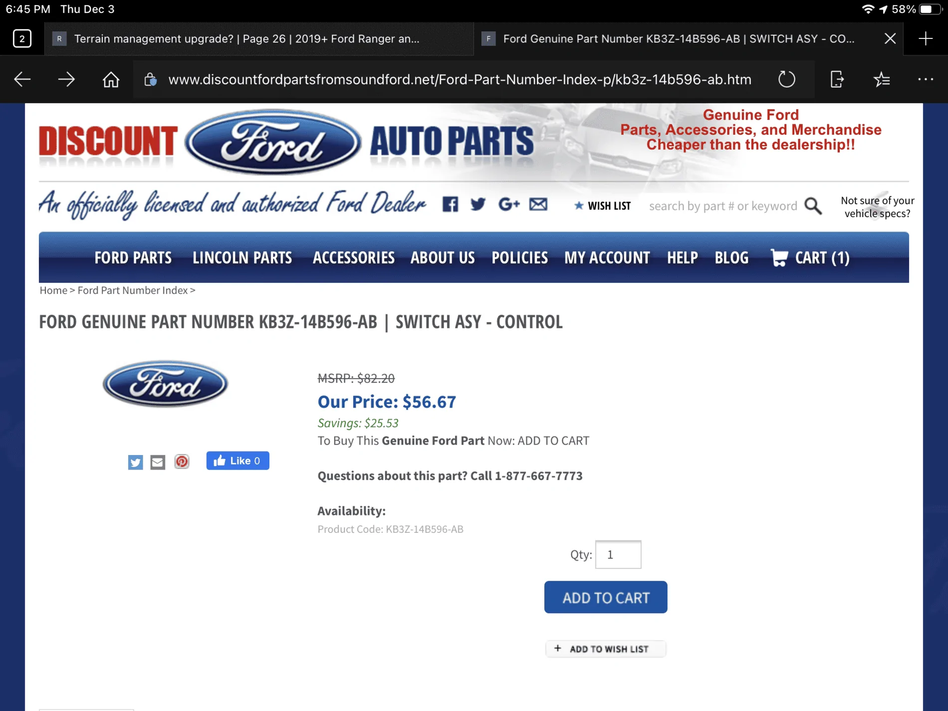

Wow looks like I got lucky. I got mine off oempartsource about a week ago for $56. Looks like the price jumped up right after. When I ordered, the part was backordered and came into stock within a week.

I ordered mine from Levittown back on Nov 16 for $56.72 + shipping, received it on Nov 20.
I originally tried to order from Tasca on Nov 11, it was about 5 days later they cancelled my order stating stating " Part #KB3Z-14B596-AB is currently on national backorder with the automotive manufacturer and has no estimated date of resupply. We do not currently have this item in stock at our warehouse and are unable to acquire it at this time."
