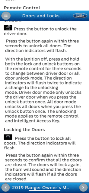

Just picked up my Ranger Lariat and and I press the lock button on the remote it locks up all the doors and the tailgate but when I press the unlock button it doesn't unlock the tailgate. Is this normal or it's a malfunction?
Mine locks and unlocks doors/tailgate w/ push of the button once for each. Check if you hit unlock twice if it unlocks the tailgate. Also check settings>vehicle>locks submenus

Tailgate unlock is 2 clicks of the Fob.
Mine unlocks w/ one click. I think it's because I have settings>vehicle>lock>fob unlock> set to all doors instead of just driver.

MIne unlocks w/ one click. I think it's because I have settings>vehicle>lock>fob unlock> set to all doors instead of just driver.
By default it should be 2 clicks for passenger doors/tailgate. I too have that setting enabled.

I found this quick tip to use the remote to switch between unlock driver door only and unlock all, including tailgate.
