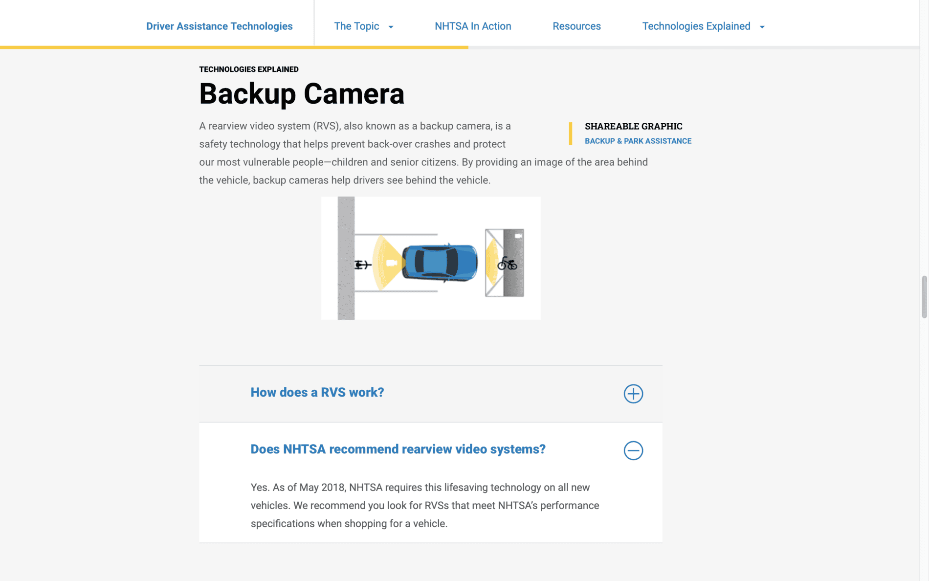

Then I'm surprised. As of 2018, rear cameras are required on all new vehicles-maybe pickups are exempt?
I might have answered my own question, but I'm not sure. Having nothing else to do this morning, I deep dove into the FMCSA's rather abstruse regulations:
Title 49 Codified Federal Reculations; § 571.111 Standard No. 111; Rear visibility. sub paragraph s6.2:
(b) Final requirements. Each multipurpose passenger vehicle, low-speed vehicle, truck, bus, and school bus with a GVWR of 4,536 kg (10,000 lb) or less manufactured on or after May 1, 2018, shall display a rearview image meeting the requirements of S6.2.1 through S6.2.7..."
Pages of stuff relating to the field of view, night visibility, resolution ad nauseum, but the normal people version is basically as long as you have rearview mirrors capable of reflecting their defined area, that's ok too, but maybe not.
