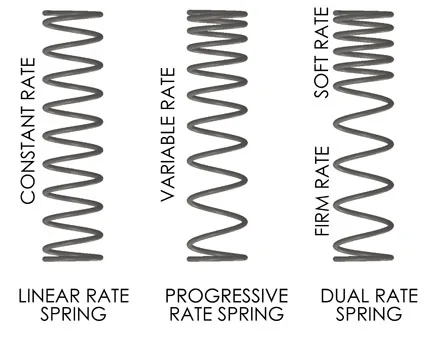

More coils will equate to softer ride and easier compression in general spring theory.
Not necessarily true. Depending on steel temper and diameter can definitely change things. My suspicion is one has less travel then the other in compression so it could possibly be slightly stiffer but also allow easier extension. That depends on valving too

" in general spring theory" I would suggest you look at variable rate coils like Metalcloak or Moog.
One won't have less travel because the springs do not limit travel in any engineered strut as this would induce coil bind and kick out or catastrophic failure.
