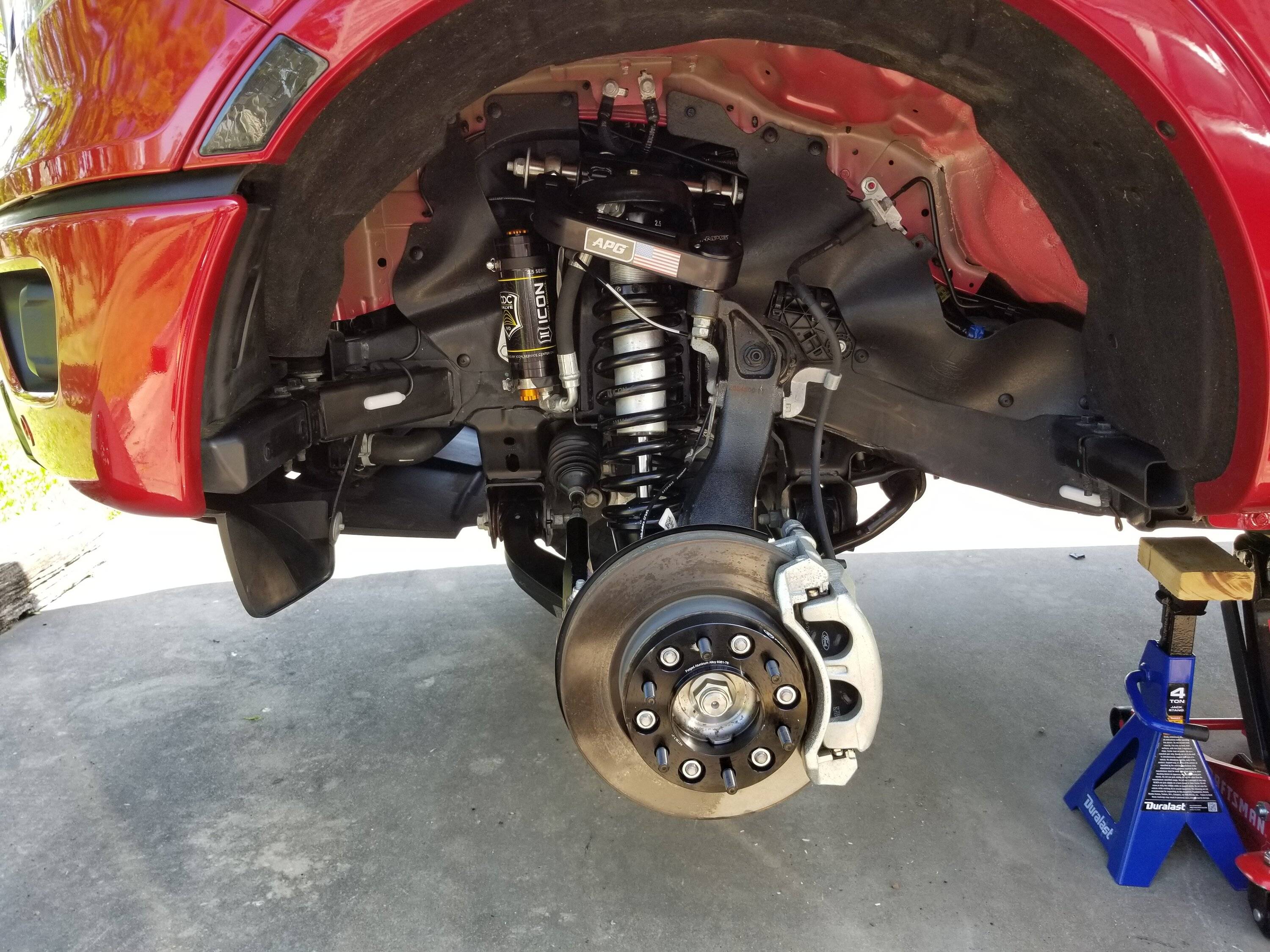

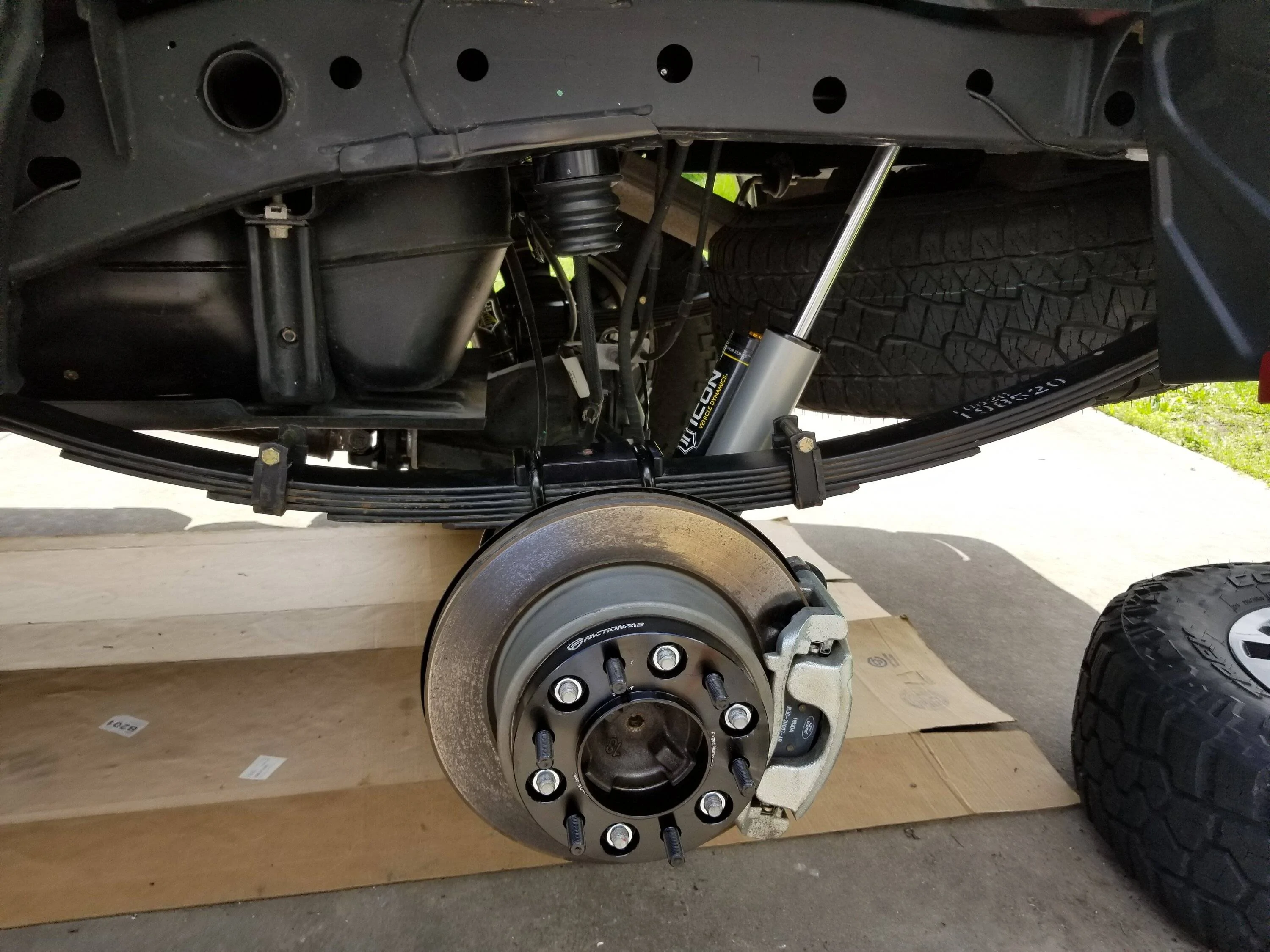

I have Fox 2.0, I will be going with Kings next go around. I had a set on my old tundra and they were awesome in all conditions.
If you are not building on a budget and "closest to a Raptor" is your criteria......
The APG , King ,and Deaver , Long travel , Performance Matched , front and rear system, is about as close you'll get with a bolt on made for 5G Rangers kit....$$$$...
A good system for driving fast on bumpy dirt roads is what I have now. APG , Icon Ext travel 2.5 adjustable dampening valve, front and rear with the ICON leaf pack.......
