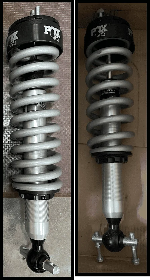

Are you referring to the Fox 2.0 or the “Tuned by Ford” Fox 2.0? Please correct me if I am wrong, as I believe that I’ve seen that the two systems have different spring rates.
Ford Fox 2.0 has more coils.
That's a good point. Wouldn't know which was firmer personally but maybe someone can weigh in. Happy to edit the list and add it in.

It would depend on the spring rates on the shock. Most companies go vehicle weight, unsprung weight and travel in order to calculate the "quote on quote" best spring rate
