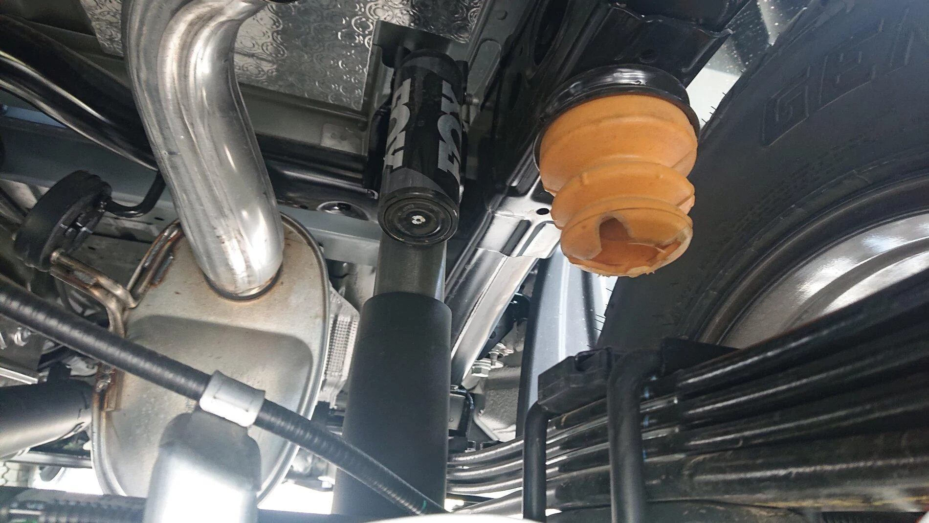

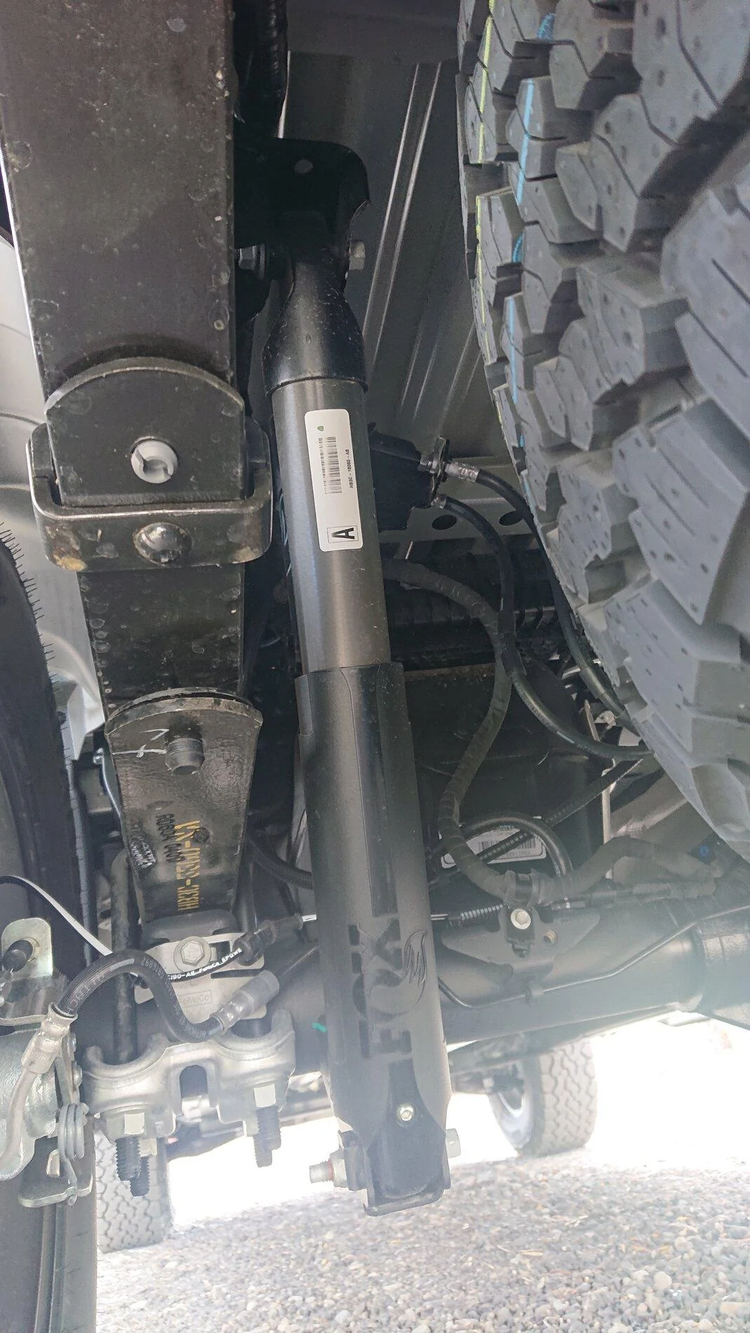

Seems to be knowledgeable suspension talk going on here, so I wanna ask here. Got a 21 tremor which comes with fox shocks of some sorts, I want to level the front, but don't want to stiffen the ride any or mess up the handling. What components should I be looking at, don't think spacers is the right way to go. Thanks!
Superdannyboy
Jan 1, 2020
1,099
1,371
75209
Can you post a picture I'm curious to see them. I've read that the new coils add a 20mm lift to the truck and that there are remote reservoirs.

There is reservoirs on the rear shocks but nothing on the front. As far as the front being lifted a bit more than the others Maybe but there's still about a two and a half inch difference between the front and rear of the truck.

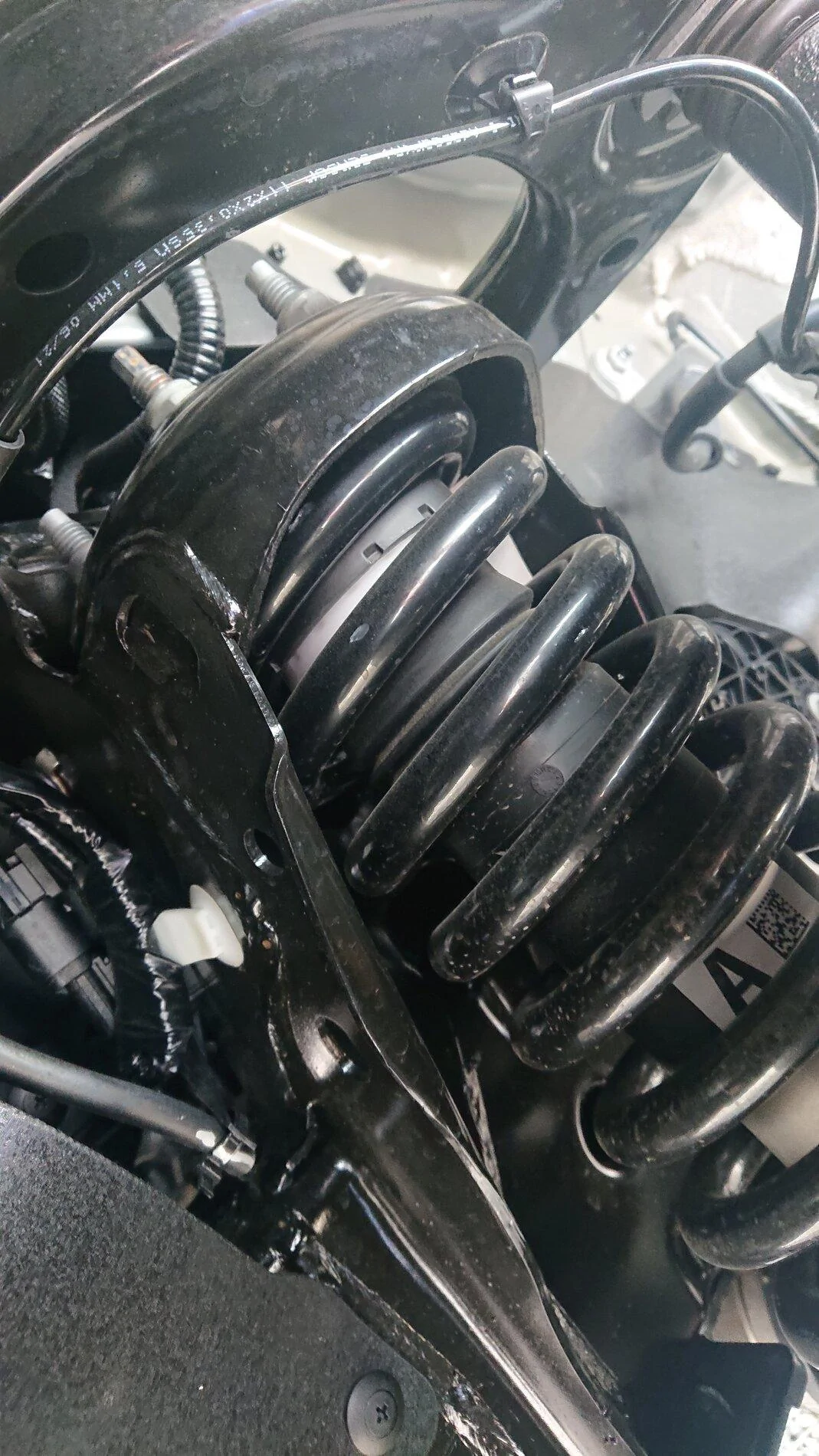

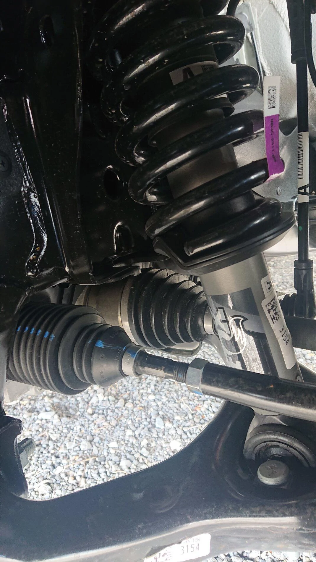

After seeing the Tremor front shocks it doesn’t look like it has an adjustment collar. Is there clip grooves for changing the length of the spring compression? If that’s what it is ??‍♂
No, the tremor doesn't have adjustable shocks. From what I have read and can see.
