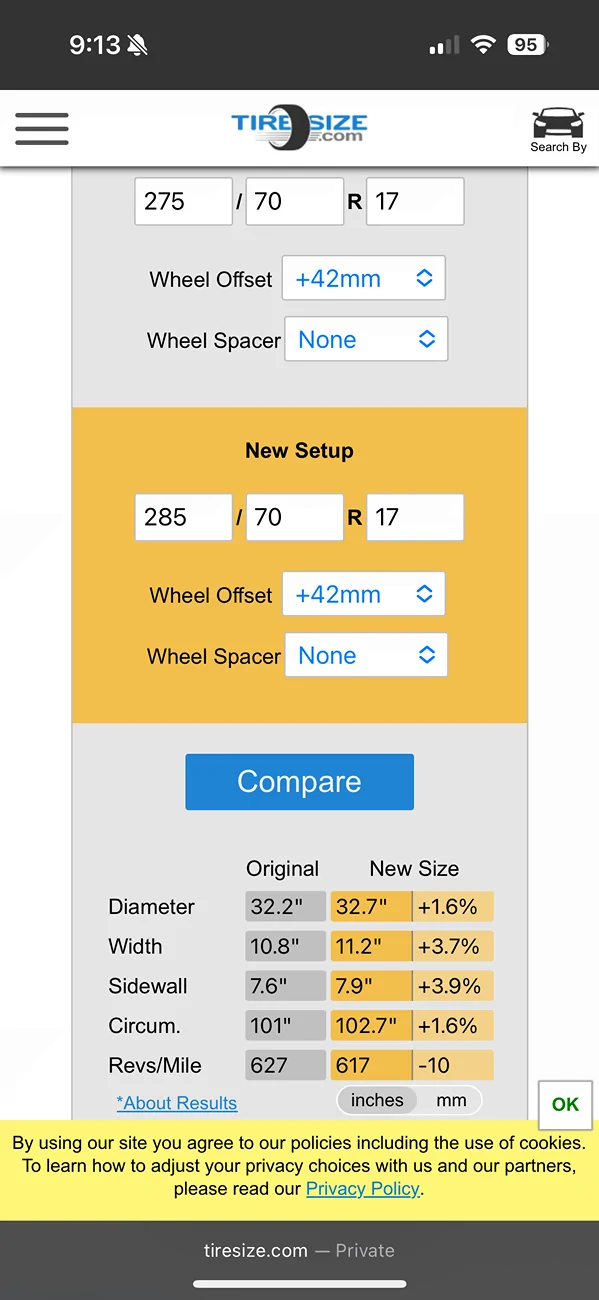

+ 1 for the answer fitzmotor gave.
The oem tremor wheels are 17x8 with +42 offset (this is slightly different from the Ranger sport oem wheel offset of +55.. I’m unsure of the oem sport wheel width.)
275/70r17 is the “safe” largest tire with zero modifications..
Changing the intrusion bars/crash bars…
You’ll have a slight rub with 285/70r17’s
When the suspension compresses during a turn.. or the usual slight rub when reversing on less than smooth-ish surfaces..
When I was researching this that’s what I came up with based on.
Most to fit 285’s with as little lift as possible. Seem to do a 2” lift puck (from a stock ranger) ((this is a 1” to 3/4in increase over the Tremor specific stock height.)) and then because of the offset will run a spacer (1” wheel spacer pushes the offset to a +29.6mm) this is to provide clearance so the added width of the tire doesn’t rub against the control arm or steering knuckle/spindle, remove or use high clearance intrusion beams/crash bars..
And will still have on occasion ((our trucks do vary ever so slightly as well as our driving styles)) a slight rub during certain maneuvers..
275 vs 285 /70r17 difference is only really about a half inch (this will vary a bit depending on tire manufacturer and type ((M/T vs A/T vs R/T))..
275/70r17’s aren’t super easy to find..it’ll be a better fit.
285/70r17’s plentiful, you may have to deal with a very slight occasional rub on things no one really looks at anyway.
overall either size will look good..

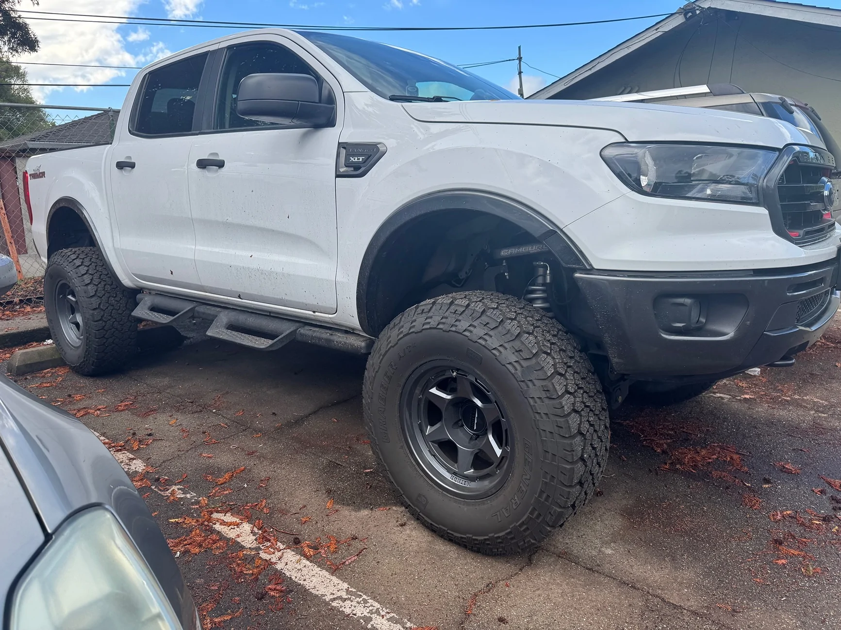

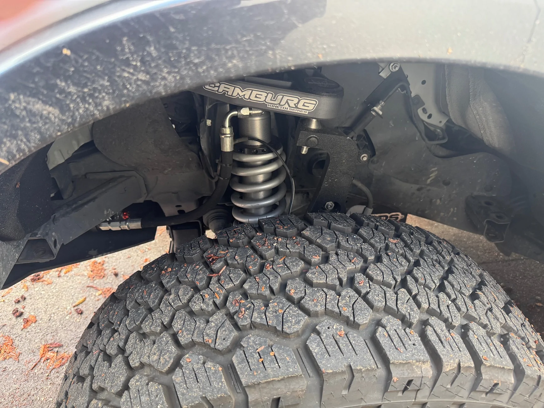

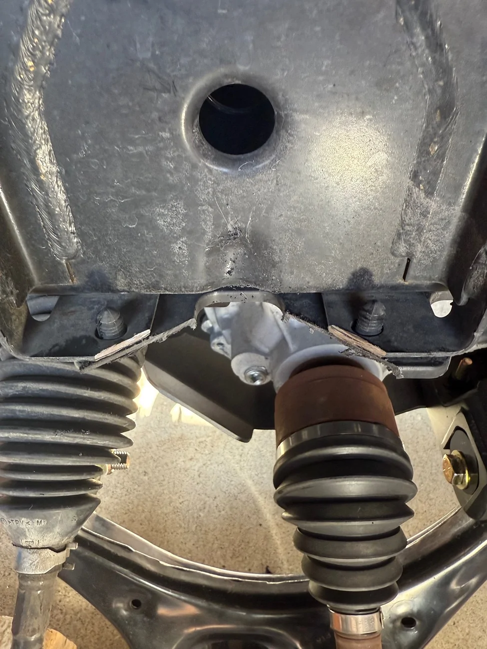

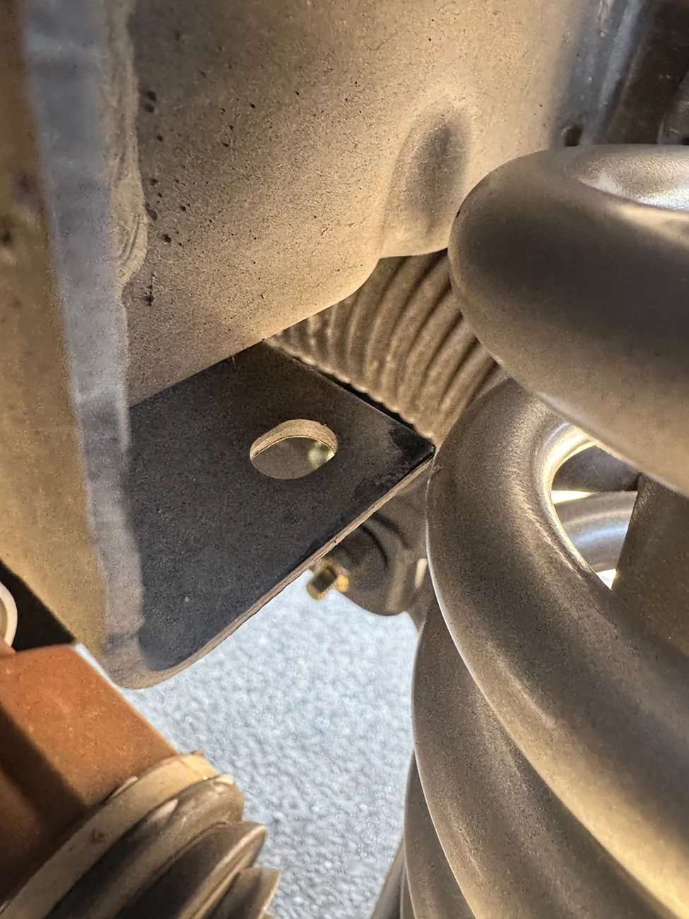

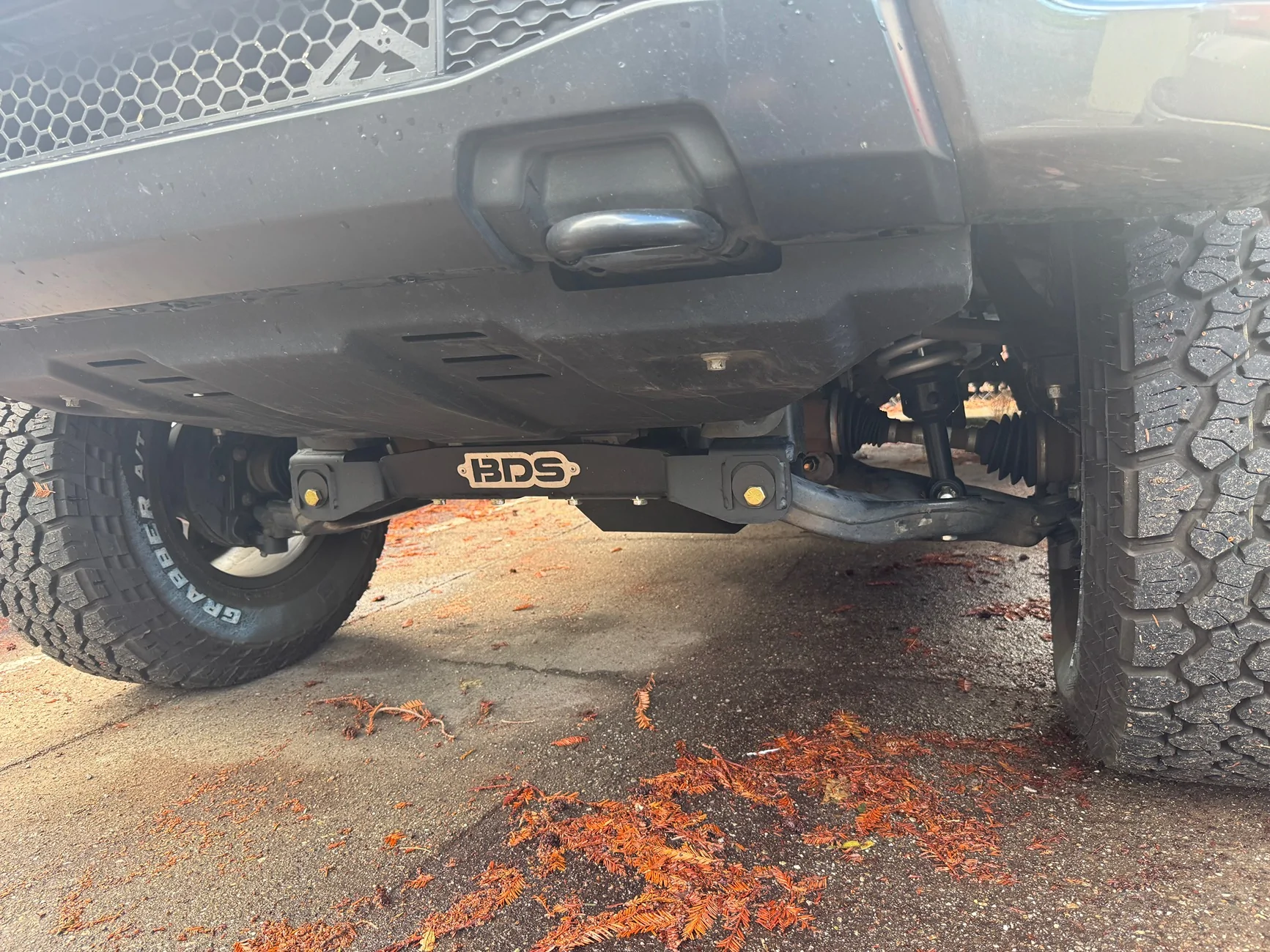

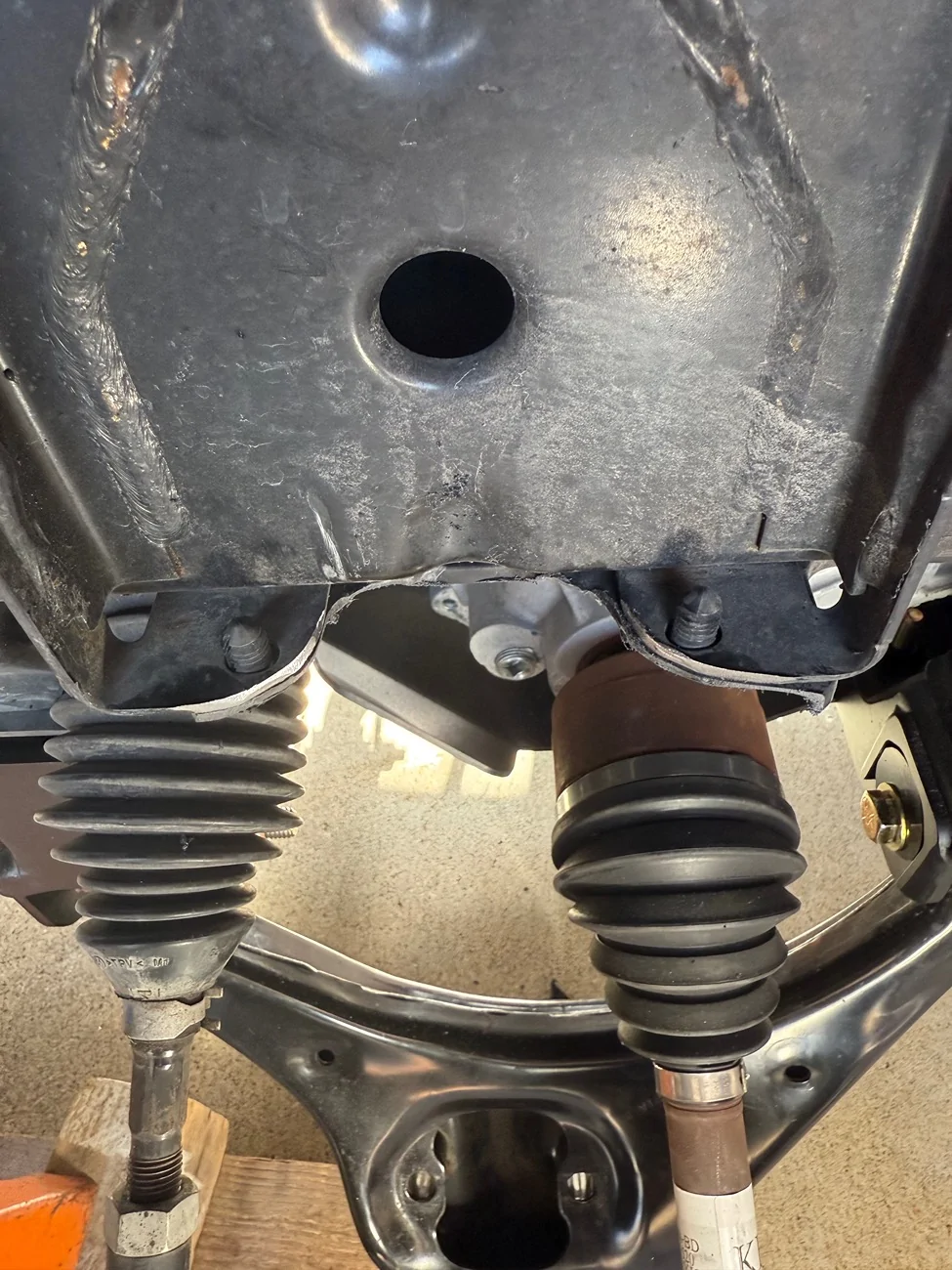

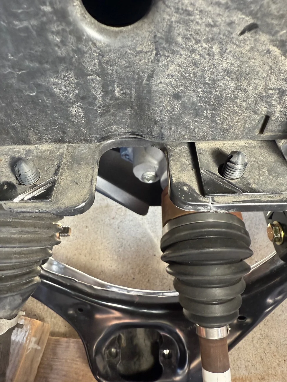

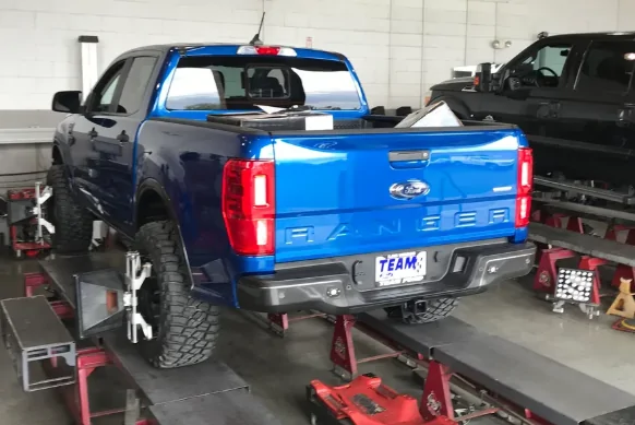

Of course.. short answer is
Bds 6” lift kit
Method 17x8.5 -38 offset
General grabber 315/70r17
Camburg kinetic UCA’s (absolutely not needed specifically just I like them so very much.. much less expensive options out there for the UCA’s)
So the starting point obviously expect to buy the wheels tires and lift at the same time if you go this route and currently have the oem wheels… (oem wheels are NOT compatible.)
BDS 6” lift (fox2.5 front extended coil overs, fox 2.0 rear shocks. (These come with the kit))
https://bds-suspension.com/products/6-inch-lift-kit-fox-2-5-coil-over-ford-ranger-19-23-4wd
Method wheels. 17x8.5 -38 offset.. (in your case running the 20x9’s you’ll be able to run a more inboard offset likely a zero (the 20” wheels clear the tie rod ends for the steering which having 17” wheels is why I had to push so far out to clear them, and going with 33x12.5 you’ll likely have a easier time clearing..(I still have a very slight rub at full lock in revrse.)
Tires are General Grabbers 315/70r17..
I like small wheel big tire.
basically the kit is pretty complete. There will be some trimming and cutting…
With 33” tires I’d expect about one inch less clearance reading on the tape measure on the lowest points that I pictured.

@OGMix376, has himself a streetable mini monster truck lol!😁
OGMix376
Bryan
Jun 30, 2024
1,033
3,530
Almost 😅.. the legal limit for the ford ranger is like 30” to the frame of the truck..
To the frame of the truck I still have like 6”-7” higher… leaf pack in the rear, longer bolts, line extensions for all the rear end stuff..(so that’ll be a few custom brackets aswell since they are already getting tight under some extreme droop and such).
In the front It could probably be as easy as adding some 2” lift spacers... and then I might be able to put 37x13.5’s (or whatever).. 😆 I’d then be right at the Cali legal limit for the Rangers GVWR legal maximum lift…
but you nailed it I wanted mini monster truck..

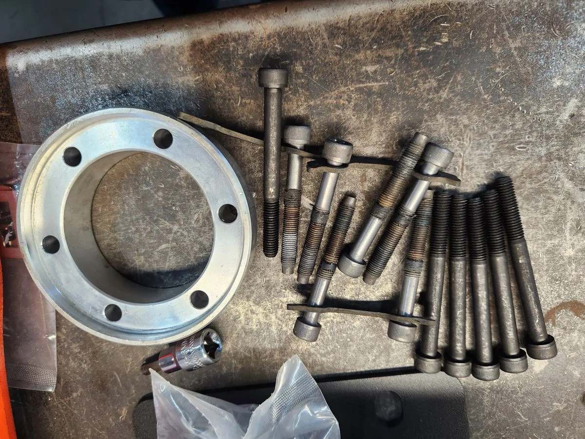

Yes it was a 2023 Ranger Tremor.

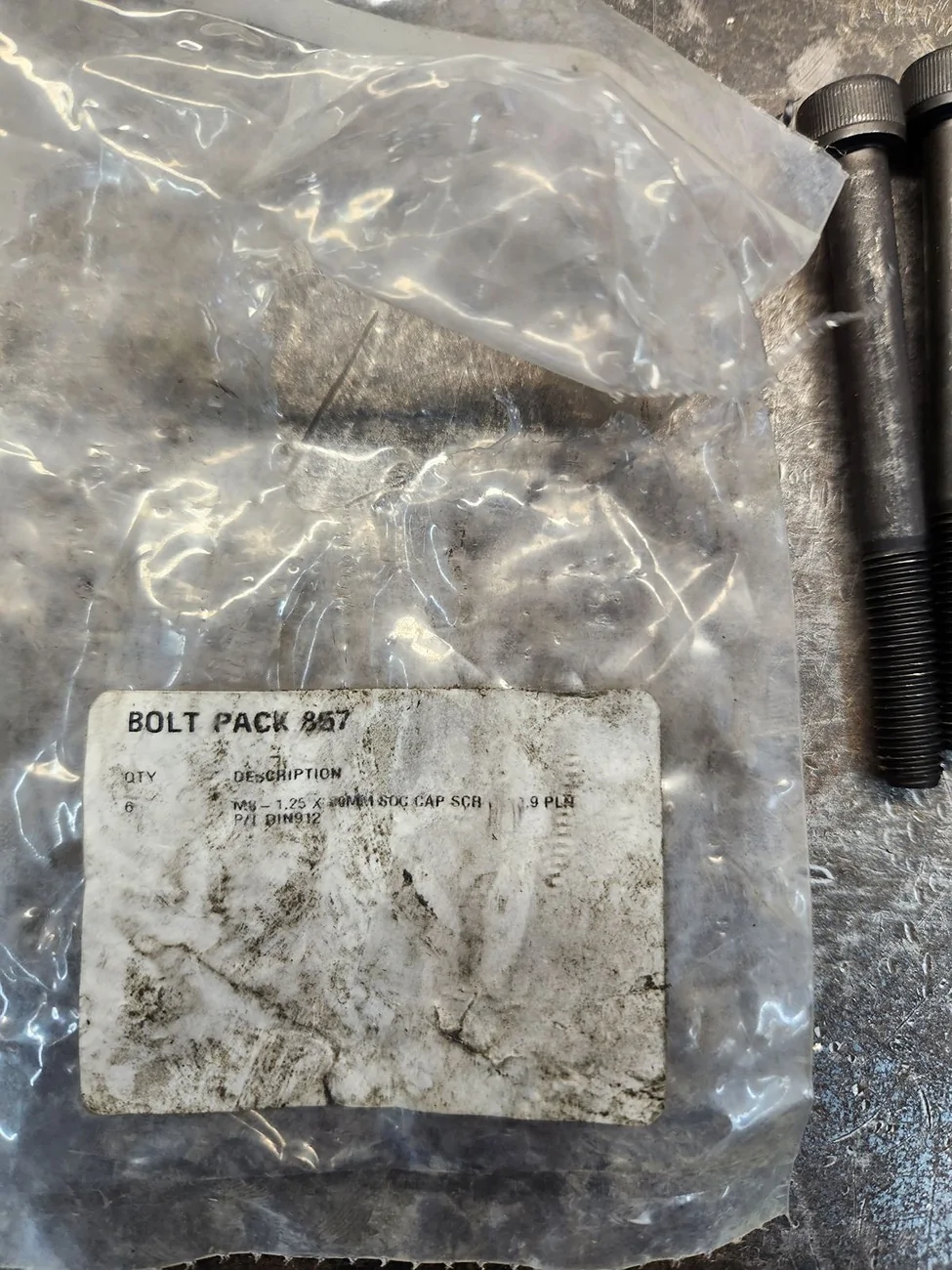

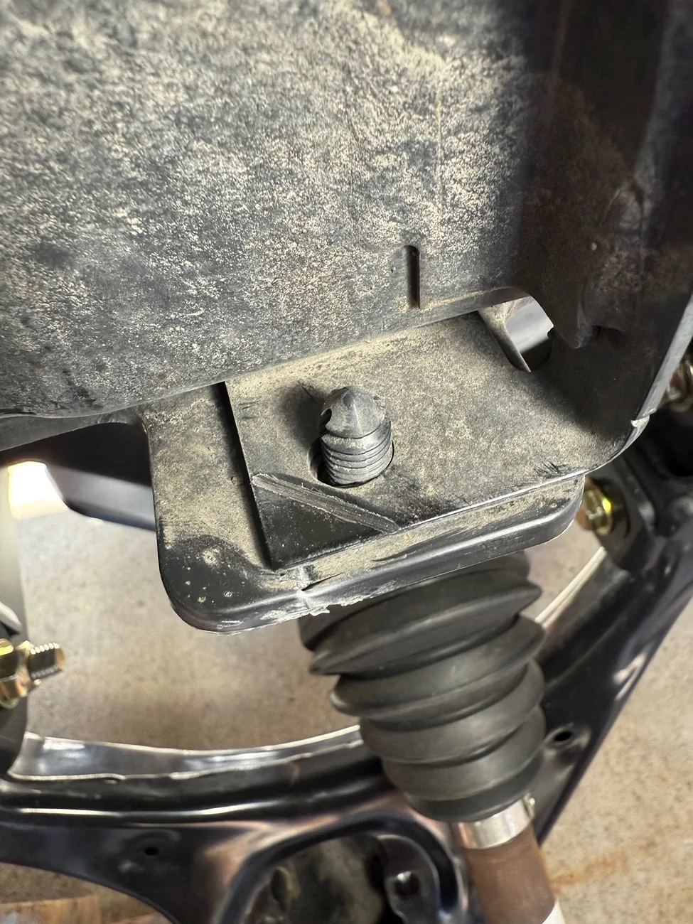

Everything pretty much falls inline.. the only issue was they sent the incorrect bolt pack originally.. these ones
Was the only real hang up…
After a couple quick emails to BDS Techs.
It was remedied within a 14 days.
The UCA’s aren’t needed.. you can get stock ones or go after market..(mind that most aftermarket UCA’s are usually made with 1” minimum increased lift so the “T” as I call it will be slightly Leaned out.
I plan to go with a 1.5” or 2” spacer on top.. which will push the cv’s out of spec again as if you did a 2” spacer lift..
In the rear I have a bit more to figure out.
The next set of tires mark my words will be 37’s😬..
Suspension wise tremors are basically the same as a fx4 that had Fox shock swap..(better leaf pack wheels and tires aswell).
The driverside gas tank sag spacer has a bit of a issue with the detent thingy needing a bit of checking out so the it won’t slip out.. (have to extend the pin on the tank sag spacer and drill a hole into the bottom of the 4” spacer provided by BDS simple enough). But pretty much if it fits a 5 g ranger it’ll fit the tremor. A couple areas of concern (if you go 6”… your case maybe just go 3.5” BDS Fox 2.5 four corners much simpler.. but not as balls to the wall. And it comes with a diff drop/angle kit and UCA’s… since the 3.5” lift doesn’t come with a cross member and spindles/knuckles)..
All in all BDS to me is well worth the extra money.

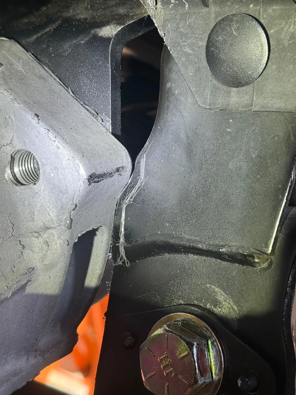

The front diff contact on the rear front subframe mount..
Highly recommended to have a good set of second hands to help.. ..

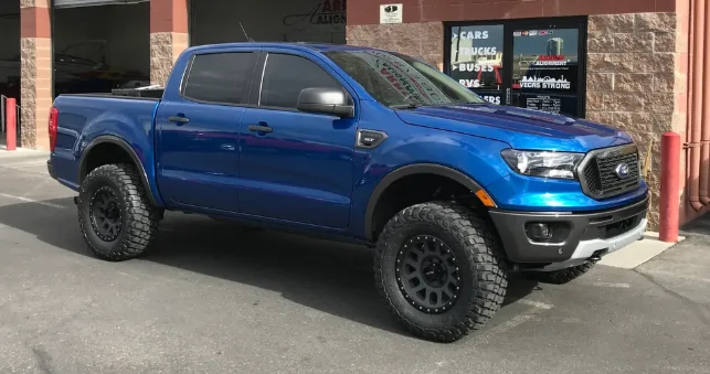

Oh, and my choice to run 20" wheels (I think) leaves just enough sidewall for 33s (a saw and maybe even the minimum), but pairing w/ 35s, the vibe would be: "it'd be whole lot cooler if ya did"
I'm not into the lo-pro look that i swear I've seen on some street-only superduties... omg they must be 26" wheels! Even if there is sidewall, it's the ratio of wheel to sidewall that exaggerates the look!
I'm borrowing from someone who used the Ford Ranger Lifts, but I really like it, AND it tells me those Roush flares should be pretty perfect! LOOK AT THAT; calling for mr Roush
I TRULY APOLOGIZE TO WHOEVER'S TRUCK THIS IS.. BUT IT'S 100% COMPLIMENT ON 33X12.5 W/ 2" Ford RangerLift on Tremor
