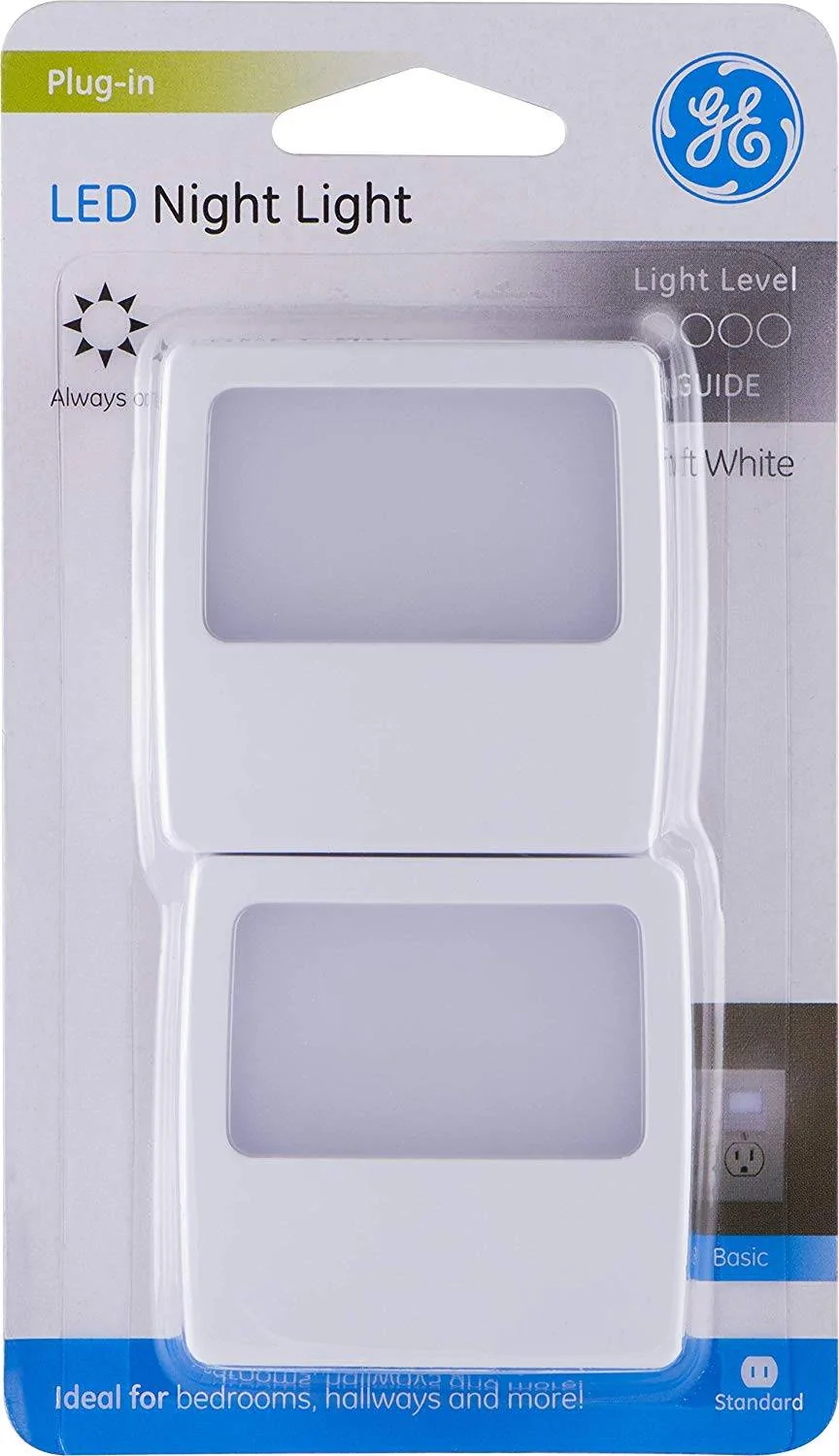

Someone on here suggested plugging something into the 110 outlet in the rear of the console, I plugged in a charger for my Dewalt battery, It worked! didn't even have to have a battery in it, the truck no longer shuts off at every traffic light, so annoying when driving in town. Thanks to who ever suggested this.

Just plus in a cheap LED nightlight and it'll disable it. Been doing that for over 2 years now and no more A/S/S.

That post was from 2 years ago. Solutions have been found since then. FORScan is the best solution for it. Don't have to buy anything. And there is no need to plug something in your vehicles; having it take up a outlet and possibly break/short and starting a fire. Not worth the risk of it shorting.

Forscan still cost money to buy the ODB reader and the A/S/S Eliminator is $100. The cheapest and easiest way is just plug something cheap like a LED $3 nightlight into it and be done with it. The outlet goes dead after 20 minutes so there's slim chance of anything catching on fire. ?
